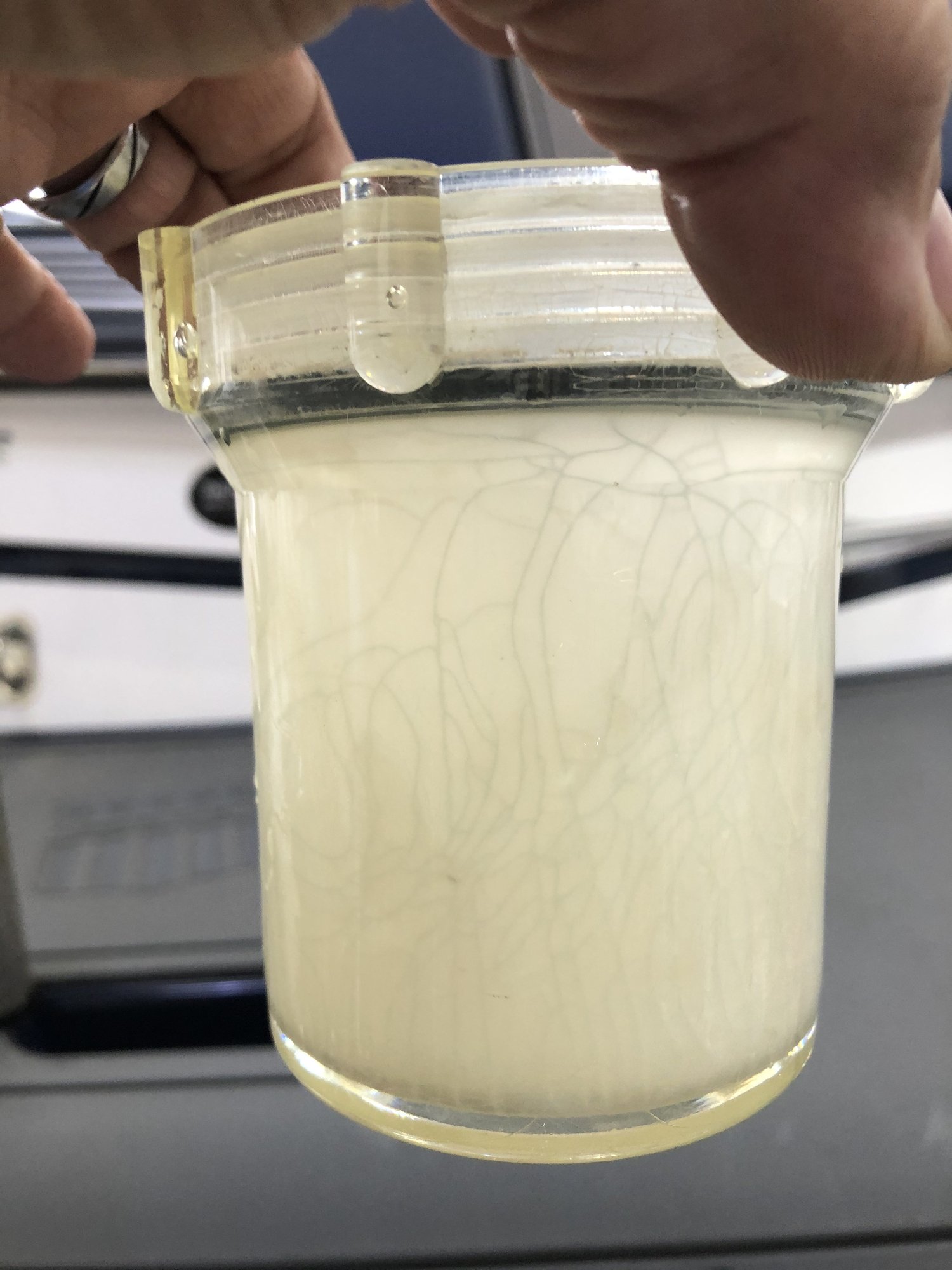

This is an example why you never use alcohol based antifreeze in marine applications.  Aka RV antifreeze, the cheap stuff.   This is a sea water strainer that is stressed cracked , just waiting to collapse and fall apart     Many of these are under the water line and can create a huge leak

    Interesting on all the cracks! Ive heard that pretty much any anti freeze will turn those plastic bowls gray, but the cracks from alcohol are something else.

    We see this often from owners who perform their own winterizing.   I normally see these in the spring but thought I would share this one we found this fall to alert others

    I've seen those sea water strainer that is stressed cracked. And had them crumble in my hand removing them. But never Knew the cause. Thanks
  • Pat310Pat310 Port Washington Long Island NYMember Posts: 331 ✭✭✭
    Exactly what mine looked like when I got the boat. Figures it was cheap antifreeze. Seems everything PO did was as cheap as possible. Replaced them all. Thanks @Alswagg   great tip

    Because this is the first I’ve heard from this. Is the alcohol based RV antifreeze causing because of the alcohol, or is it freezing and cracking it?
  • AlswaggAlswagg Member Posts: 2,964 ✭✭✭✭✭
    The alcohol attacks the plastic bowls.   It say directly on the bowls, Do not use with alcohol. This is so common with DIY boaters.   Why use the cheap stuff?   A boat is a huge investment

    So I've just assumed that the RV/Marine -50  antifreeze that I've used for years for less than $3/gal was alcohol free as the ingredients are usually ethylene/glycol or propylene glycol and the bottle always says safe for plastics, metals and rubbers. Most of the cheap stuff, which I've used yearly for a decade, is ethylene or ethyl glycol which is ethanol. I just read the safety data sheet for the $2.70/gal menards stuff I bought and it is ethanol based.  All good right? Nope. Here is the thing -  ethylene/ethanol is alcohol so I have been using alcohol for a decade and most likely most of you have also.
    When I bought my 342 the a/c bowl was gray like Al's pic, not crazed, but gray and my dad told me that was from antifreeze, so I bought a new clear one and every year after haul out I would dump the pink stuff out and wipe it dry. With no antifreeze in it all winter, it stayed nice and clear for years.
    From what I can see, these cheap ethylene/ethanol (alcohol) antifreezes will not harm the more common plastics used on our boats which is polyethylene and polypropylene. All of those red and blue water lines and their fittings are polyethylene. But those clear bowls are most likely acrylic since they are clear and indeed alcohol will damage acrylic quickly.
    Al is right, for another $3 per gallon you might as well use the alcohol free stuff and be safe, from what I can see the cheapest alcohol free option is West Marine's -50 engine antifreeze for $6.50 a gallon. West's water system antifreeze for $4.50/gal does have alcohol in it as does most of the antifreezes I can find for under $5/gal. Menards has a $4/gal alcohol free pool antifreeze but good luck finding it in stock.
    I blow out all of my water lines with air and I only use the pink for a/c units, sink drains, sump tank, and the holding tank, so I will probably still use the Menards ethanol based product that I bought, but my strainers are glass and not acrylic.
