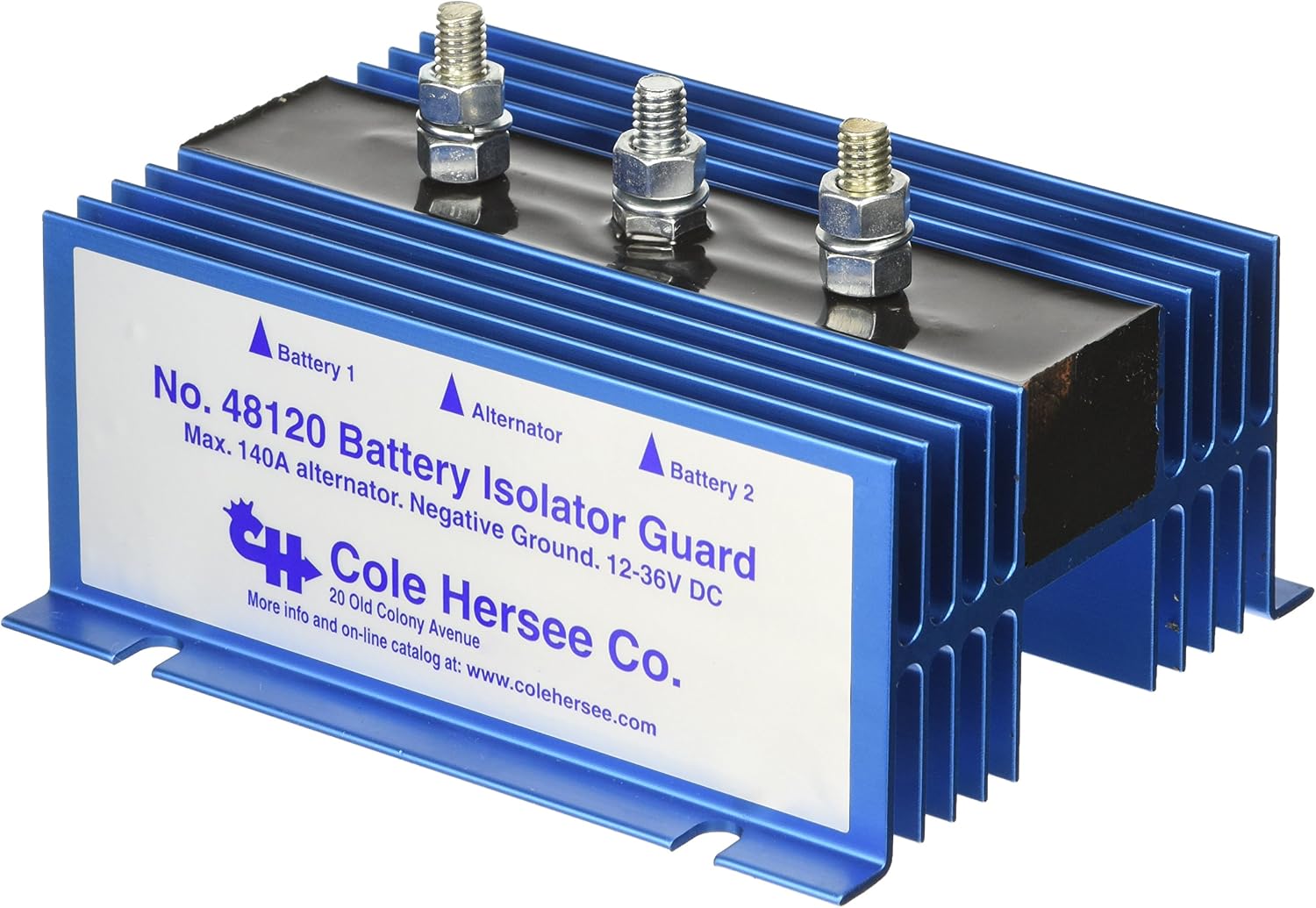

  • LaReaLaRea Member, Moderator Posts: 7,933 mod
    I'm going to assume your boat has a shore power system, a built-in charger, and a battery isolator.  If not, ignore this post!
    The isolator has three terminals.  The input is connected to the charger and the engine's alternator.  The two output terminals connect to the batteries.
    If the isolator is faulty, the batteries will get little or no charging current from the alternator.  When you run the engine, it draws current from the battery.  With no current from the alternator, the engine will drain the battery as you drive.  That's why you couldn't start the engine after stopping for lunch.
    The isolator might look something like this.
    Amazoncom Cole Hersee 48120 Battery Isolator Automotive
  • dbeall1914dbeall1914 Member Posts: 14
    Thank you I believe this is what I will replace 1st. And then do some testing.
