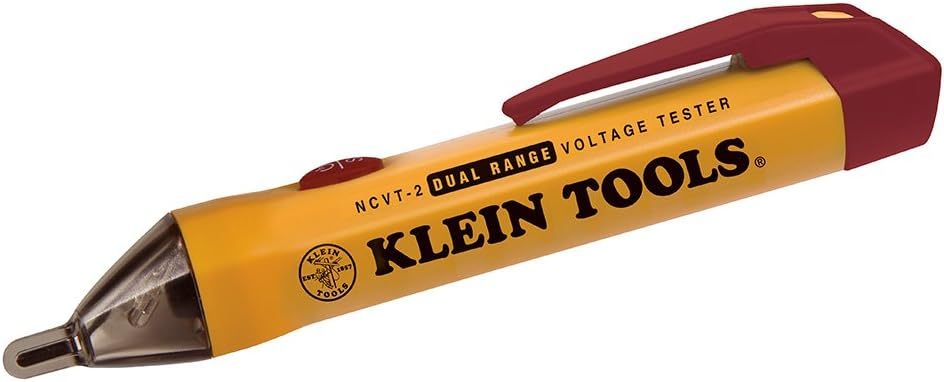

    Get a voltage tester ($20) and start poking around to see which parts of the system are energized.  All you do is hold the tester next to the cable and press the button.  If there's power, it will beep.
    https://www.amazon.com/Klein-Tools-NCVT-2-Standard-Protection/dp/B004FXJOQO

    Also, Yes,.. we tried multiple power pedestals and 2 different power cords to eliminate that possibility....  I actually have that exact tool along with many other electrical diagnosing stuff, multimeter, etc. I am pretty good with electrical as I deal with it all the time in my job... but havent dove too far into the electrical system of boats yet...
