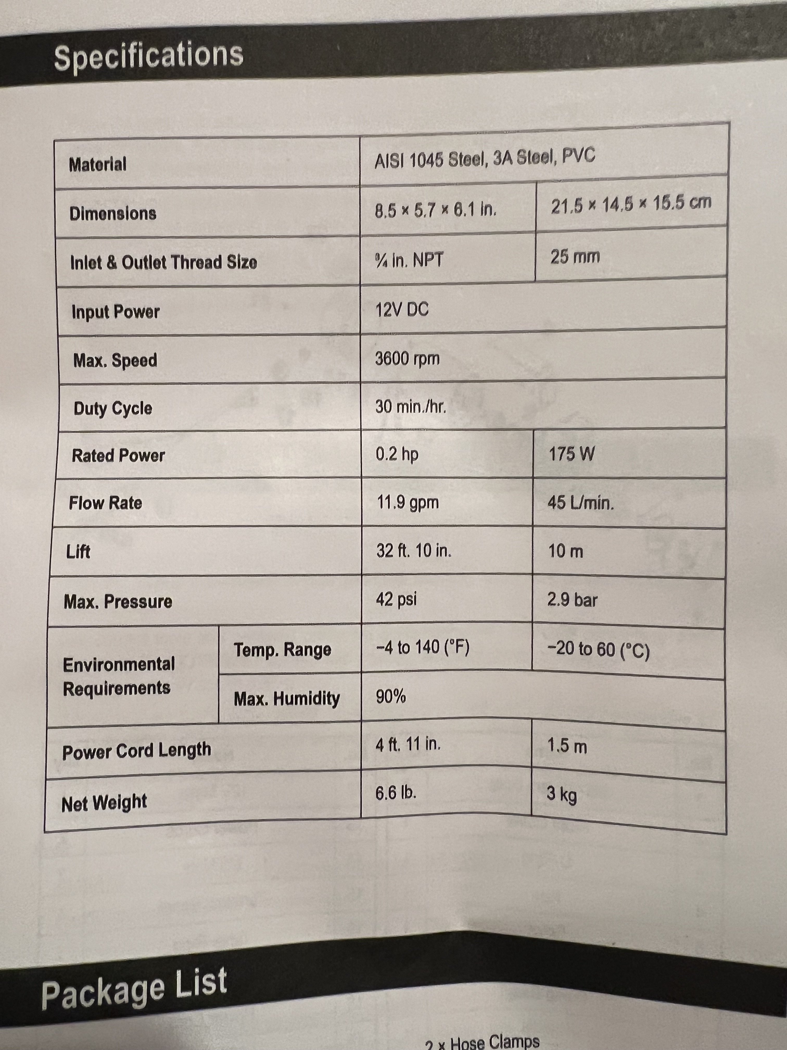

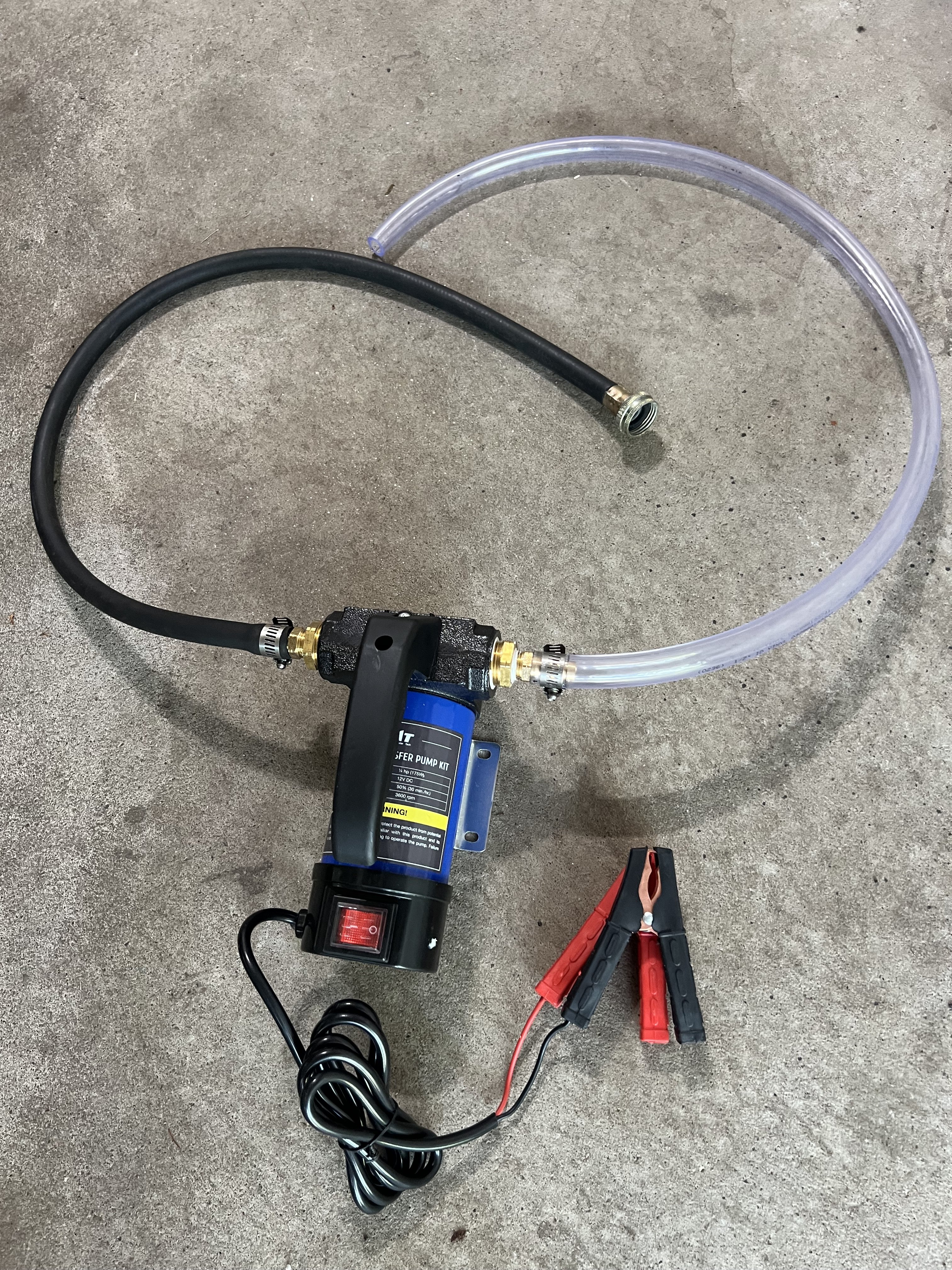

I read through the reviews and many use it for oil extraction.
https://a.co/d/077feChI

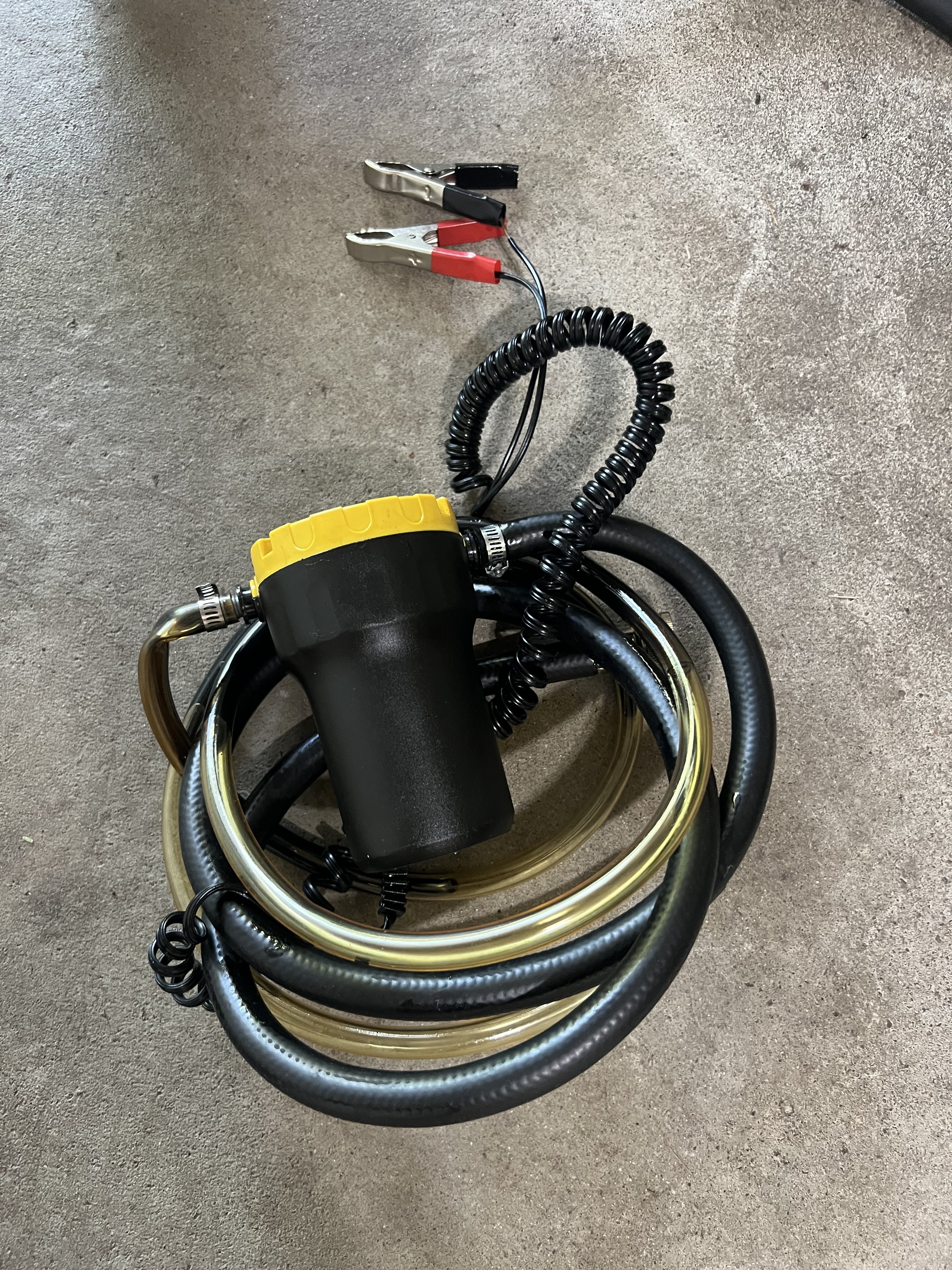

It does get quite hot so be careful when you're done the second motor. It will burn you good if you're not careful.
