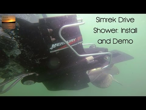

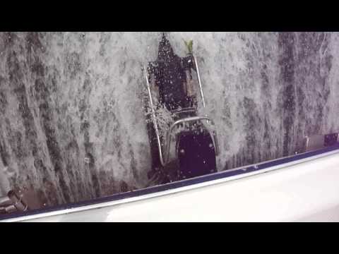

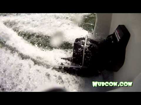

    This is the kind I use and it is awesome, never have white junk on the drive and have used them for about 4 years. Keeps the drive cool and clean:
    http://www.driveshowers.com/
    https://www.youtube.com/watch?v=WMiGm_ObIpU&amp;feature=youtu.be
    https://www.youtube.com/watch?v=Ske-qLlEjL8&amp;feature=youtu.be
    https://www.youtube.com/watch?v=iPOqoLWLwPg
