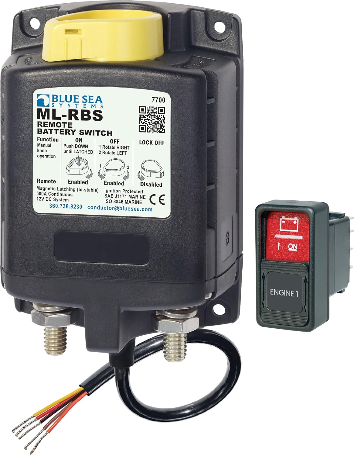

    But maybe I'll install a remote battery switch.  This one from Blue Sea Systems sells for $165.  At 12 volts, it handles 1000 amps for 30 seconds, and 400 amps for 5 minutes.  I think my boat has a battery switch under the v-berth next to the battery (like @Dream_Inn mentioned), so this device could probably be a drop-in replacement.
    https://www.amazon.com/Blue-Sea-Systems-7700-Battery/dp/B0016HRUPE
