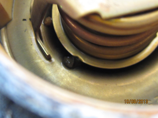

    Also, I'm not ruling it out that I have a thermostat stuck open and not letting the engine get warm enough for closed loop and tighten up the ring tolerances a bit. Since the faulty coolant temp sensor was replaced my temp gauge hasnt even touched anything above what I assume is ~ 150-160* on the gauge. From my experience most engines like operating temp around 180* for optimal fuel mileage and performance. Plus, if the oil isnt getting above ~ 220* it wont be able to "burn off" the water and acids from the combustion process.
    Now, we all know the Faria gauge isnt the pinnacle of accuracy, but I would expect to see 175* on a 100* day and cruising at 3500rpm for extended time.
    And now that I think about it the temp sensor was replaced at about 16 hours, which was just a little before the 20 hour oil change. The original oil from the factory was nowhere near as "fuelly" smelling as the stuff in it now, so I wonder if I still have some sort of issue on the coolant sensor side......
    I'm finally at a computer instead of pecking on a phone...
    ^ that is reasonable.. however, Marine engines generally use 160* 'stats, and are programmed for that.. they likely 'close' loop around that temperature, but it doesn't happen all the sudden, or at least it doesn't in automotive applications.. it will start to check through, as sensors come online, and then it will bounce open/closed a few times before it finally closes.. I ~think~ it does this to 'sample' readings in closed loop before it determines it's safe.. that is just a supposition though, and it may likely be a lot simpler than that...
    rich engines run excessively smooth.. it's almost impossible for them to pre-detonate, and because they have excess fuel present, when it ~does~ burn, it burns all the way to the bottom of the stroke, or at least deeper into the stroke than a leaner engine.. that doesn't mean it's more powerful a burn, but a smoother burn..
    not reaching operational temperatures will absolutely keep the engine in open loop, rich, disallow seating of rings, and disallow dissipation of h20 in the crankcase.. a stuck 'stat will do it with a certainty, but there is a more ominous thing that can happen too, that you've had happen already: the temperature sender soils the sheets.. what happens in that circumstance is the engine actually ~does~ reach operational temperatures, but the PCM doesn't know it, and continues to provide heavy fuel to an engine that doesn't need it.. that is when excess cylinder pressures happen, and with those, excess blow-by and production of ash which taint oil, and mucho particles in exhaust, which clog catalytic converters..
