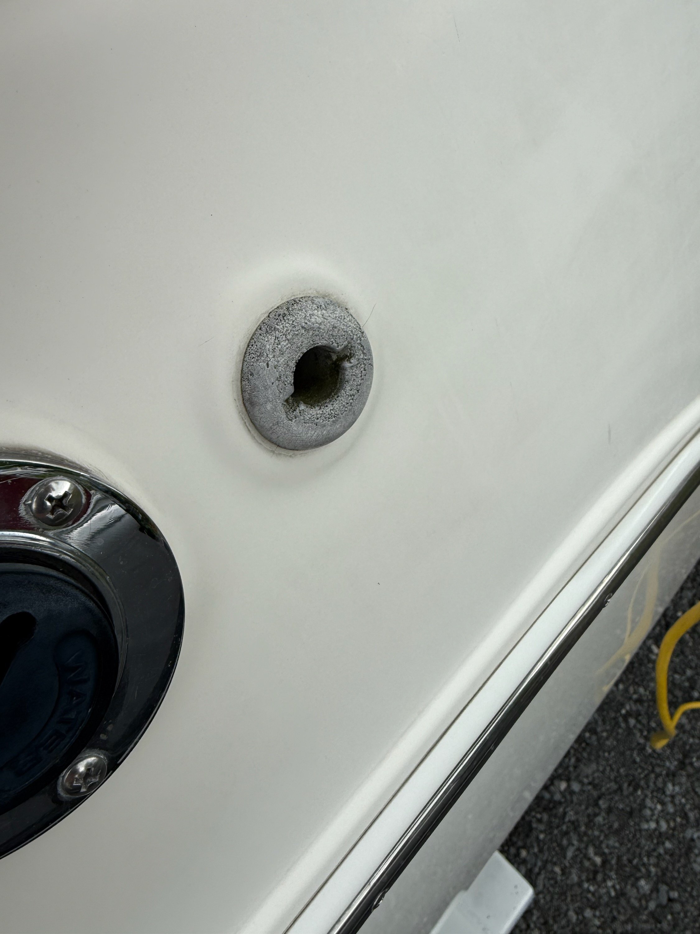

Has anyone replaced their through hull fittings on their 270 and know what size they are.  How difficult of a project is it?
All the other fittings on the boat are stainless but these are plastic.  They are starting to break down and look like crap.

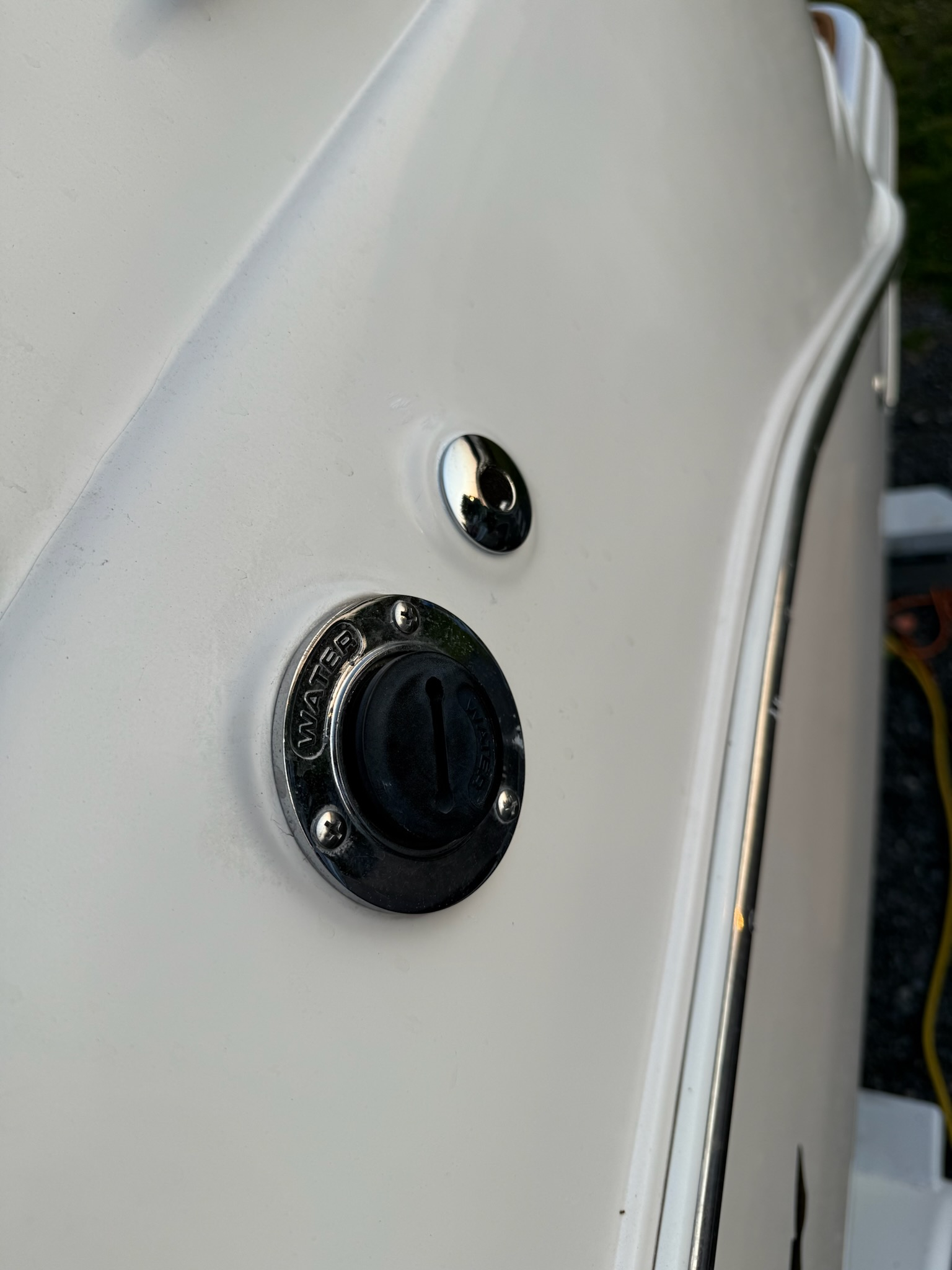

    After 2 years, I finally got around to replacing the vent thru hull fittings.  They look much better than the old ones that were deteriorating.
    https://www.greatlakesskipper.com/rinker-boat-thru-hull-fitting-7450170-5-8-inch-stainless-steel

    Very nice @JonnyM !⚓️
  • raybo3raybo3 Administrator Posts: 5,624 admin
    Looks great
