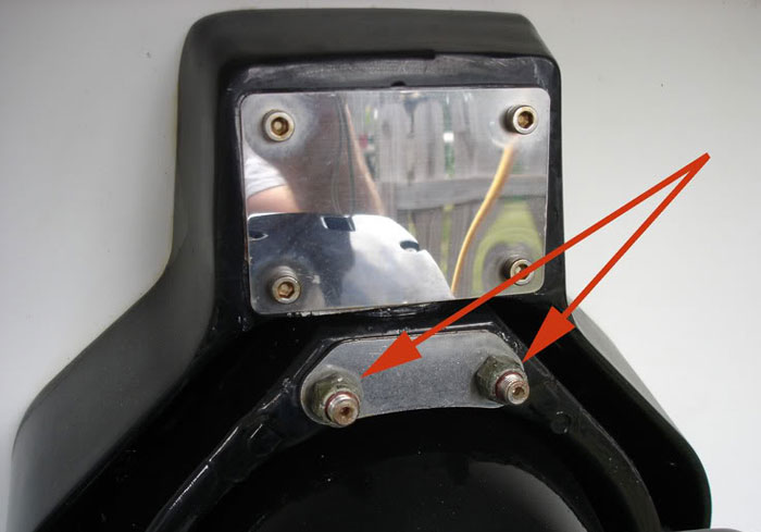

    I forgot to mention the u-bolt nuts should be checked for correct torque.
