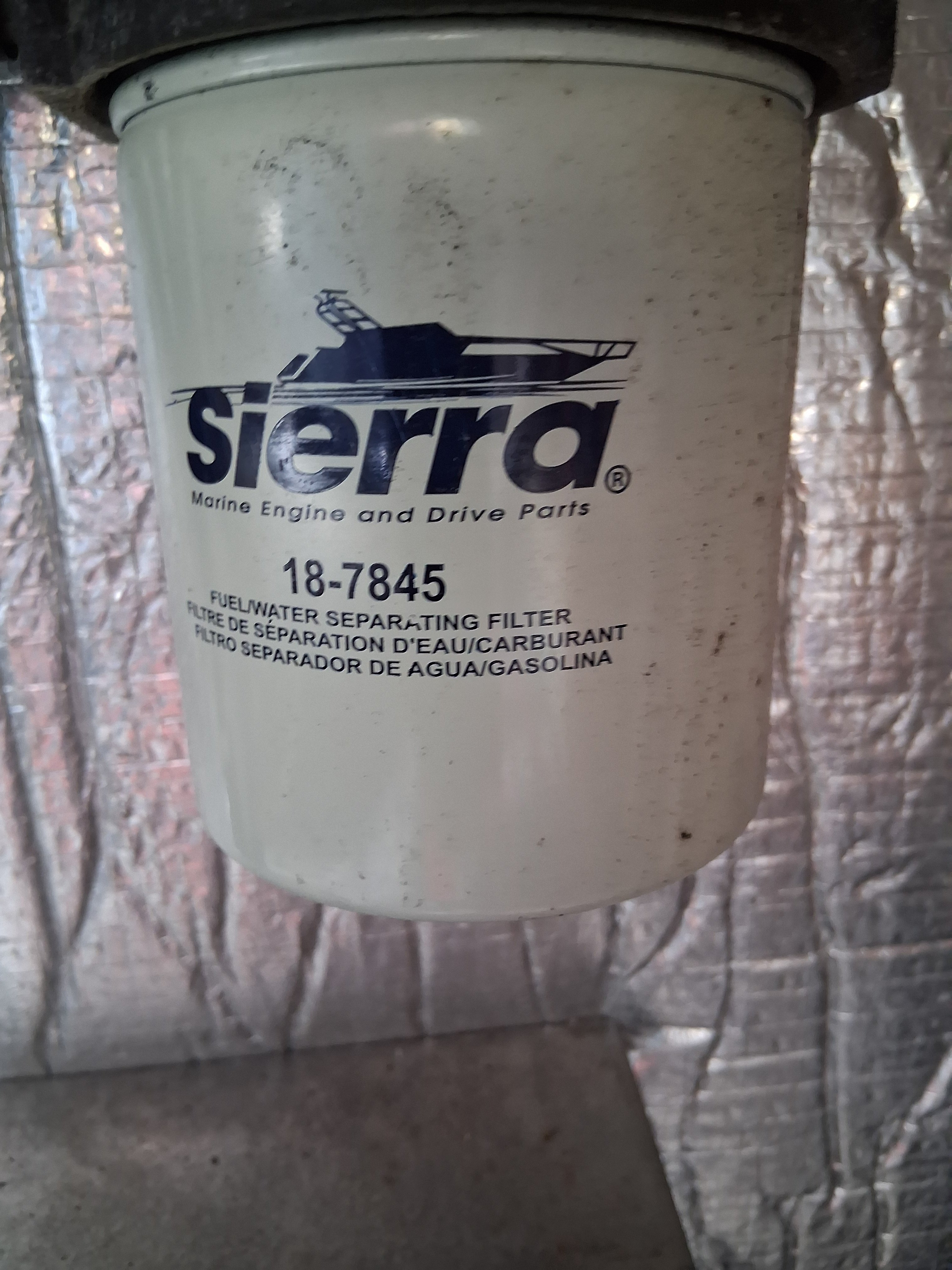

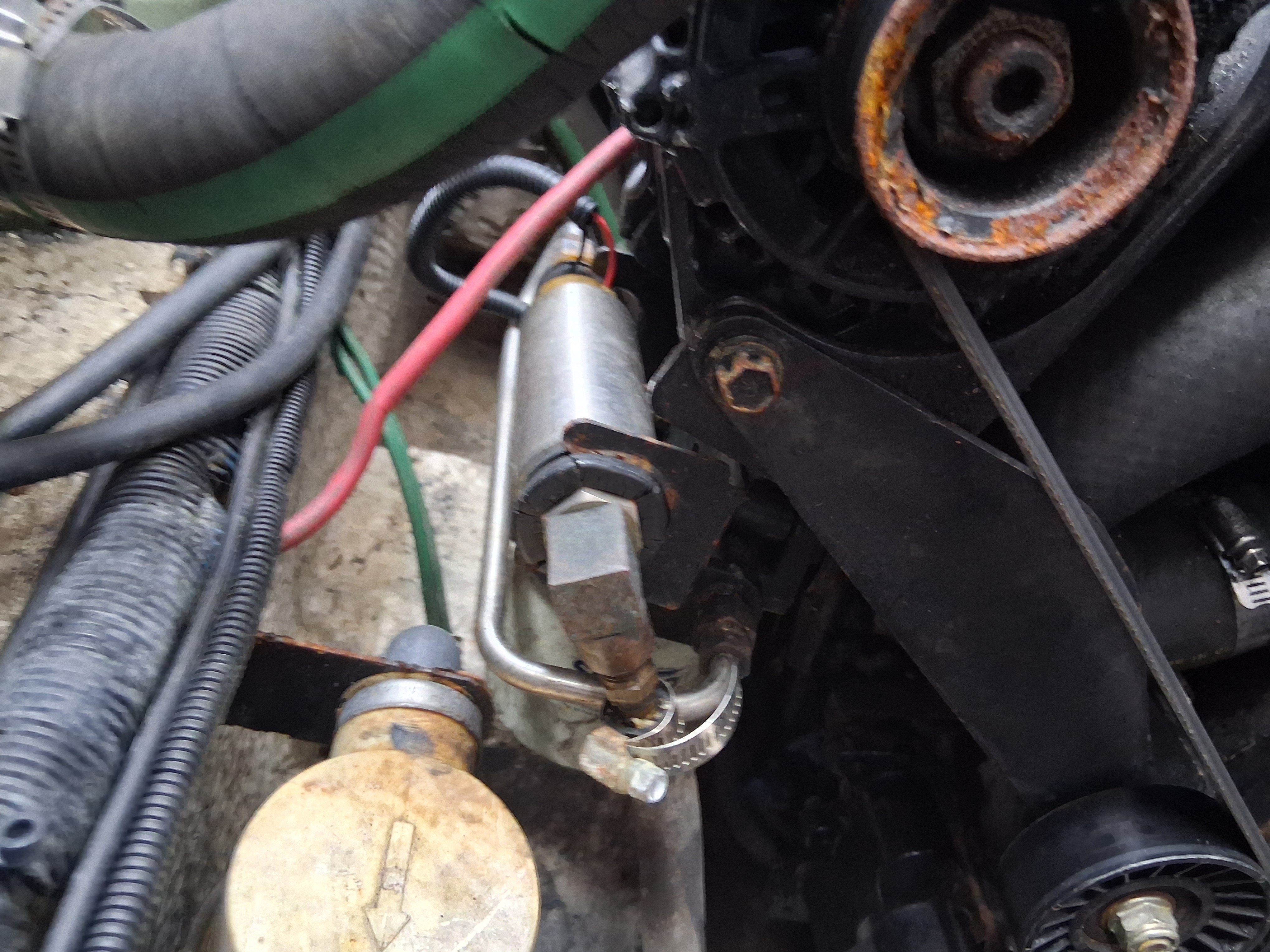

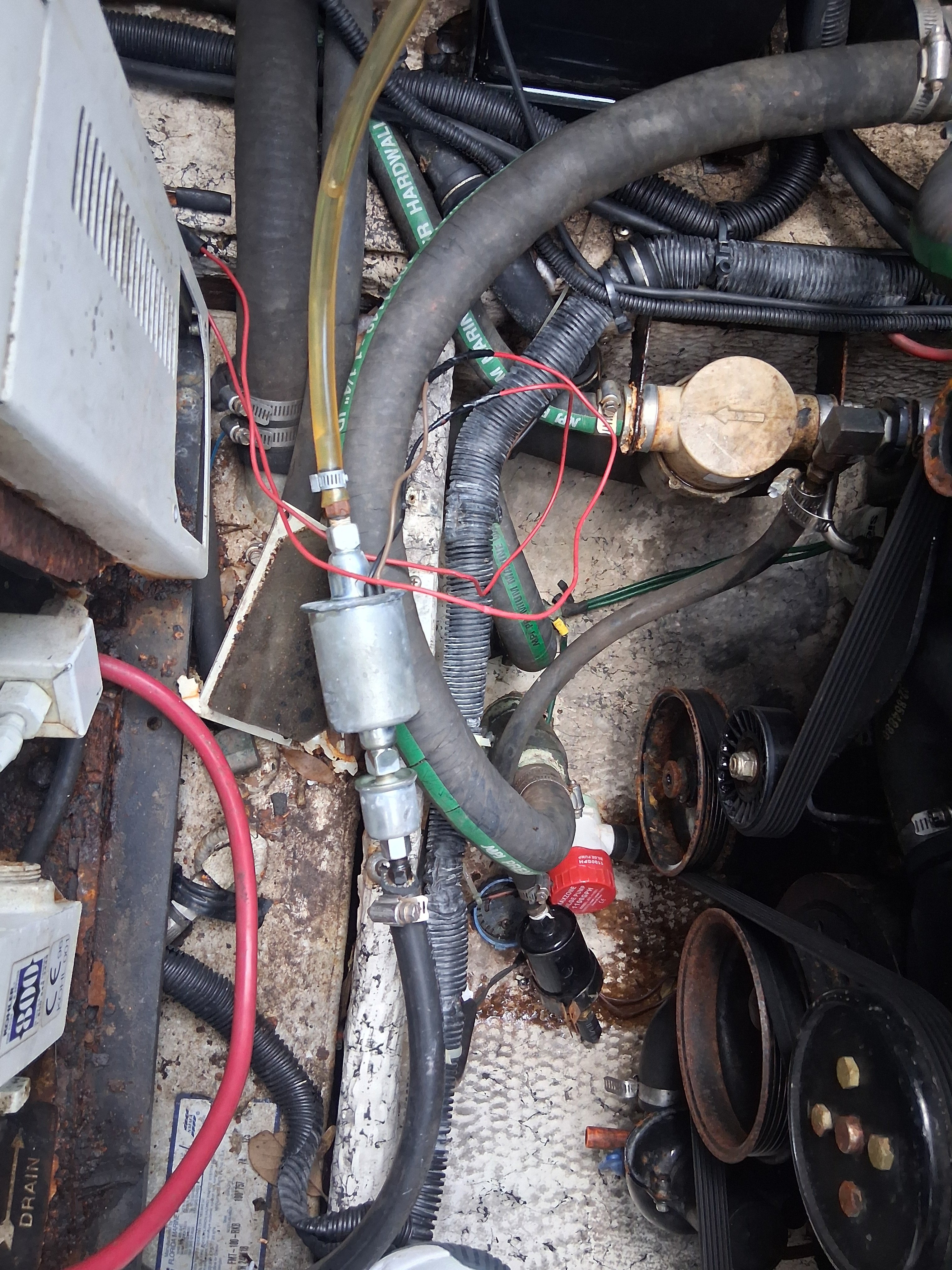

So...I just pumped out 50 gallons of non ethanol fuel I suspect aged out. The boat would run but not plane out- wasn't missing just no power- so I figured the place to start- about 2 1/2 year old fuel with no "protection " . Do next is filters but I'm a bit confused. My fuel line to the engine goes through a filter and right into the pump. No fuel water separator.  I do have one for the generator and I believe another in line filter- this sound right? The big looking filter is the pump I used to pump out the has. The black filter is at the bottom right. The generator frame is disappearing.
    @rasbury I am confused. That white 18-7845 is your filter/seperator. It should be on the left side of your engine. Looks just like an oil filter.

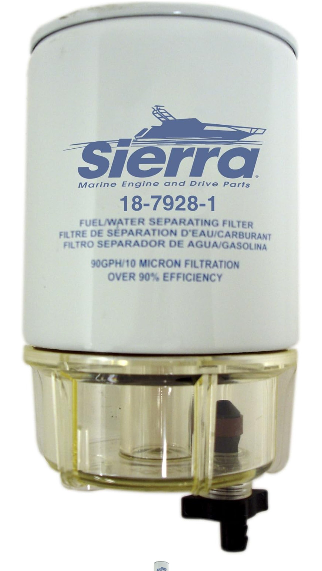

    You might want to consider a fuel/water separator with a drain. Seems like you have a lot of issues with water in the fuel.
    I thought the same thing but was told they are not approved for inboard engines just outboards.
  • YYZRCYYZRC Member Posts: 5,605 ✭✭✭✭✭
    Respectfully to @rasbury , there are quite a few things going on in that engine bay that are a bit dicey - I don’t think a fuel/water separator with a drain would compound much!
  • PickleRickPickleRick Member Posts: 4,408 ✭✭✭✭✭
    Supposedly you're not supposed to add an extra filter in a mercruiser system that uses cool fuel.  Engineers claim it over works the fuel pump.
    The OEM screw on is an water separator filter iirc, just doesn't have the inspection bowl.   A bowl isn't something you want hanging next to a hot gas exhaust manifold.

    It looks to me like the cool fuel module has been removed and replaced with an in-line pump? (first picture)

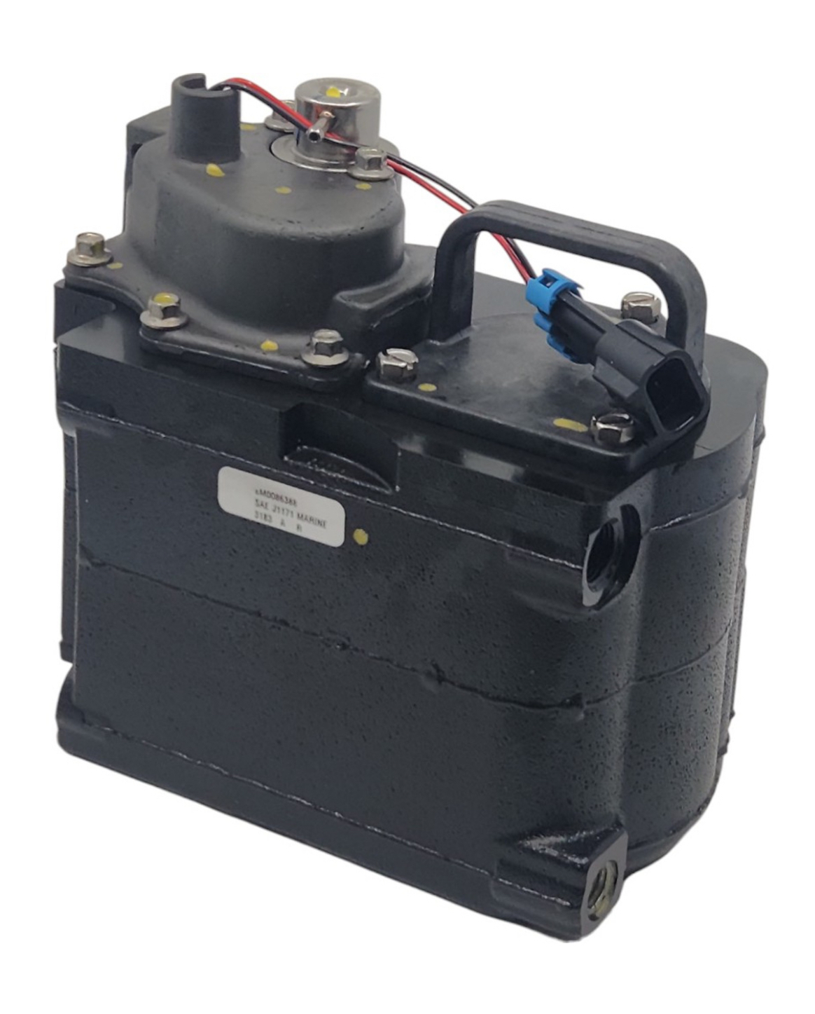

  • aero3113aero3113 Member Posts: 10,106 ✭✭✭✭✭
    @PickleRick this is what the cool fuel module look like on my engines.

    Yeah, if they didn't paint the inside of it only to then get eaten by ethanol fuel and clog the regulator.  I'm on my 3rd set (at one boat unit per engine, it's not fun), but I've been using non-ethanol fuel mostly now.  I guess I'm going on 5 good years or so now.  I've been told that the version I currently have does not have the internal coating that will flake off anymore.   The pump basically has a high and low pressure pump built in as well as two fuel filters and a regulator.  They've also changed the newer models to have better fittings for the cooling water.
