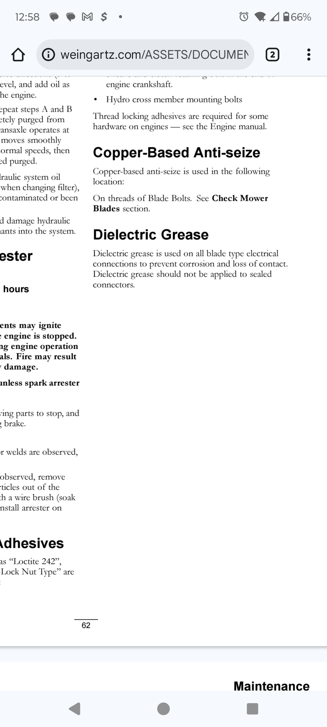

    This is taken from an Xmark owners manual.   Although I find this a bit of a contradiction as the brake control modules I mentioned before are sealed o ring connectors and Xmark is shipping them in the box with the dielectric grease already applied.  Sealed meaning there's an o ring seal meant to keep moisture out.  Unfortunately these boxes usually fail due to corrosion getting so bad the pins on the box break off flush.
