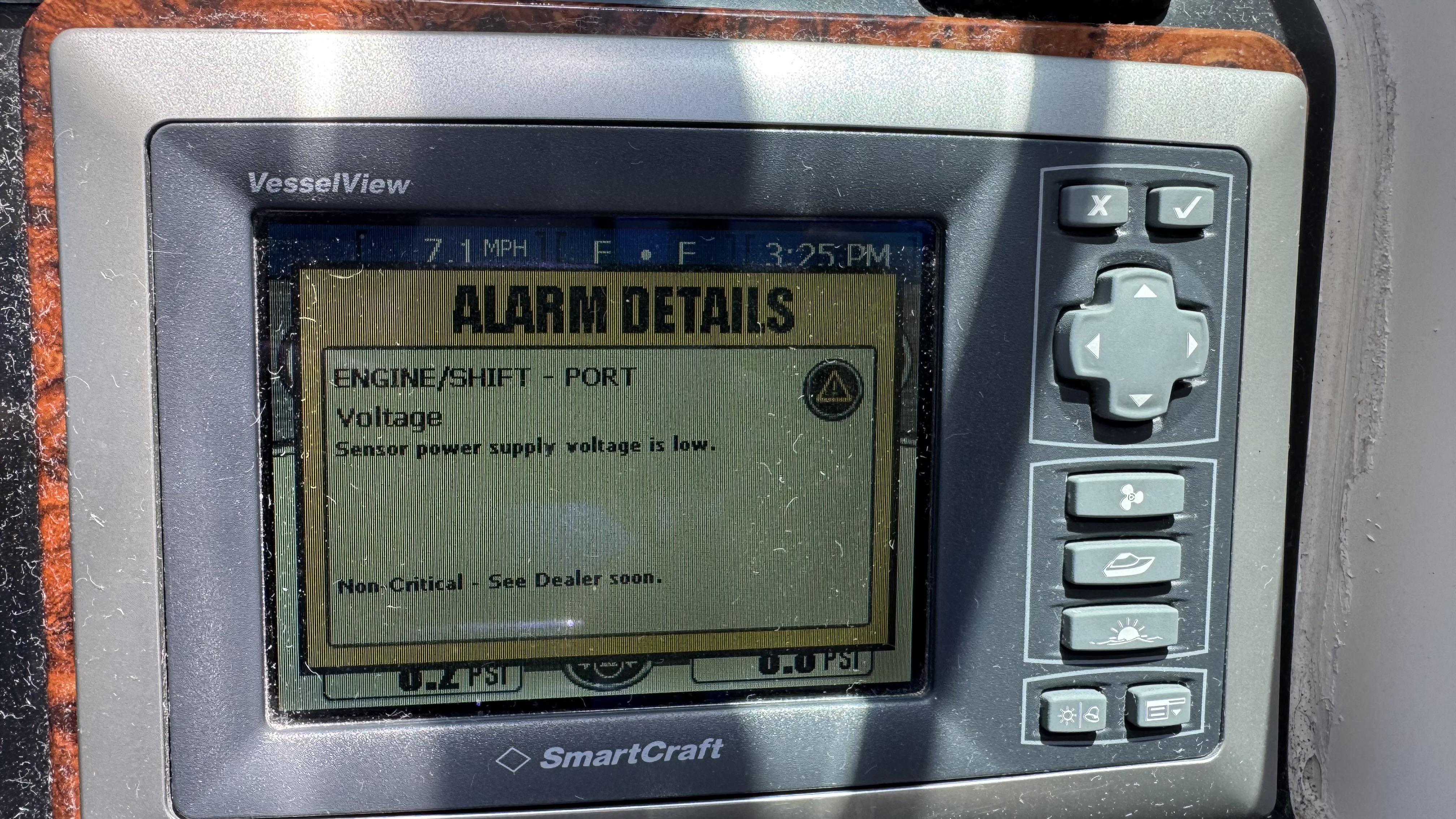

I was running the boat and the following voltage alarm come out. I am having issue with my trim sensor which are moving up and down on its own, I am wondering if the trim sensor are causing  this alarm.  i also wonder if anyone have this voltage alarm before, or see it. any ideas will be appreciate. Thx

    I have read that the trim sensor could cause this issue and some guys say just unplug them at the transom to see if the issue goes away.
    I would also check the 90 amp fuse at the starter and either clean it or replace it. I would also check the 21 pin connecter to be sure its tight and that the pins are clean.
    I have had that fault in the past and it seems if i trip the circuit braker at the motor and then reset it the code goes away. Let us know what you figure out and the solution
