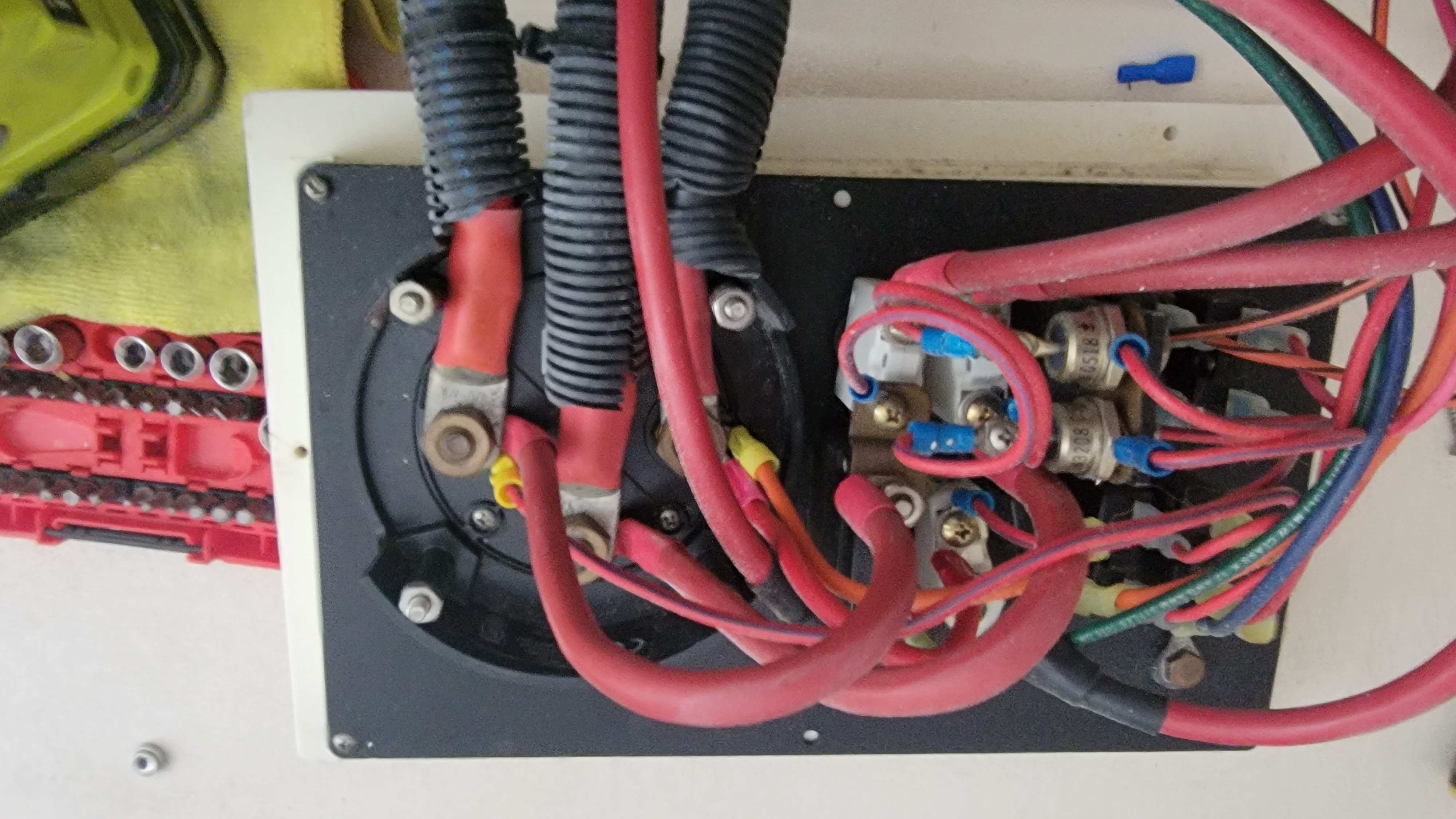

** forgot to mention...I thought odd..with what i presume battery one is removed, when I went to lower the hatch it would only work if the battery selector was on both- would not work on one or two?

I put the new battery and the good one back in today. GBT gave me a procedure to remove the negative cable and check for amp between the terminal and the cable. . Battery 2 which I don't seem to have as much problem with was a dead 0. The other battery is .10 which would kill the battery within a week or so which sounds about right. I pulled the power wire off the alternator and checked again with the same result. That should rule out the alternator with a bad diode .
So, I've left the negative off that battery until I come up with a plan to figure out the draw. I still do not understand that with battery 2 in and all hooked up the hatch will not work. The trim works, the engine turns on. I had to close it by using the jump box on the terminals at the battery switch. With the completely dead battery still hooked up, the hatch would raise on battery 2. Remove battery one and does not work. Not that I'm going to worry about it now- just seems odd. I have other things on my list to get done. I'll just have to hook that battery up at the ramp. I assume normal charging while running or on shore will keep it up and the draw during a day out won't kill it.
Update: as far as the hatch, it would have helped if I had turned on the accesory switch by tge battery selector. It does beg the question, things that are hot all the time like the radio and the bilge- would they run off battery one ? If it is dead, will the bilge still run off two somehow? I imagine this system is a little complicated than a novice like me will grasp. Searchlight? I tried it yesterday, I put a new control head on it, but nothing would come on yesterday with the negitive off bat 1. I did not try the radio but I will play with tgat a bit. We are only up to 55 today- might be in the water on Friday.
I am having an issue with the sump pump in the shower. It's locked up. The box is also full of water , i wonder if that pump is wired hot like a bilge? Since the float is trying to turn the pump on, could that be my draw? Im going to cut the pump and will test the wires for power with everything off. I probably won't have time to deep dive in this now but will have to get back to it.

I checked the amp draw at the ramp. I had cut out the shower sump motor. Before I replace, sounds like I should try to break the motor loose before I replace...but the amp draw was still the same. Something with everything off is pulling 3 to 4 amps with everything off.

I did recheck at the ramp bat 1, interesting to me was with the engine off and checking the amps, it did not matter if bat switch was on or off- same draw of 3 to 4 amps.

Was the ignition switch on when checking the amp draw at the ramp?
How about the battery switch?
Just your radio and amp turned on, not playing will draw amps.
I would be looking for the source if your test was done with the battery switch off.
