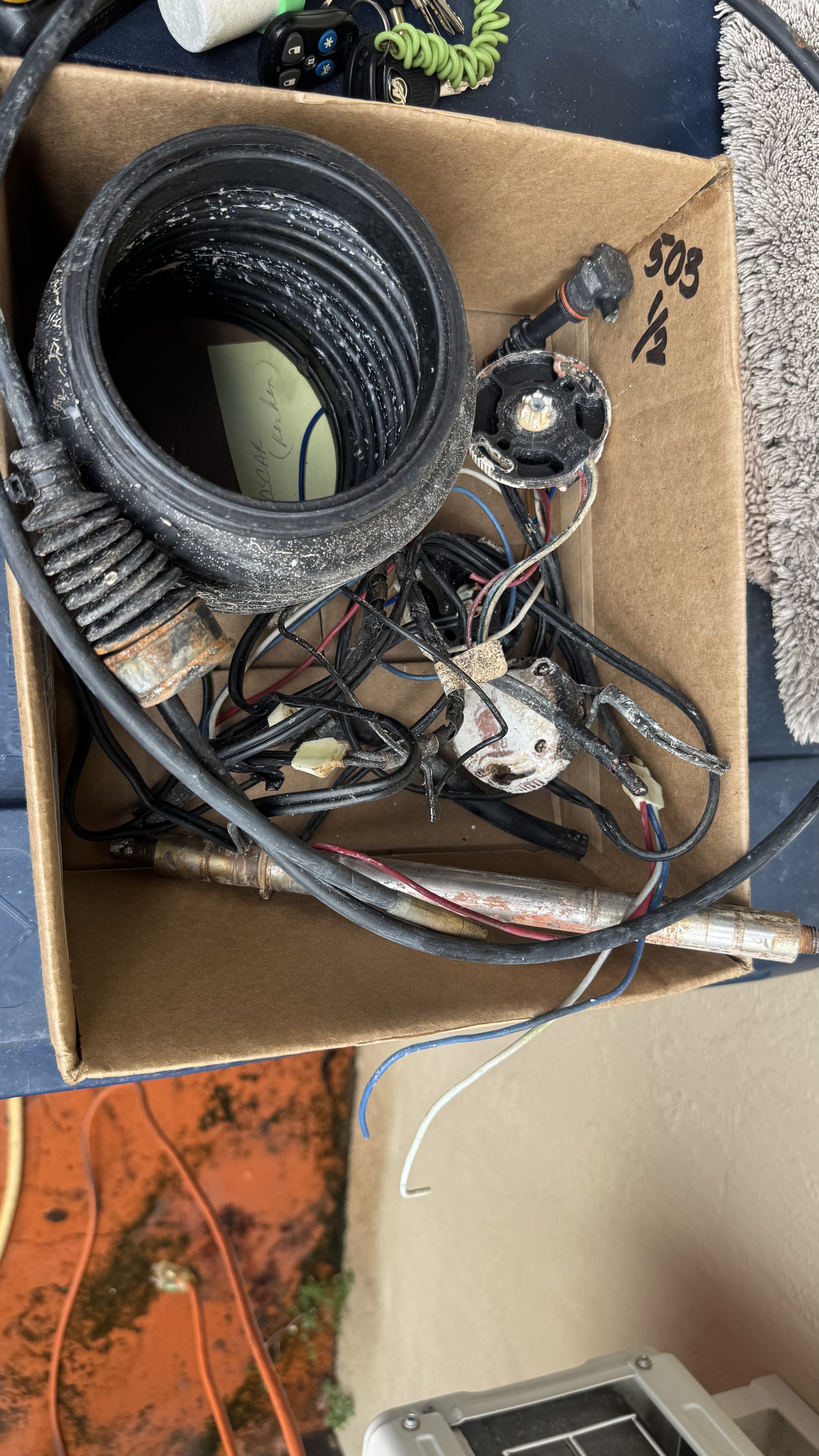

  • oscar1oscar1 Member Posts: 804 ✭✭✭
    Oscar, did you do this or on the list?
    yes, but i also have to change the mercathode which it was causing a big electrical short in starboard eng. i still waiting on parts, so i can get the outdrive paint before taking her back to the water. Thank you for asking.

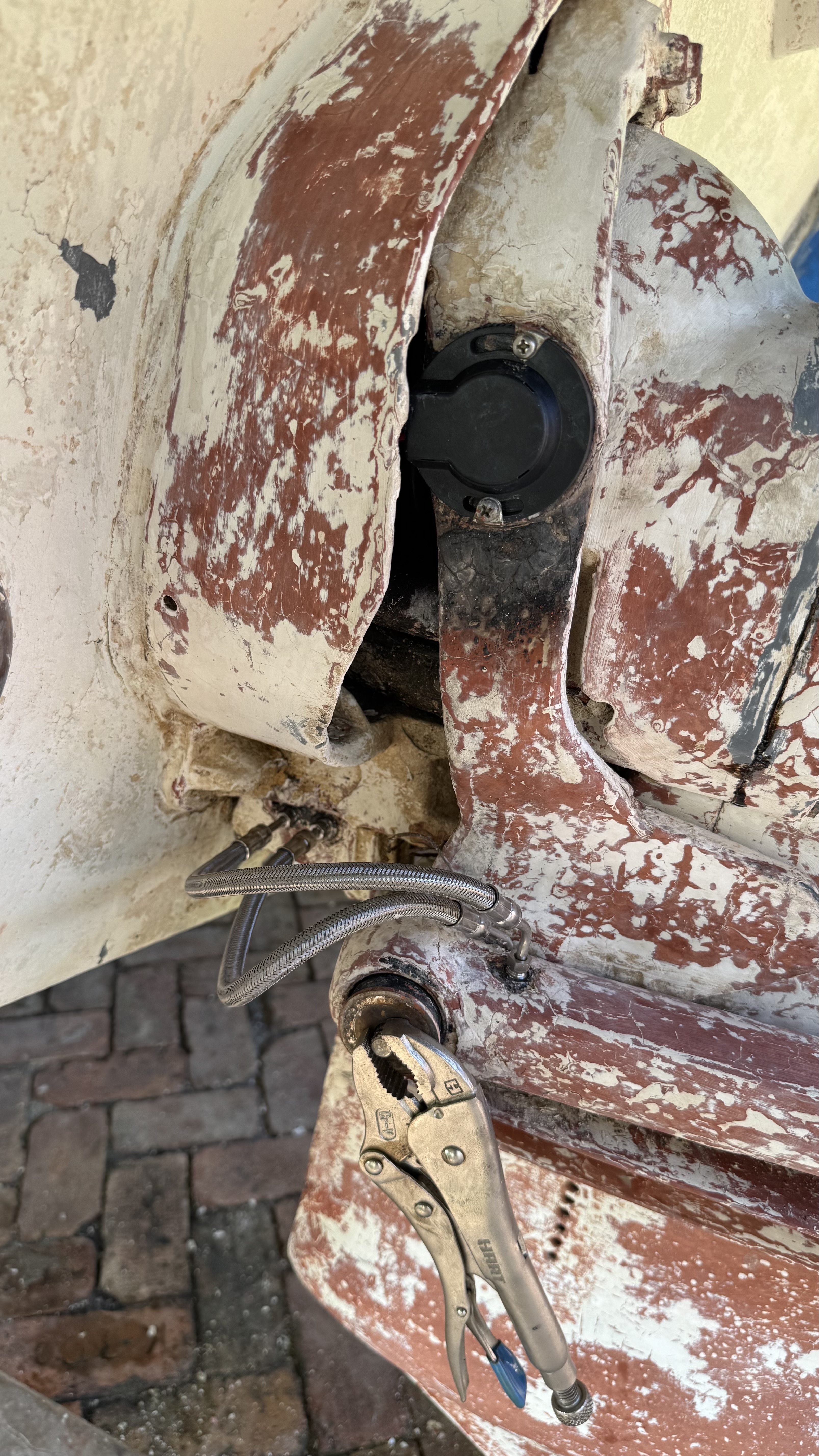

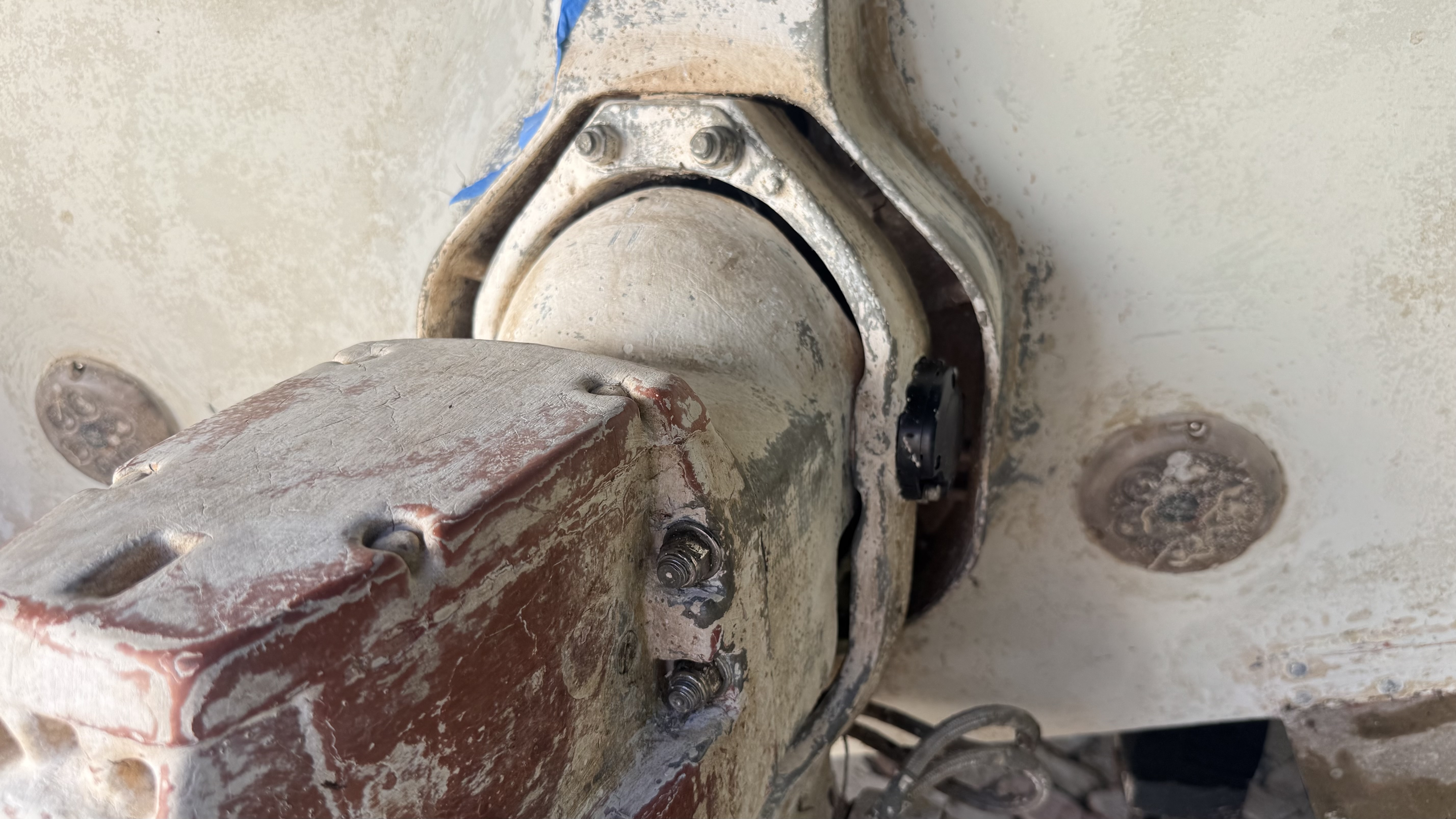

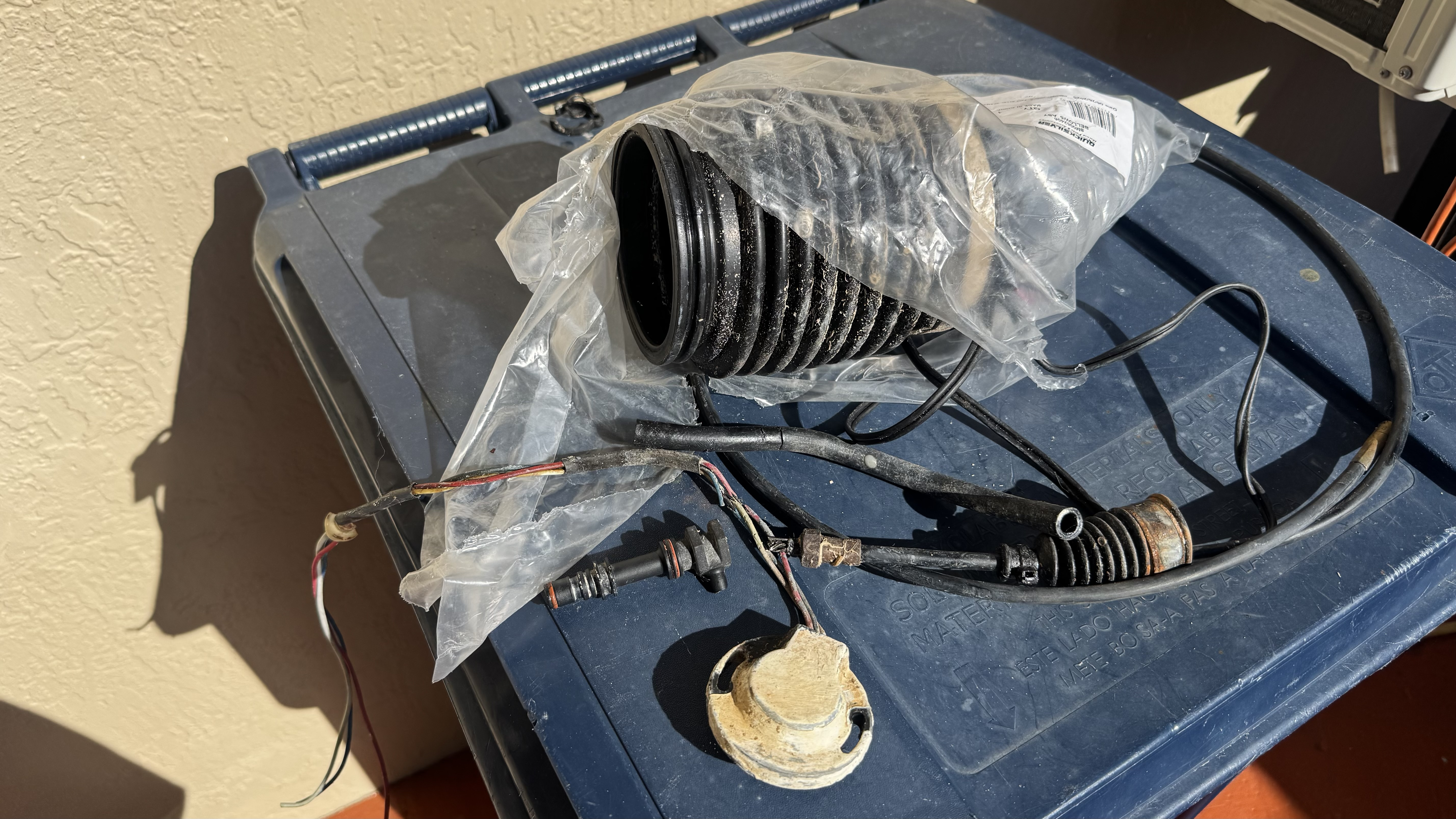

    Did you have to pull the drive? Those studs that hold it on are not very long..I assume it has to come off. Great time to check engine alignment,  the tool is no expensive.
    Yes, the outdrive was out, but i didn't check for the alignment next time, do you have any idea how to troubleshoot the mercury mercathode system?
    If it went back on, as long as the drive shaft went in easily you are aligned.  If it was forced, it will eventually blow out the coupler , u joint etc.. it is an enormous PITA especially alone.
