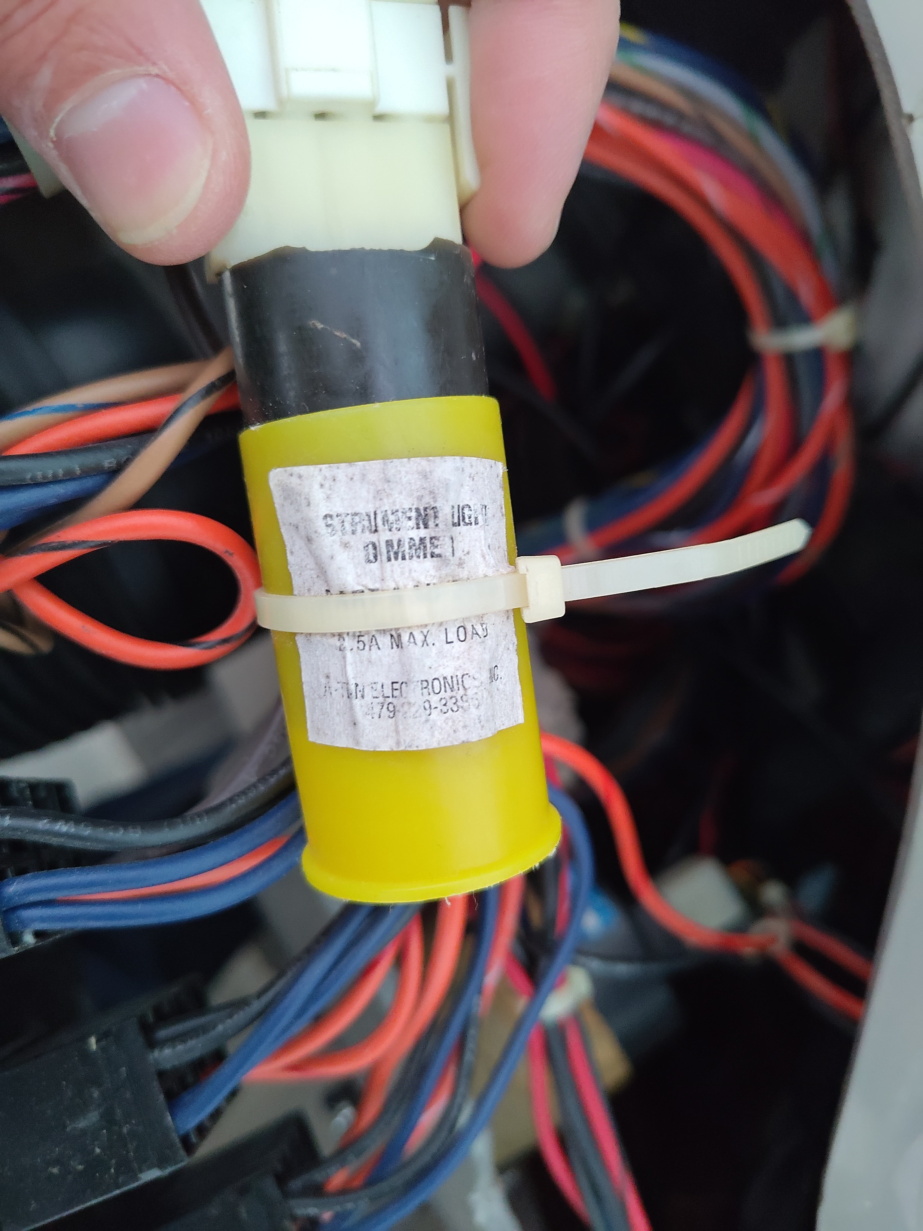

    Also, behind the dash my dimmer connects to this module, which takes the button signals and adjusts the lighting voltage.
