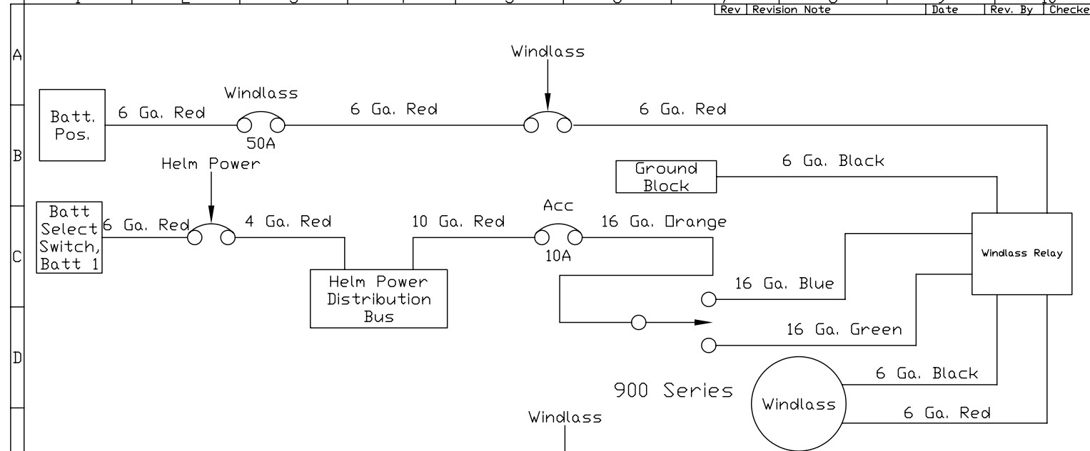

Anyone know where this relay is located? Is it back by main battery disconnects or up by windless in bow?
  • kordokordo Member Posts: 251 ✭✭
    On mine, it is starboard of the windlass, awkward to access.
  • rasburyrasbury Member Posts: 9,005 ✭✭✭✭✭
    @tricountytrail what kind of problems are you having and your trouble shooting efforts so far?  Mine did not work when we bought (amongst other things survey missed) and found on the back of the helm switch a terminal had broken off. So I replaced the helm switch and it worked OK for a bit but seems to have less power- it's seldom used. What does this relay your speaking of do? If you have been chasing power, how are they connected to the batteries? Is there a terminal on the bat switch  that hits both batteries? I don't recall if I have to turn the bat switch on to operate or not. I am having a circuit problem (amp draw) bat one to resolve.
    Good luck- I'll be following!
