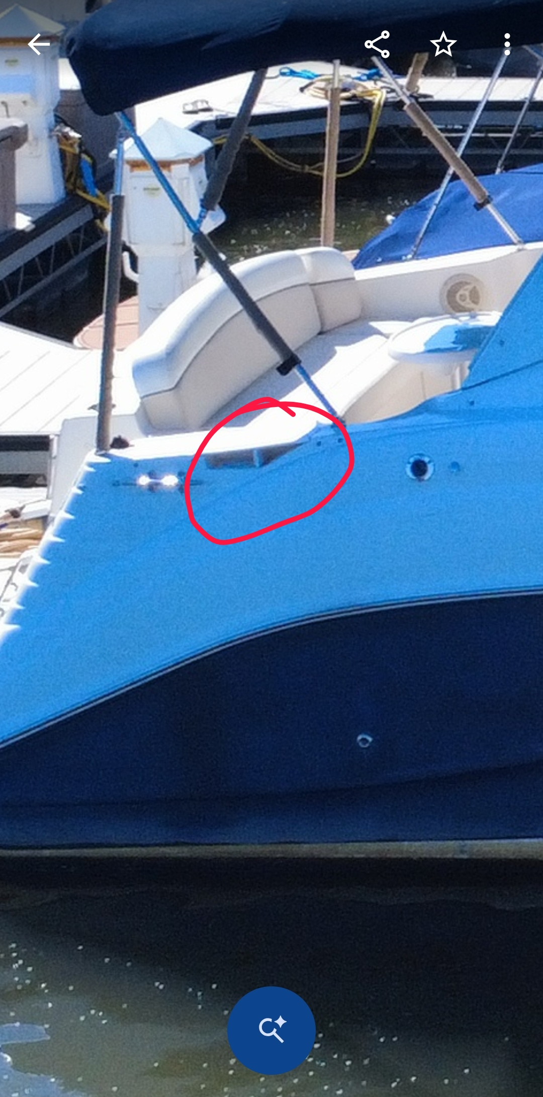

    I don't recall seeing a vent. Where is this likely to be? Does anyone have a picture?

    My boat is a 342, the vents are here:
    edited January 17
    On the back side of that vent there is a flange to attach the hose to. That being said, those plastic vent/connection is cheap and mine were only remnants when we bought the boat- you could just have an open hull there! If you have a dingy package, you may have another vent under the rear seat. On my 270, like your vessel, you may have 4 vents, two on each side- as far as I know nothing is hooked to those- perhaps if you had two motors you would have a blower for each side.
