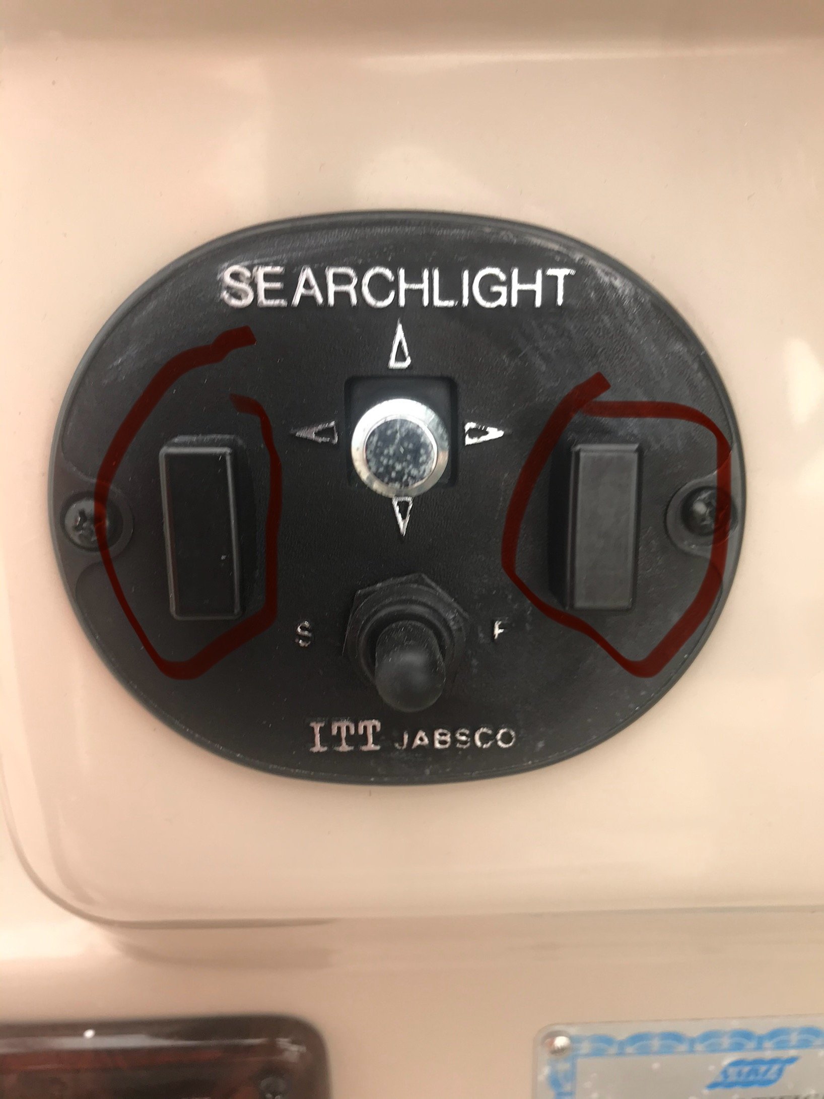

Where is the on/off switch for the spot light on a 2002 Rinker 270?
I have 2 different control units for the spot light but no on/off switch.

     Not sure what you mean by two controls but if you mean the two switches like these the bottom one is moved to the left for spot light and the right for flood light. Center turns the light off. The top joy stick type switch is to aim the light.  The joy stick is constant power to move the light even if the light is not on.  The two black protrusions are the fuse covers. Hope this helps and welcome to the forum
    Note also on either side of the joystick, there is a fuse for the lamp if it is not working.

    The fuses are good but the light still does not turn on or move. There is an additional control unit that is controlled by batteries. I think that it is just stuck to the dash and I installed 2 new batteries but it also does not due anything. I just bought this 2002 Rinker 270 Fiesta Vee in January and have so much to learn. Thank you for your help and I am sure that you will be seeing me a lot. Thanks Again.

    @Kenneth that you have 2 different controllers it could be that the original Jabsco spot light was replaced. When you are at the boat next time take a picture of the light and the controller and maybe someone here can help you figure this out
