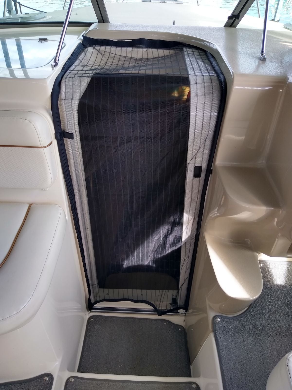

Has anyone made and fitted an insect screen door to the cabin door space on a FV 250. I want to make one but Im not sure what to use because of the curved top.
  • toolmaker312toolmaker312 Member Posts: 130 ✭✭
    We had a similar problem and came up with this.It has been a couple years so not sure of the exact sizes. We bought some white plastic tubing from Menards and slid 1/4 drill rod into it. That allowed to form to the door contour. My wife ordered some black screen.  I believe it was for a sliding glass door which we benefited from the sleeve on the side that we slipped the formed rod through on one side. The other side she had to sew together using a black ribbon. It snugly tucks between the door and frame to keep it secure. The left side just fits in the groove. Hope this helps!
