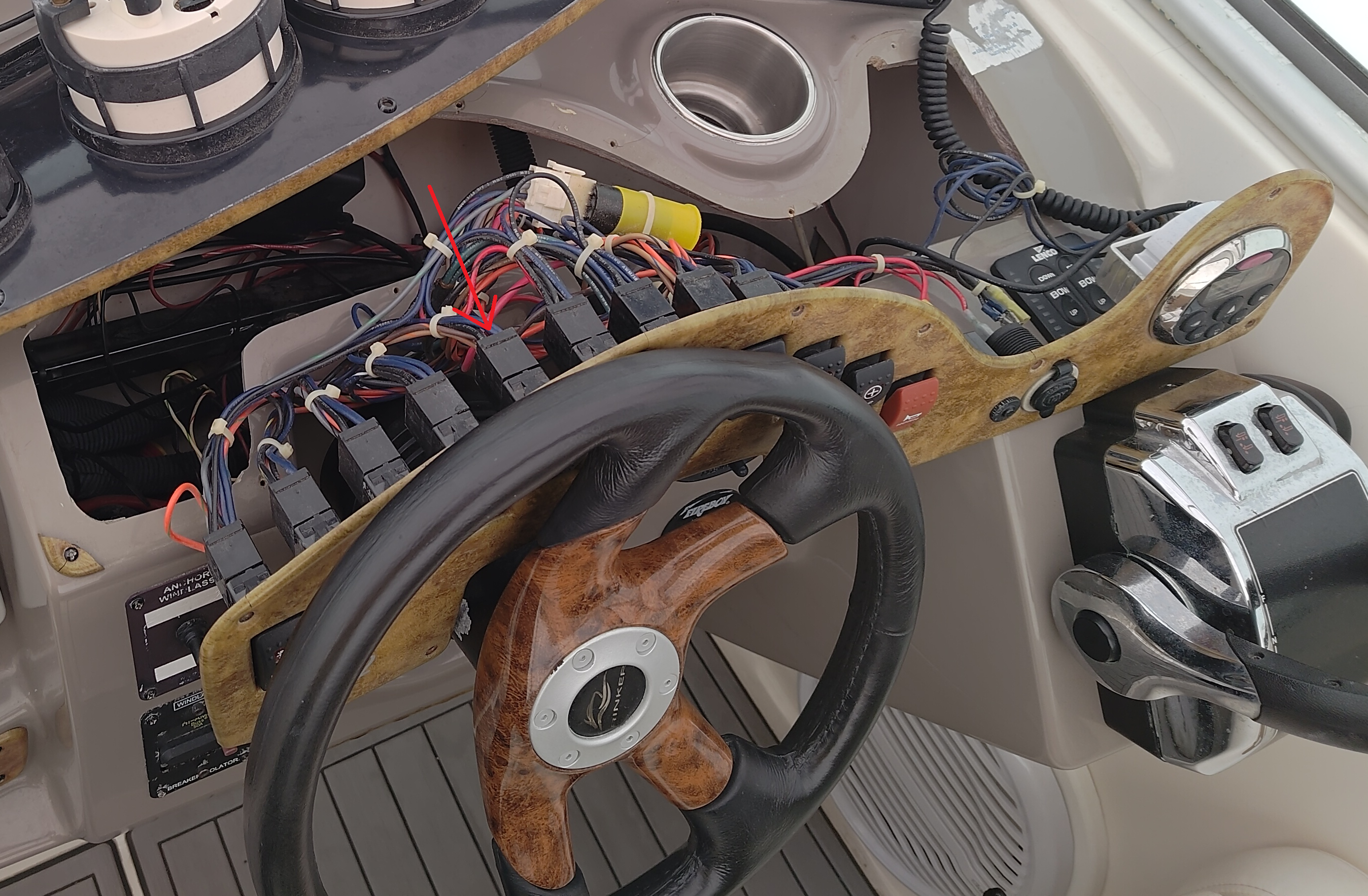

I need to rewire a couple switches on my dash, and each one has a connector for the wiring harness that holds all of the spade connectors. I can easily pull the connector off of the back of the switch, but how do I remove the spade connectors from the plastic connector?
  • aero3113aero3113 Member Posts: 10,107 ✭✭✭✭✭
    If you look inside the connector when pulled off, you should see a clip holding the spade in, use a small screwdriver to push the clip down and pull the wire out.
    You might have to bend the clip back up when you put it back in the connector.
  • grouch0jrgrouch0jr Member Posts: 287 ✭✭✭
    Is the clip plastic?
    I think it’s part of the spade connector, metal. I believe that’s how these are set up, I could be wrong.
