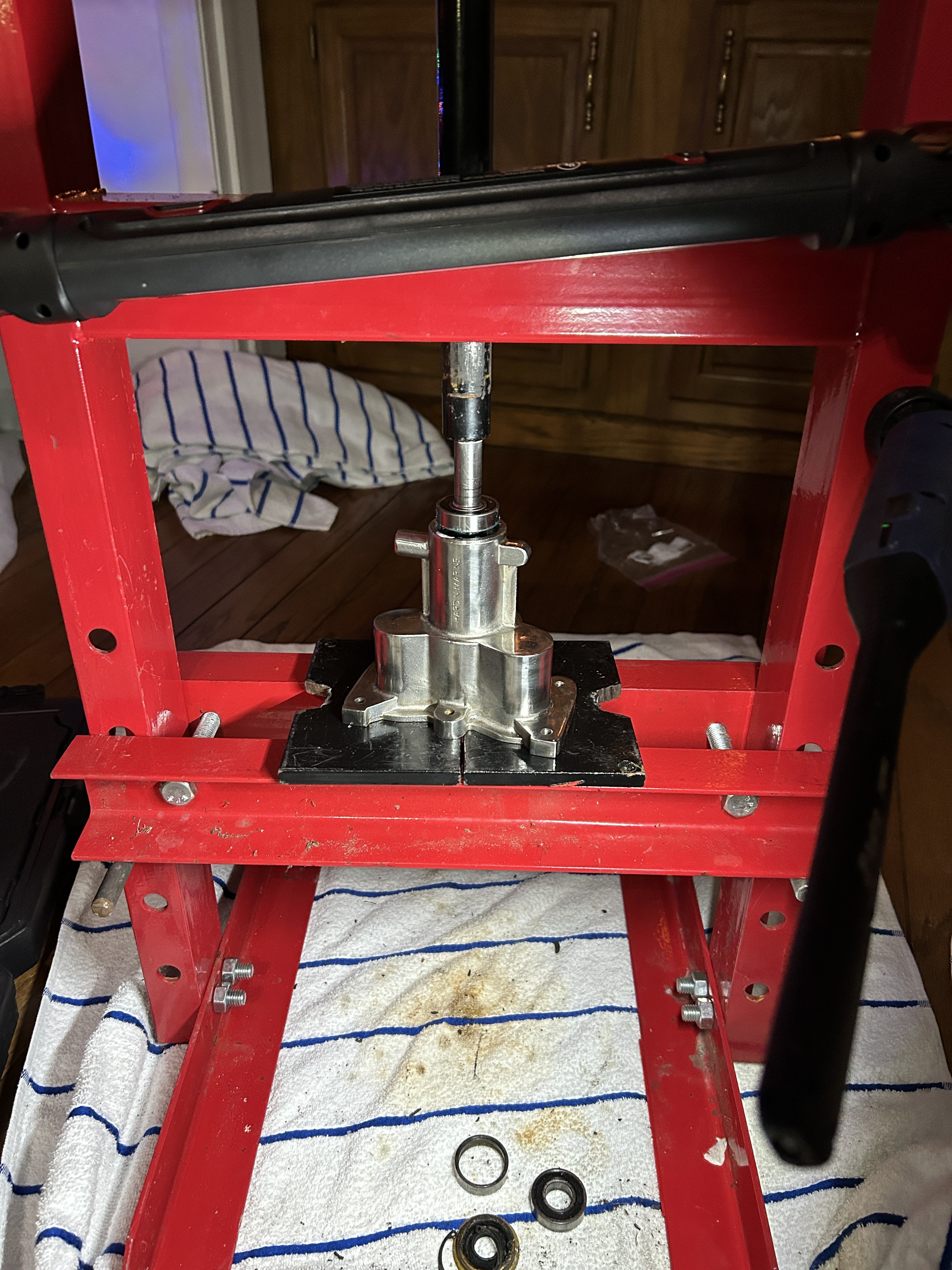

    @JoeStang if you have access to a press, it’s not a bad job.  You have to press the pulley off and then the shaft and rebuild with new seals and bearings.  I did it for the first time this past winter.  Yes, mine is a Hardin, but it is very similar for OEM.

    I dont have a press, nor really any access to one, so I'd be paying a shop to do that. :/
    It sounds like buying a new pump with pulley already installed is the better route. Has anyone had success with the "rebuilt" or aftermarket pumps that are 1/3rd the price of OEM / Hardin? Mine makes good pressure, but I'm sure its on borrowed time since the water is getting past the seal. I've got a little over 550 hours on it.

    @JoeStang , I would be willing to use my press and rebuild it if you wanted to pay the shipping both ways and parts.  I would need someone to tell me the rebuild kit to buy.  With shipping both ways and a couple days for me to rebuild, not sure if that timeframe is ok. Totally up to you.
