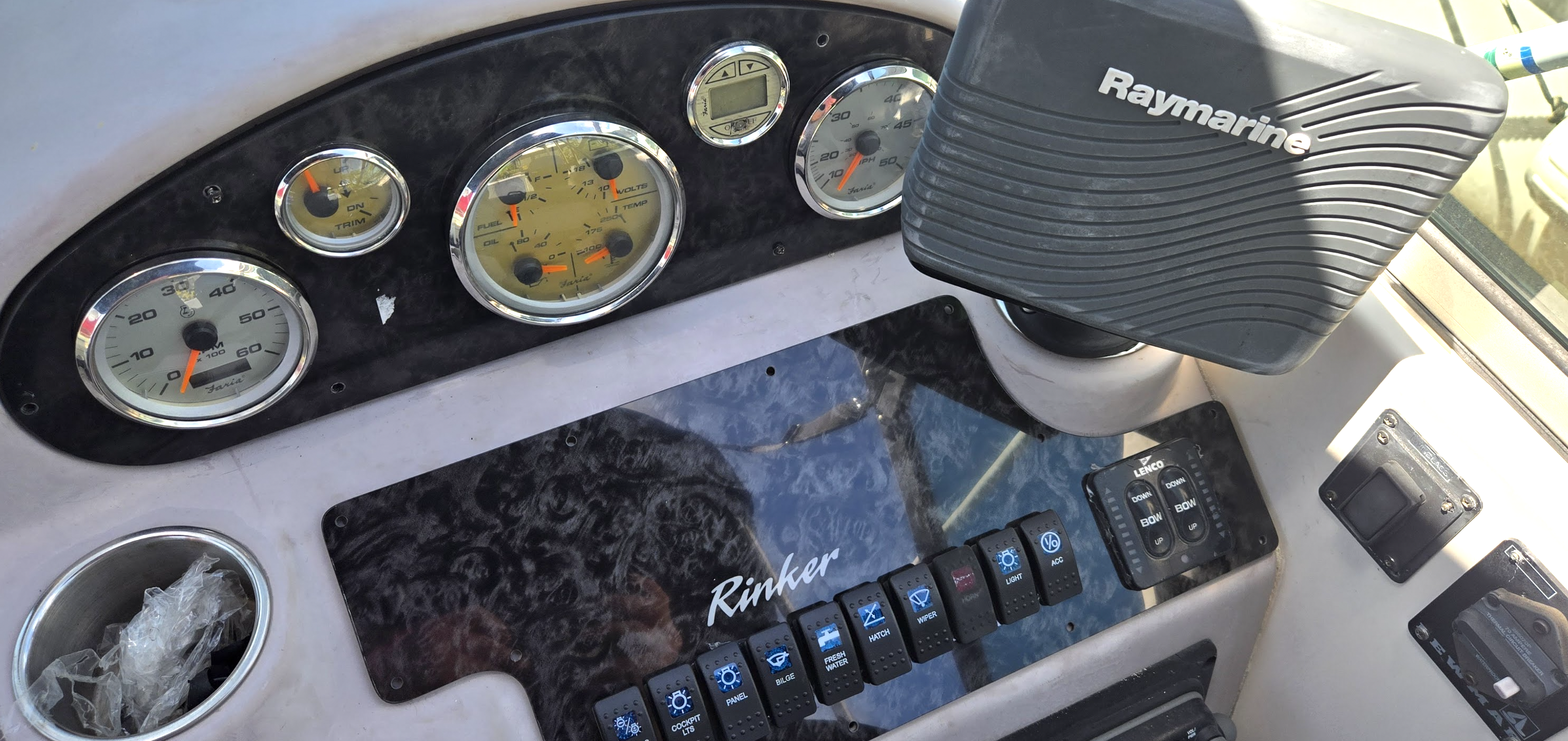

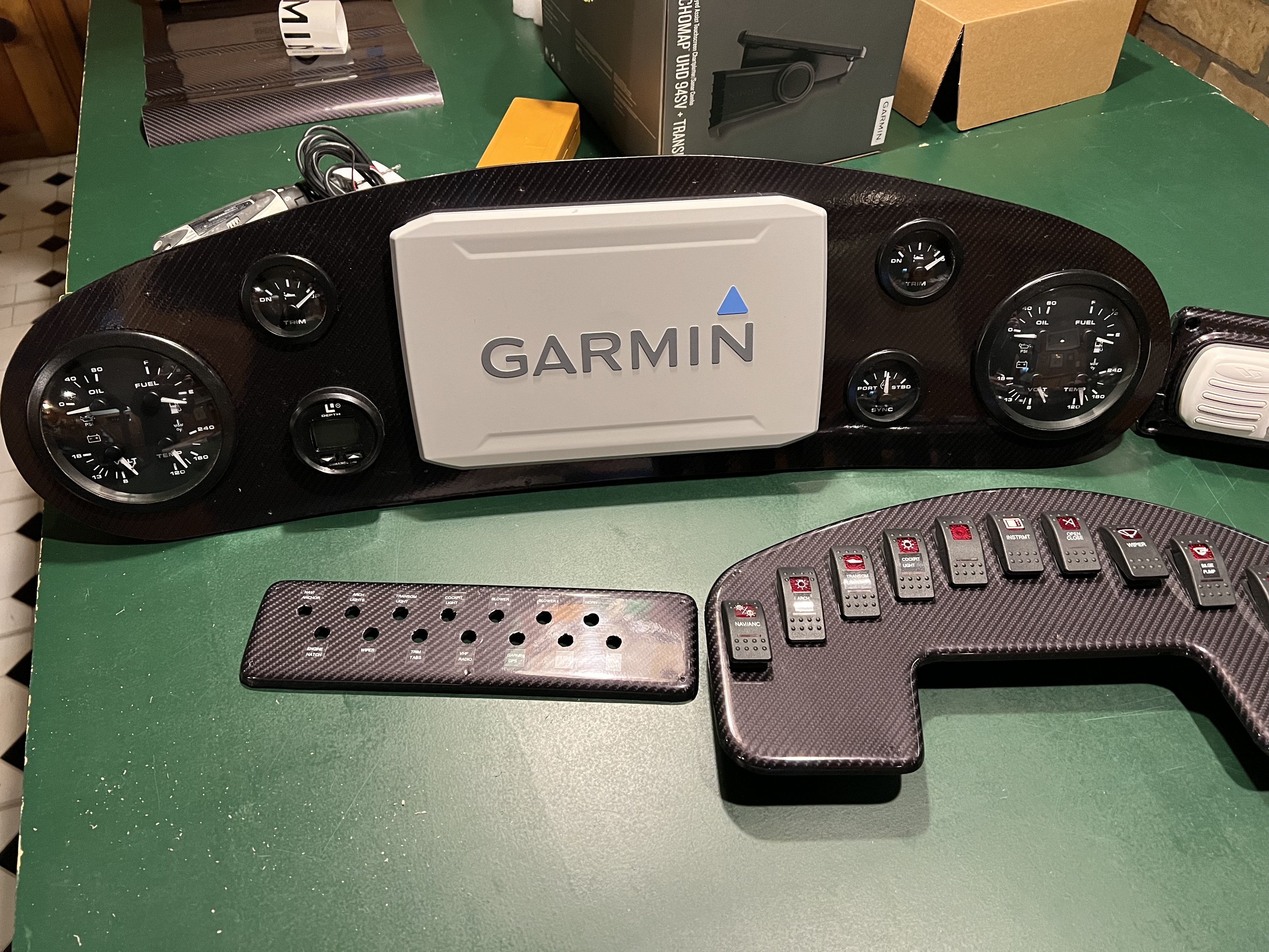

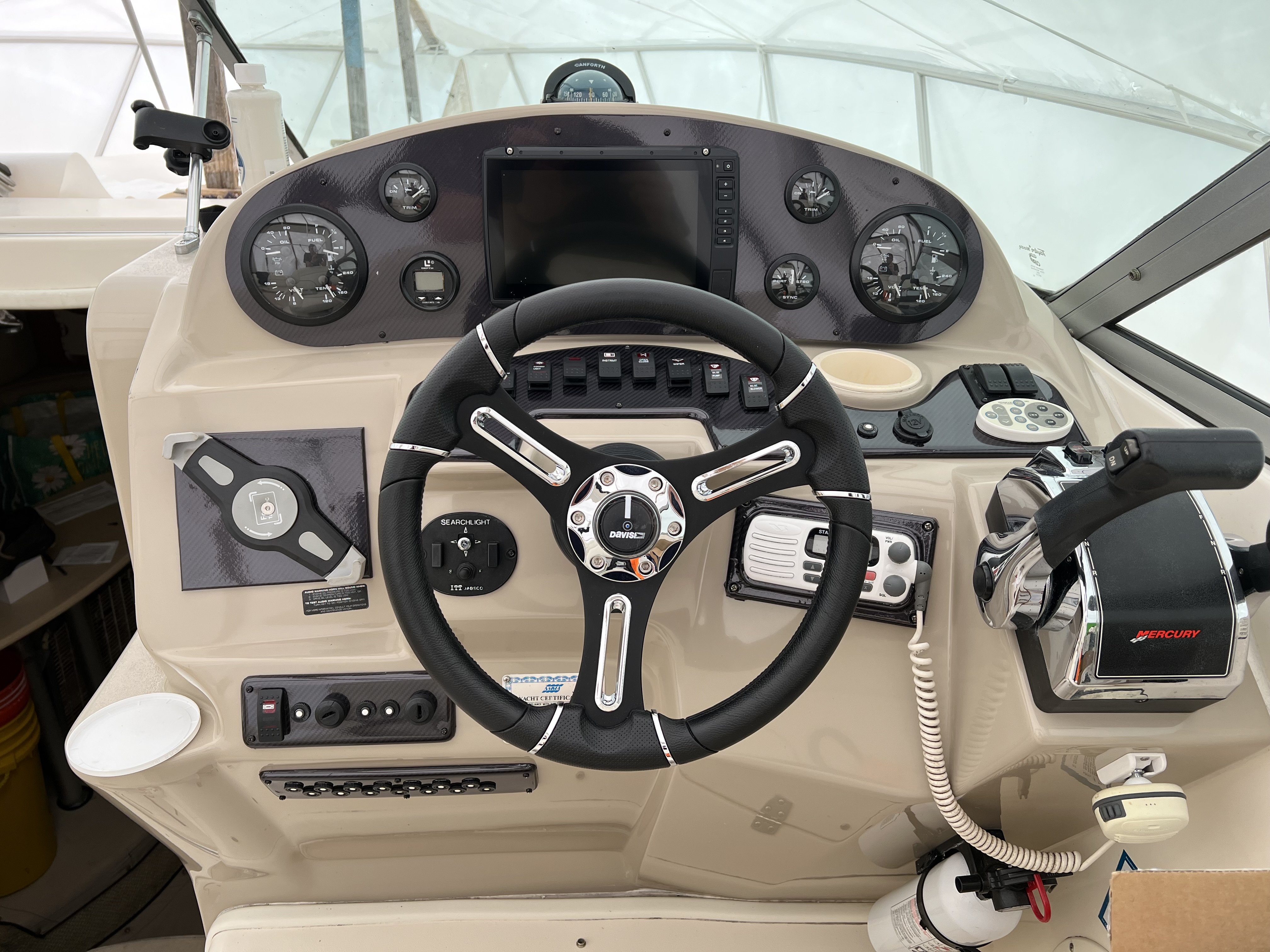

LIttle hiccup with the breaker panel and still needs some work to finish it off, but it's noon in the keys, work stopped for the day.. main problem is now I need to buy new gauges to get rid of the yellow and everything else around it looks old and in need of replacement lol.

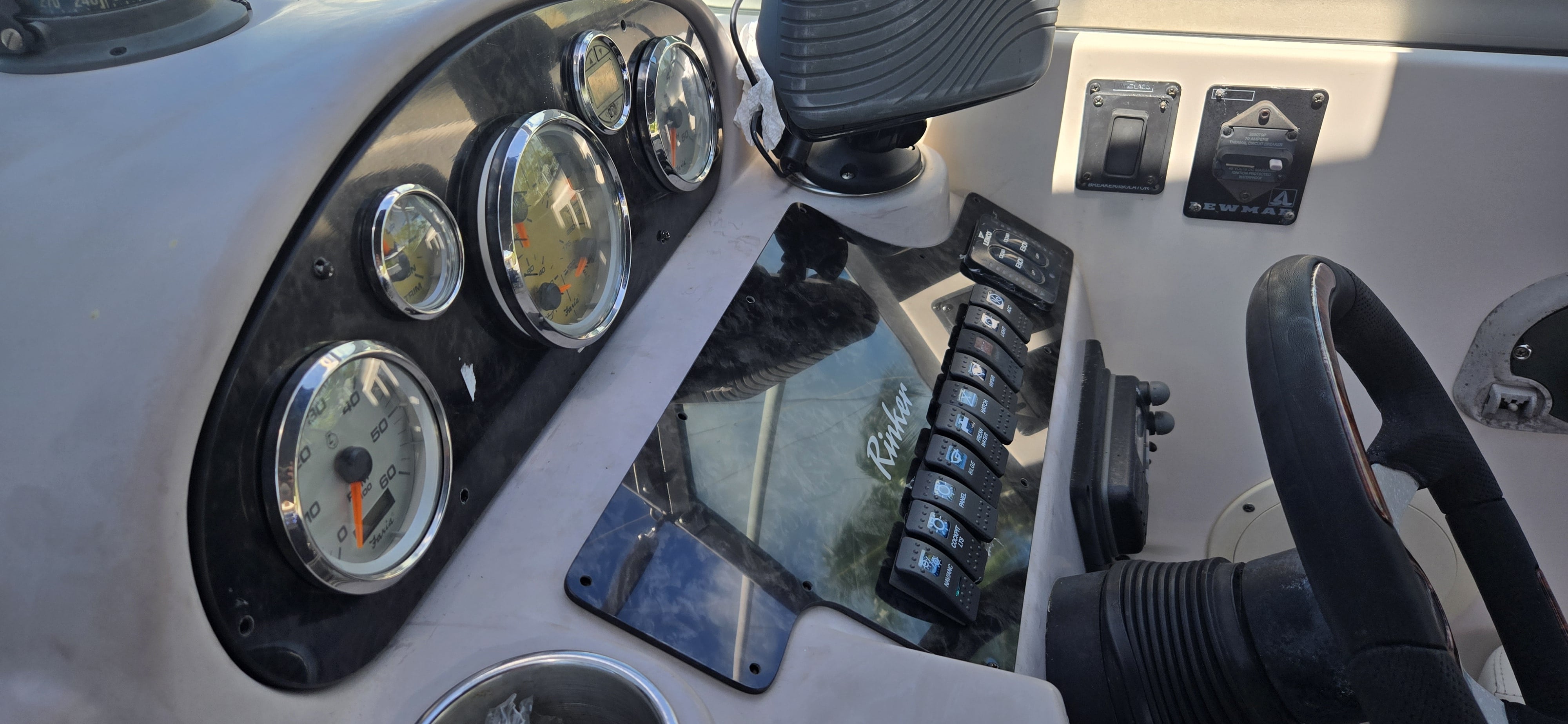

    I replaced, or had to replace , my gauge panel and found what must be the last oem @ GLS. I need to replace my switch panel also...figured I'd stumble across one..where are these from?

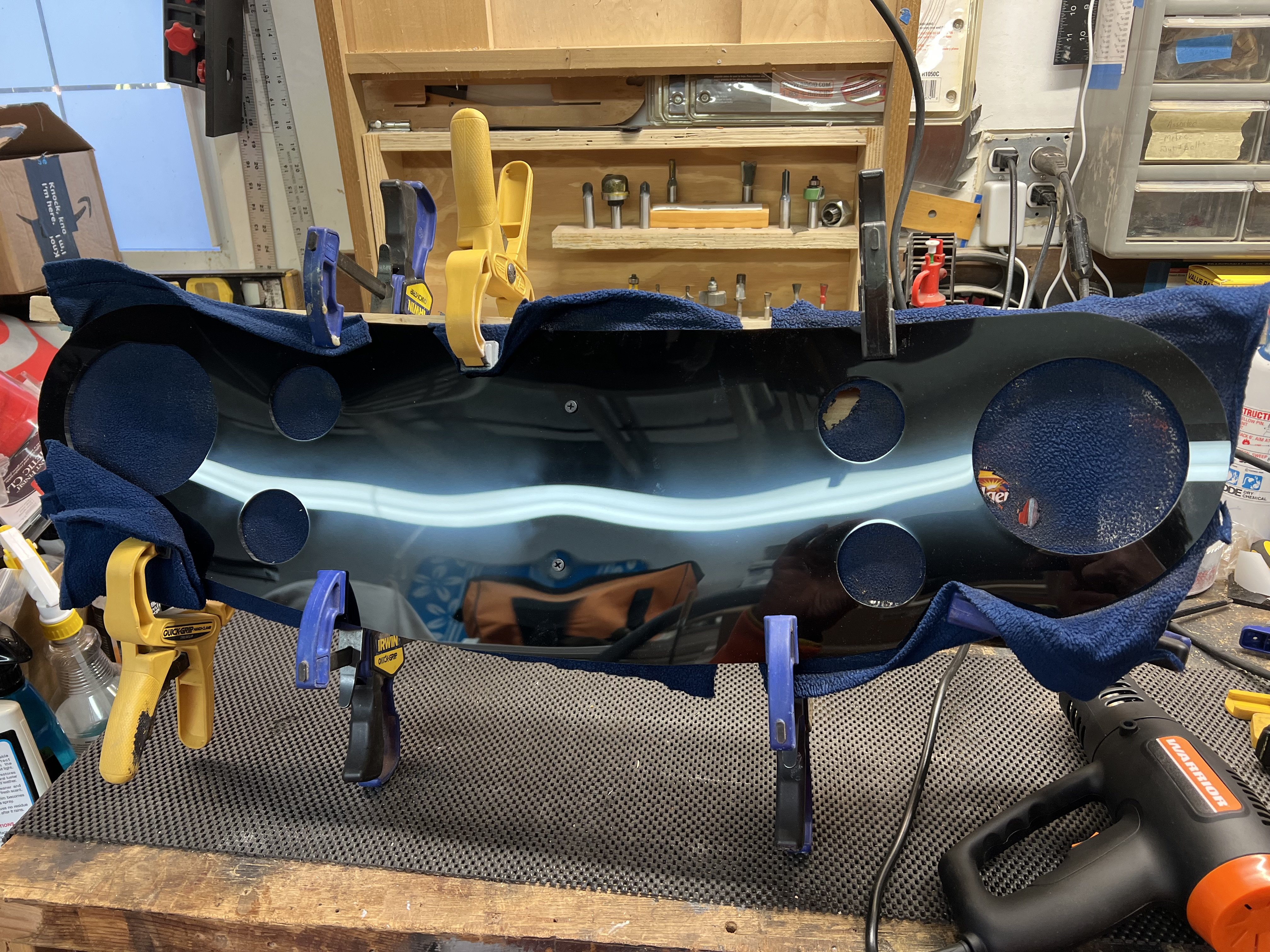

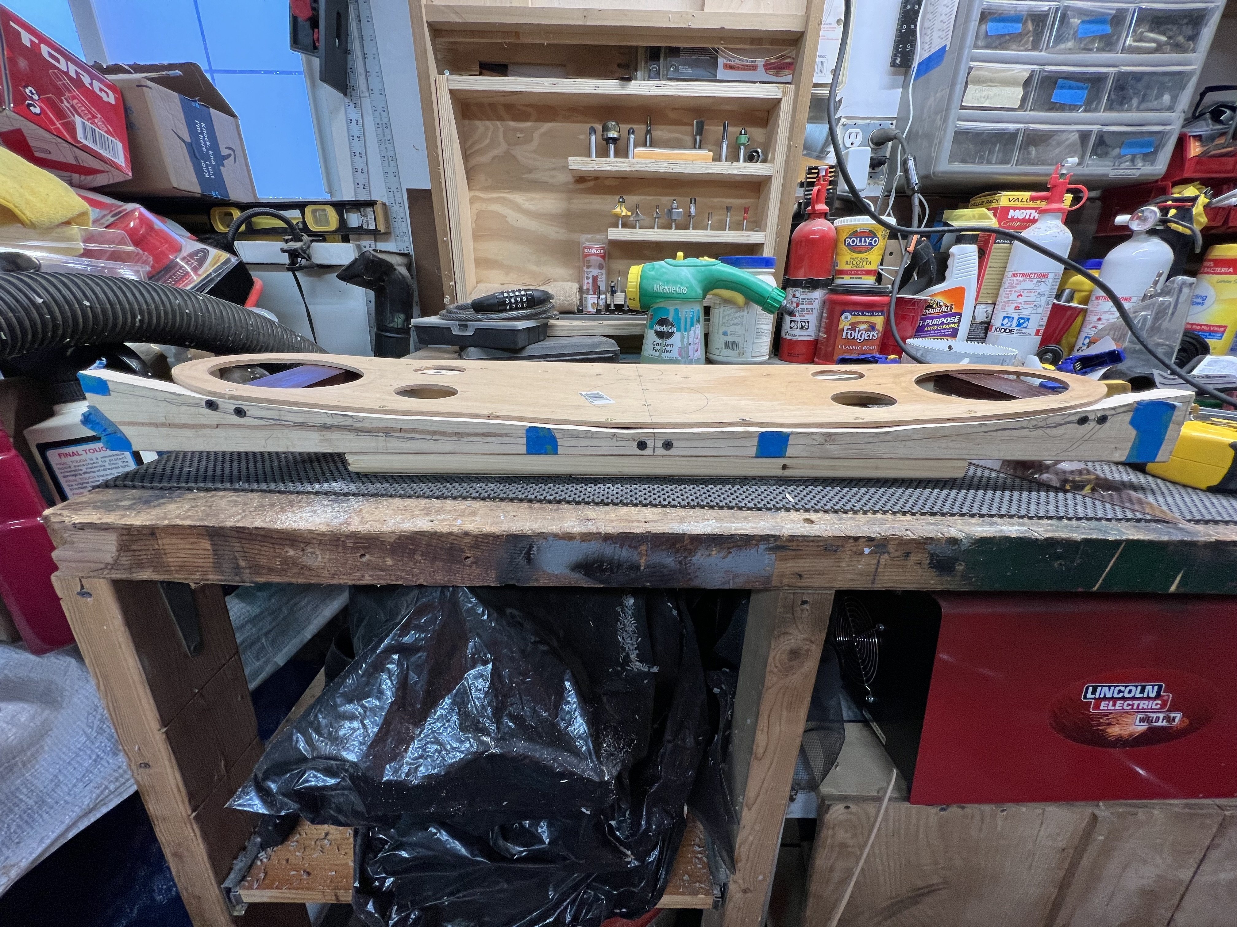

    @J3ff i redid mine a few years ago. I vinyl wrapped some of the existing panels but the main gauge panel I wanted to change the configuration. If you are keeping the gauges the same and your old panels are intact you can look into hydro dipping them. Google it. Here are some pics of mineI made a wood form to match the shape of the old dash and heated a piece of acrylic then vinyl wrapped all the panels. I used a cheap label maker to label the breakers using a clear tape with white lettering. Maybe you can warm the panel they sent you to get it to fit ?  Just be aware the heat gun did make the acrylic blush a bit so i needed to vinyl wrap that as well

    I bought them already LOL - and installed them. That's not great that you can't tell lol  :D
    On a side note FPmarine.com responded both on Saturday and Sunday, I'm impressed! They offered to swap the fuse panel to one with the correct holes/labels. I've never seen a business respond over the weekend, especially when it's a boat business and a holiday weekend. A+ for customer service.
