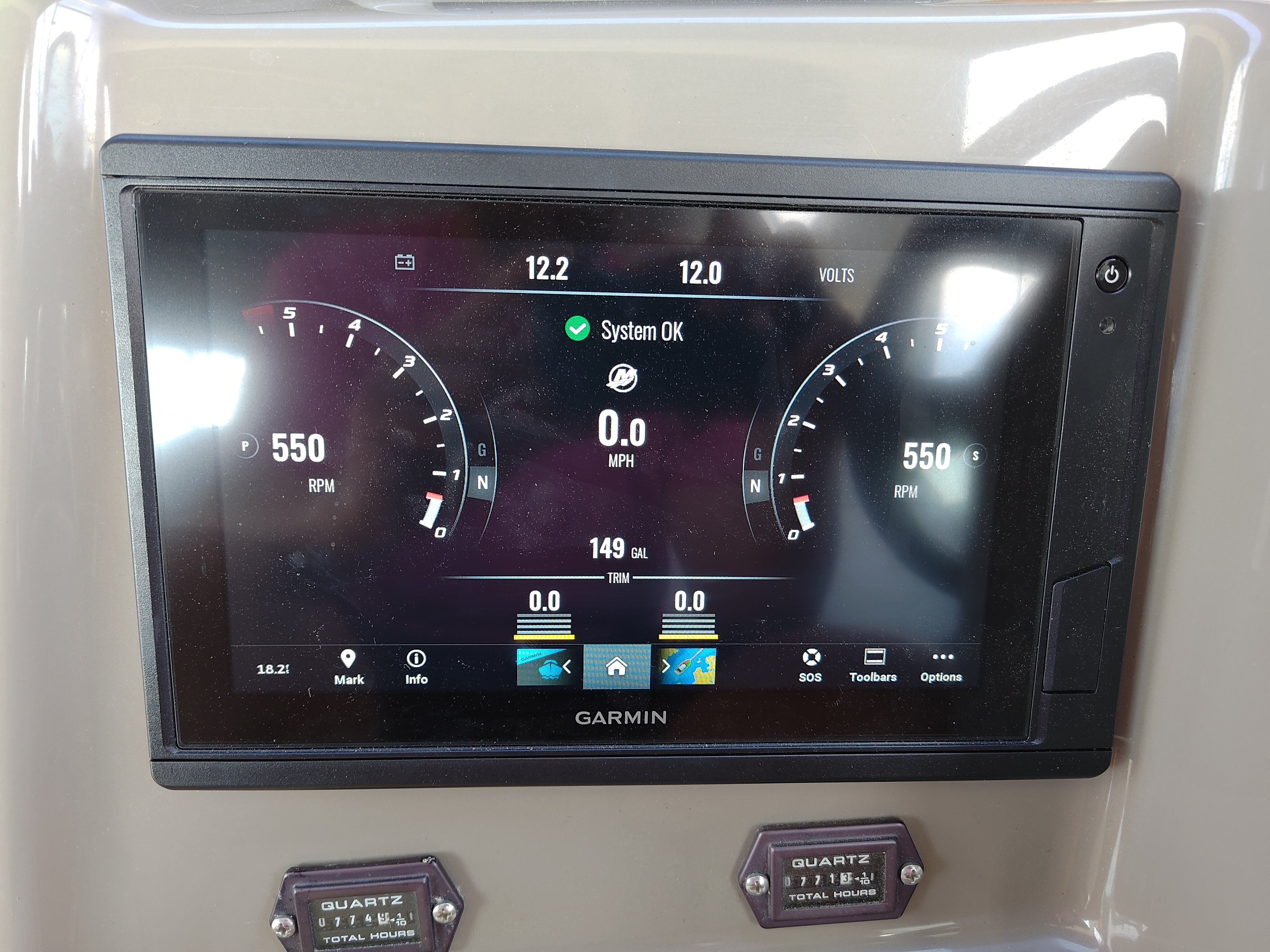

    Just to close the loop on this, today I swapped my IAC on the starboard engine and both motors idle dead-nuts-on at 550 now.
