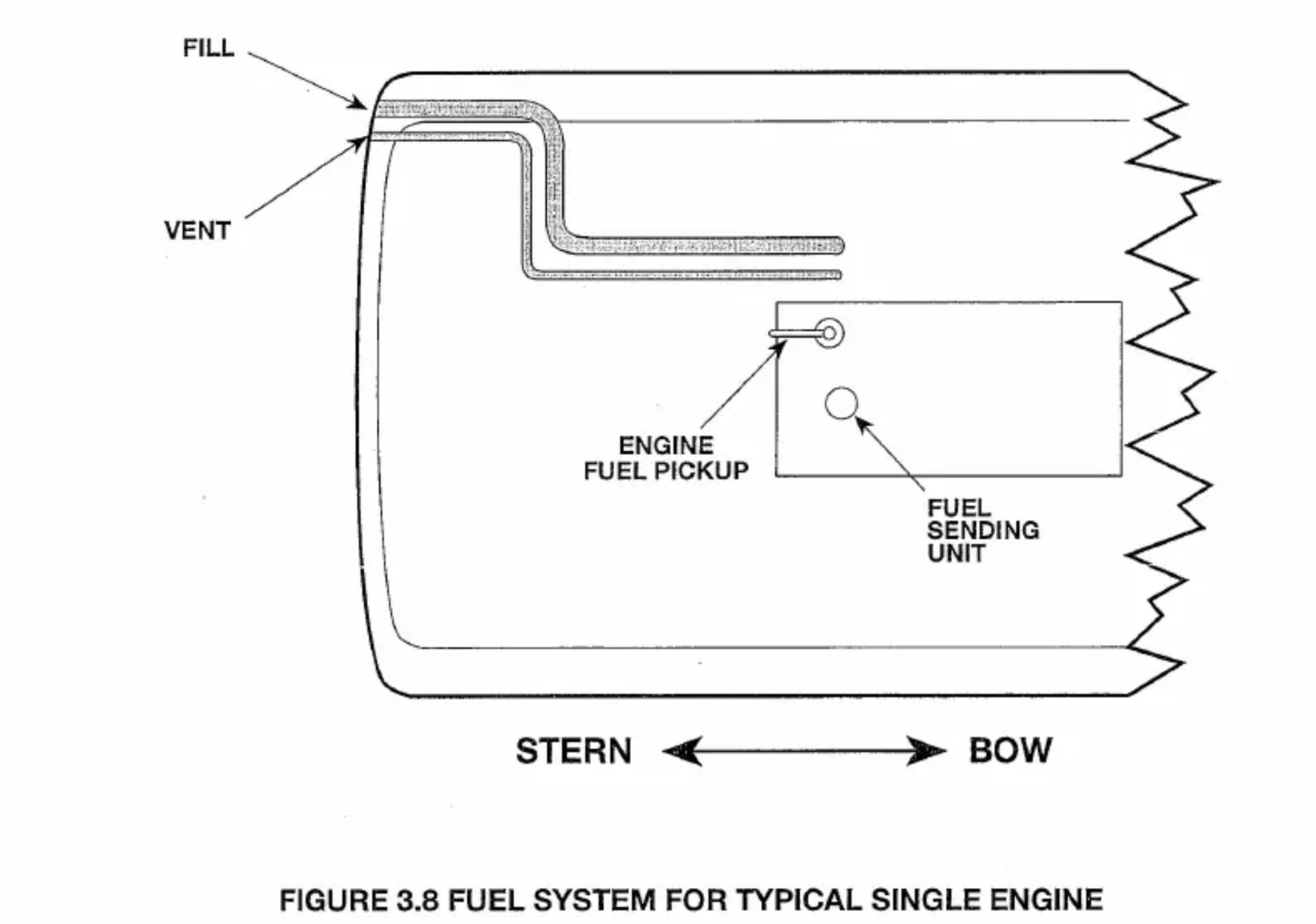

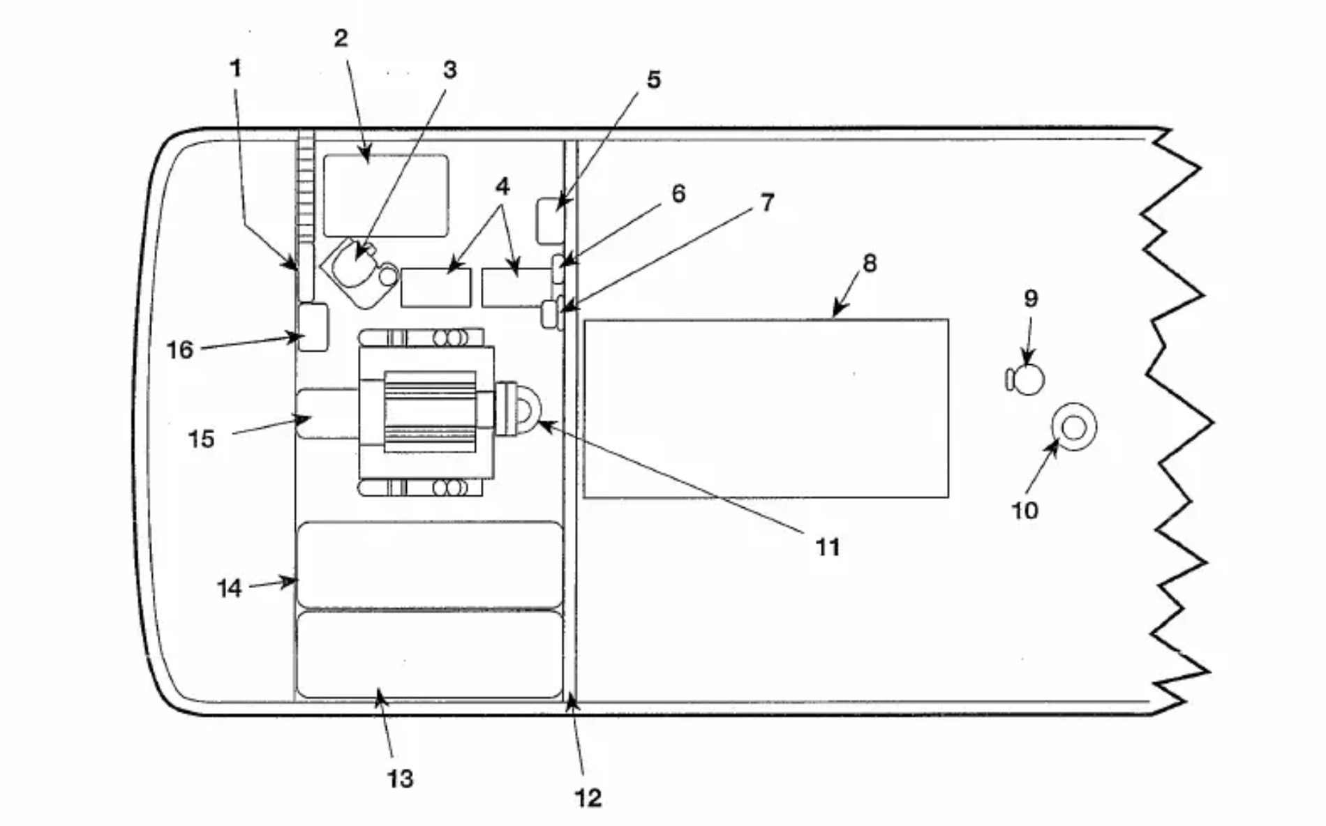

We have a glued carpet in the kids bedroom, hence difficult to locate the inspection hatches for the fuel tank. No 10 in the below figure seems to be the squared recess from where the smell is strongest - but no leaks or lose connections found here.
Anyone knowing where I can find them in our Rinker 250 Fiesta Vee?
I have founded the below schematic drawing, but nothing more precise
