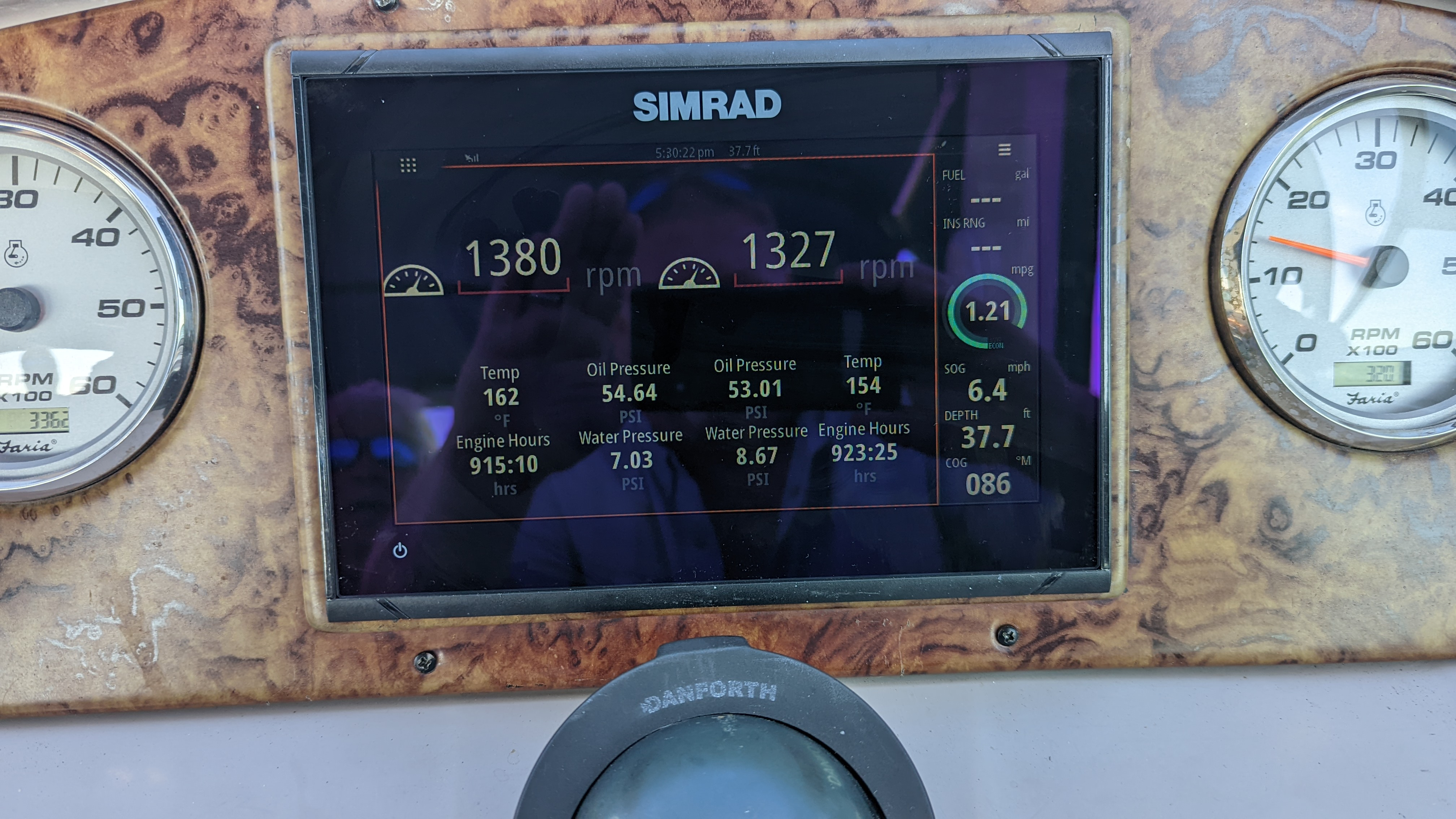

Wiring up my Twin Fox Marine's MEFI Engine Gateways to my nema bus next weekend to get the engine data to my chart plotter.
I have the Volvo Pentas now. I had my Mercruisers all connected and able to display engine data.
  • tricountytrailtricountytrail Member Posts: 262 ✭✭
    It's really nice having the digital data. I had it setup on my 280 with a single Volvo to my Garmin. I used yacht devices for my gateway connection, plug and play.
    Just got a deal on twin ones already set for master slave for MEFI 4

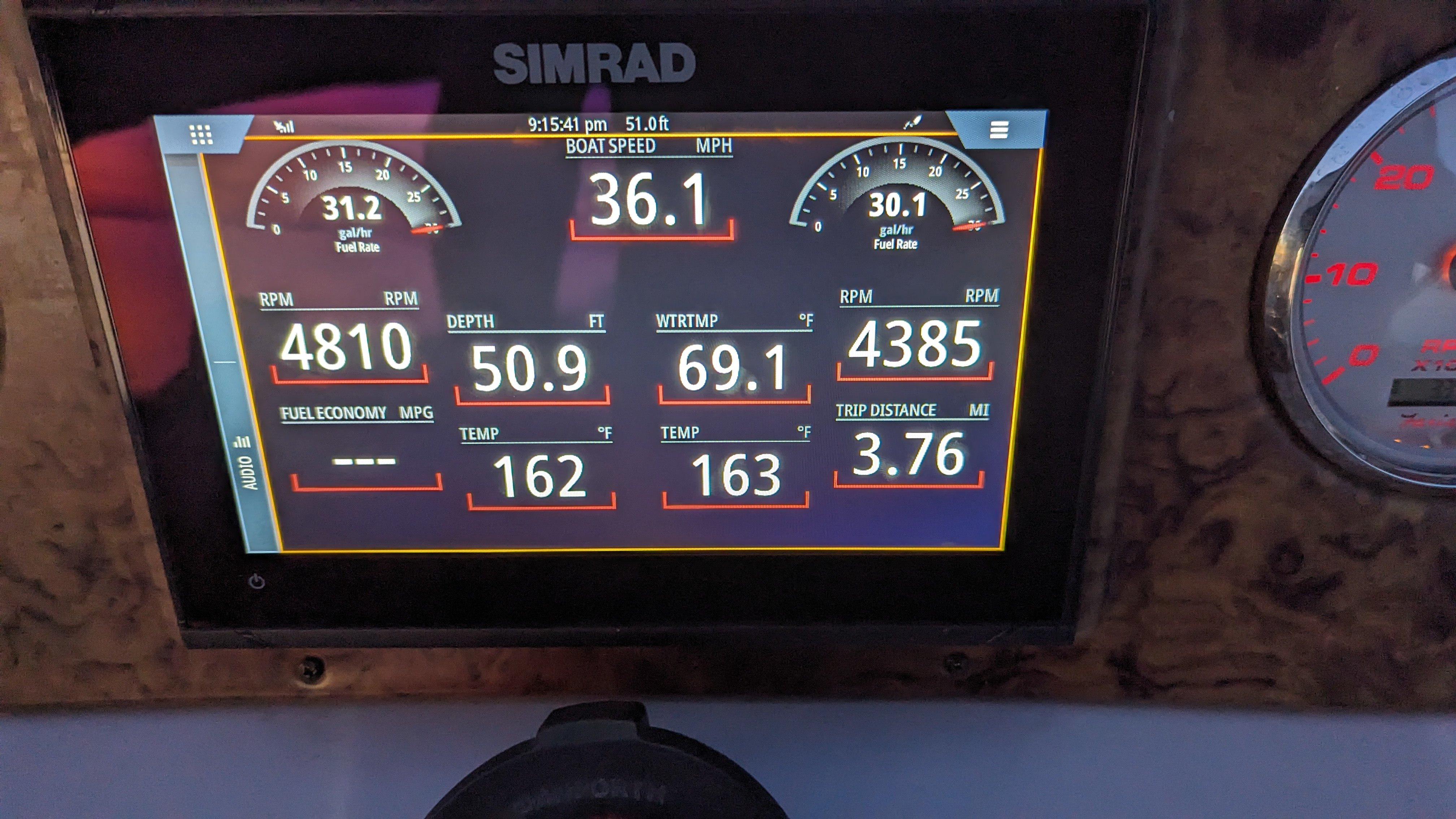

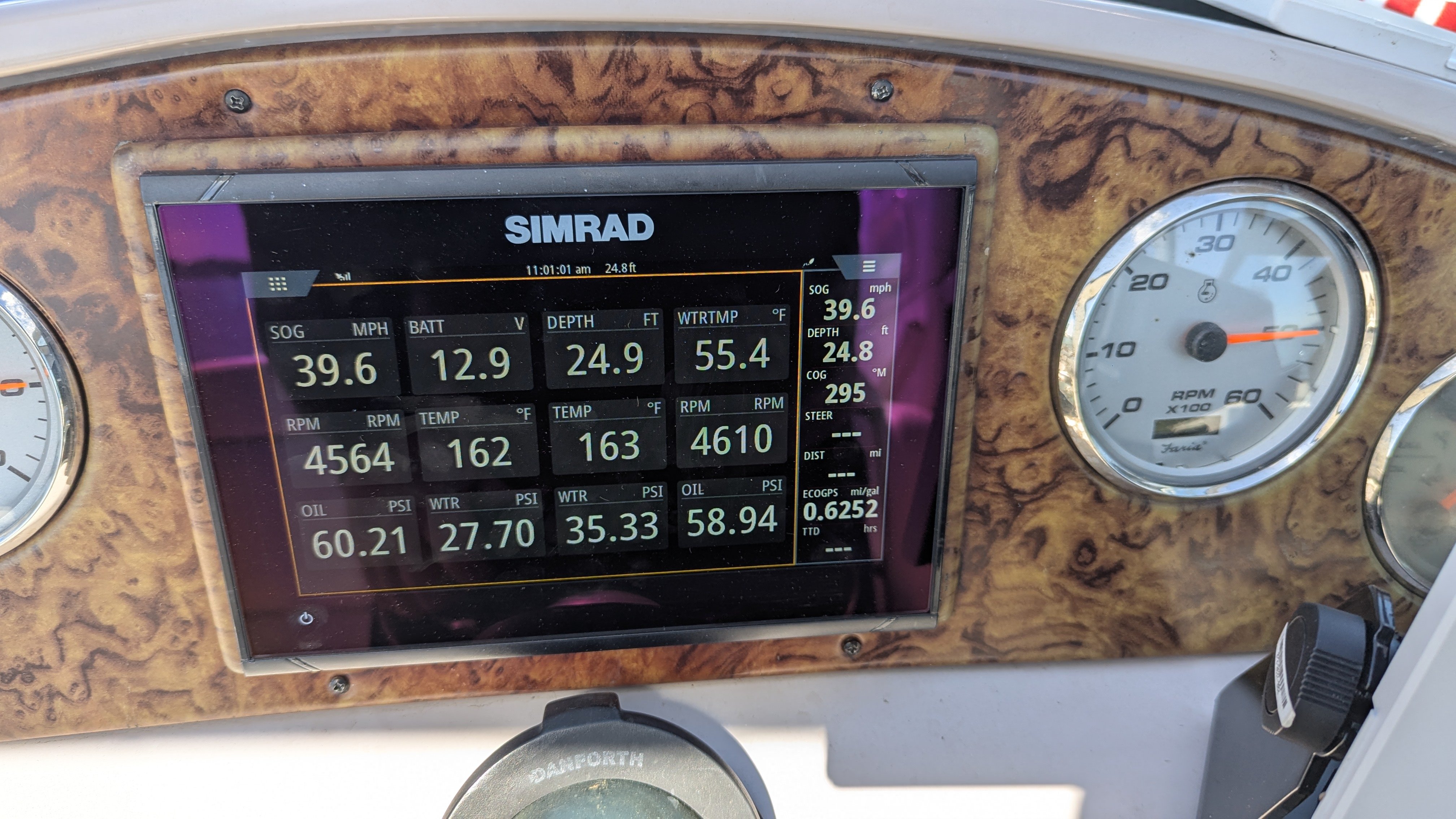

  • YYZRCYYZRC Member Posts: 5,605 ✭✭✭✭✭
    Wow she's thirsty when she's moving fast!
    Shes a BIG Girl!!!
    4/28/2025 Old Rinker Mag 496 bravo 3 2.0 drives 1 person half fuel and water water temp 52 degrees
    4 MPH 650 RPM 2.5GPH =1.6 MPG 8 People                        actual numbers
    8.5 MPH 1650 RPM  =1.1  MPG
    26 MPH 2500 RPM  =.78  MPG
    31.3 MPH 3775 RPM  =.78  MPG
    34.3 MPH 4050 RPM  =.71  MPG
    36.2 MPH 4250 RPM  =.66  MPG
    40.4 MPH 4650 RPM  =.62  MPG
