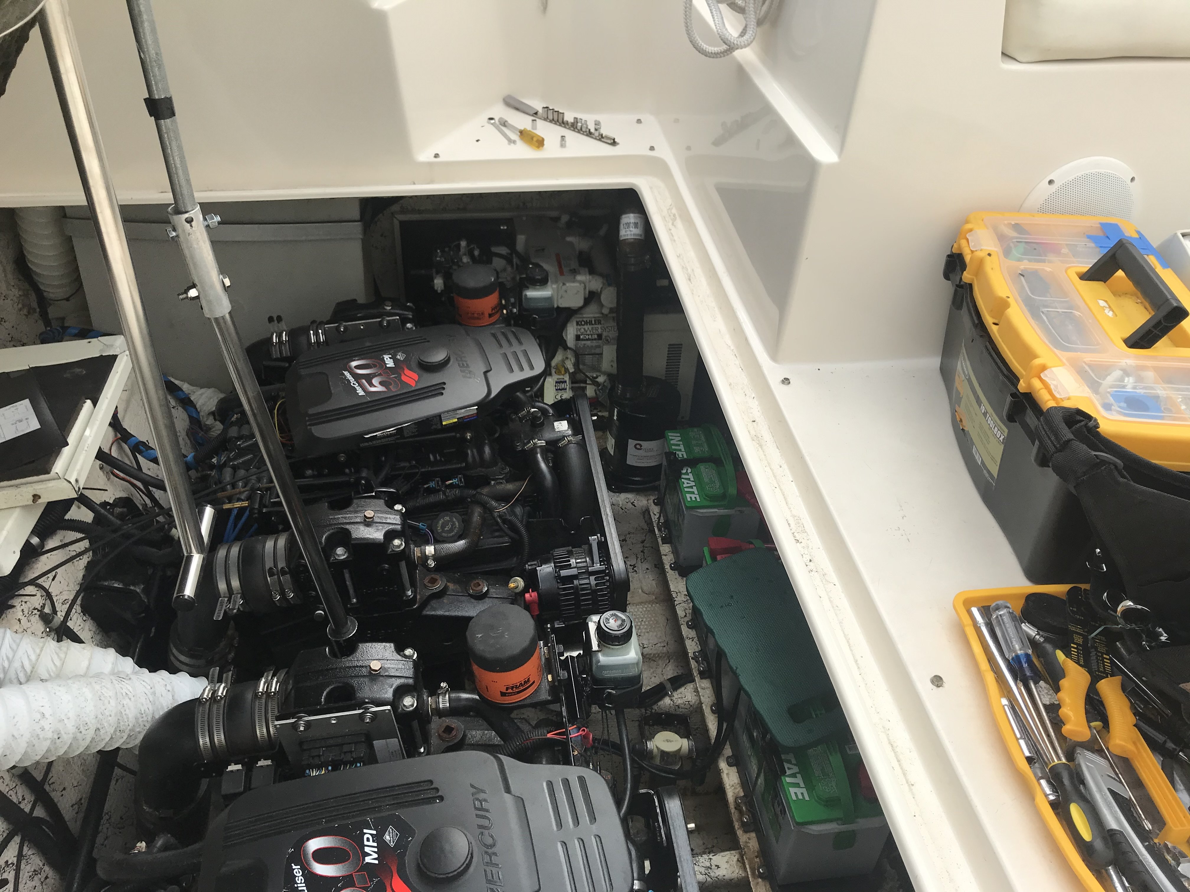

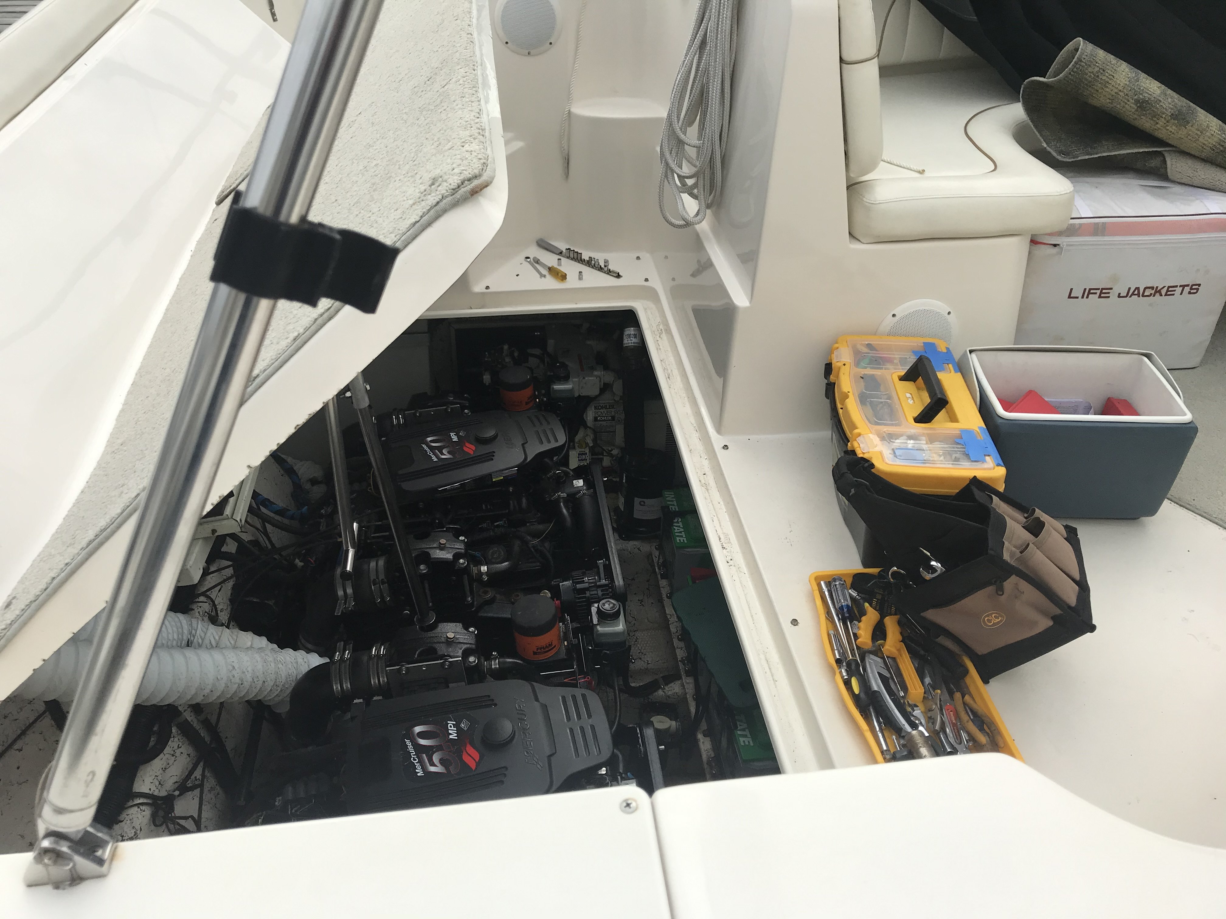

    On my 310 i made an extension out of a piece of electrical conduit. I set the hatch on the safety kick stand (you can make one out of wood if your boat doesn’t have one). I the retract the actuator and add the extension to allow the hatch to open much further.  You see the extra piece with the black tape. Makes it much easier to work in there.
