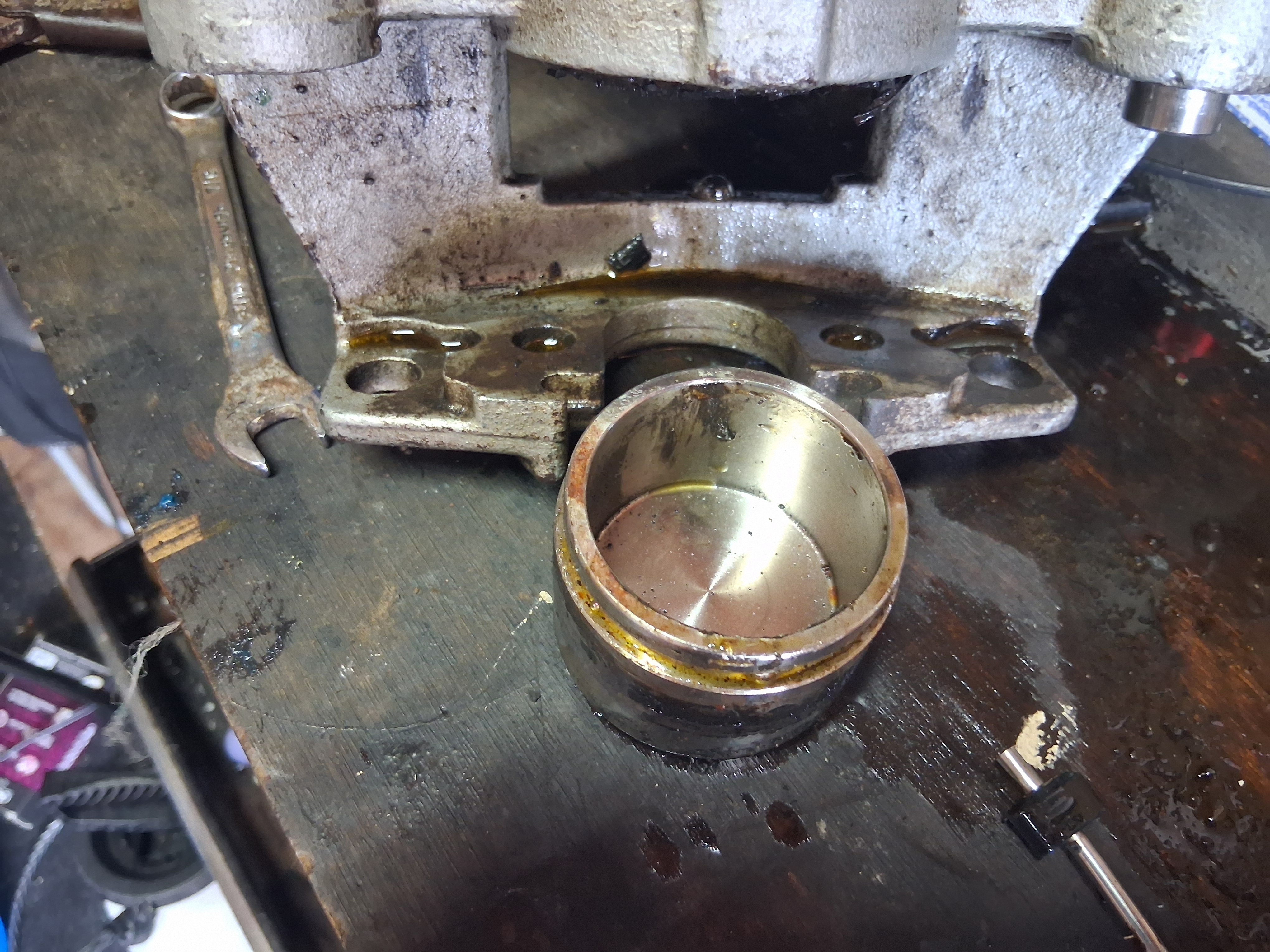

    I'm trying to get the frozen caliper apart. The piston being stainless,  I'm not understanding corrosion being the issue. I dont recall what the clearance is between the bore and the cylinder..i assumed that with the brake pads badly worn the piston got misaligned and once I got it straight it would come out. I have a small pancake compressor but I can't really get much pressure in it unless I can find a fitting I can screw in and put my compressor hose on it- otherwise I dont see a way to build any pressure.  I have wd40 soaking in the bore..any ideas? A rebuild kit is 80 bucks. 100 bucks cheaper than new x 4 seems silly as its just a casting...

    @PickleRick- if there is corrosion in the bore what does that really effect? The bore and the piston never touch.  If the piston has corrosion I can see it tearing up the seal in the bore and leaking...there was no evidence of any leaking from any of them...
    edited September 16
    The center bore of the caliper is a cylinder.   The piston moves up and down in middle of the cylinder.  Fluid pressure inside the cylinder pushes the piston outward towads the brake rotor.
    There is a seal on the piston. There's also an outer dust boot.  Without a clean smooth mating surface fluid and pressure will pass by the seals instead of properly braking.

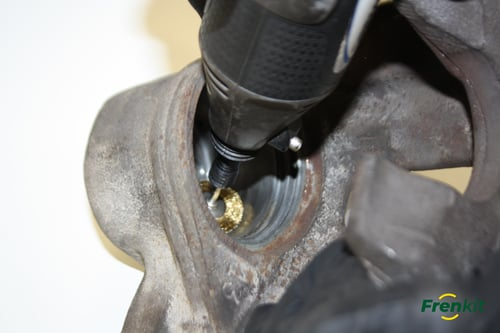

    They make cute little cylinder hones to help clean the mating surface area of the brake caliper.
    Good for small imperfections or debris clean up to get a smooth surface.

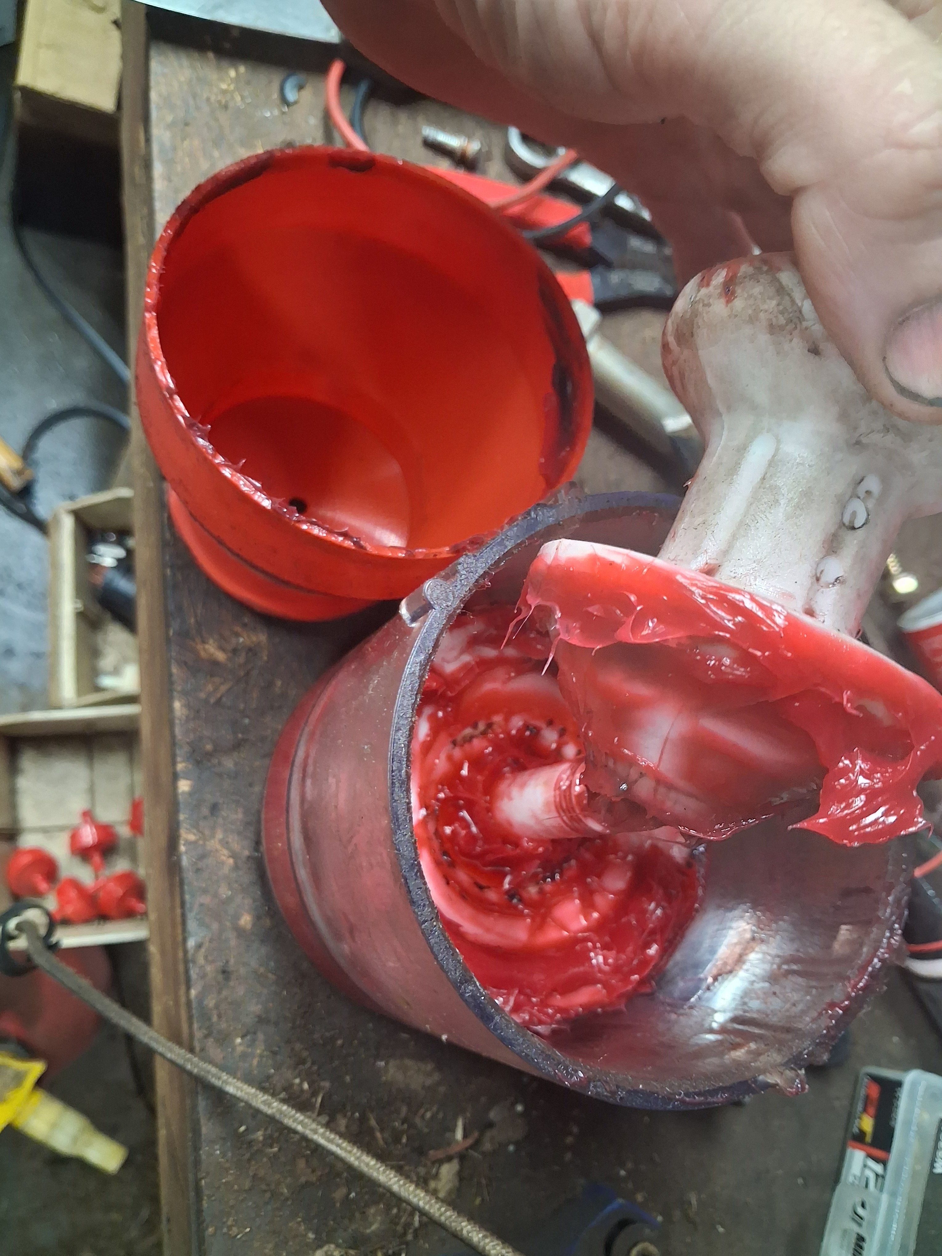

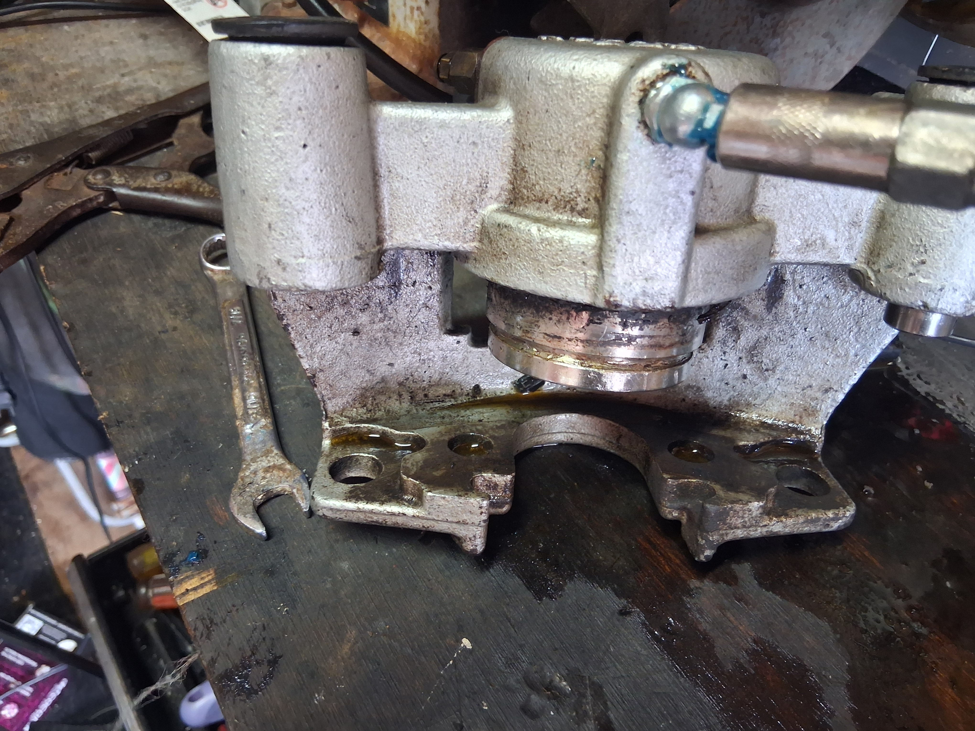

    Check this out...can't wait to try it but it's my wife's bd....this is from chat gbt....i really have not had a good way to build any air pressure on it  to shoot that piston out- so, I asked my buddy Chat GBT. The first recommended method after air was to hook back up to the trailer and use the boat hydraulics to push it out. I don't have option.Next was the following I never would have thought of in a million years....I've worked in a machine shop where we made mini punch presses will air ladders and die sets- I know air can be very powerful..
    If the trailer hydraulics aren't convenient, use a grease gun. This is one of the best tricks for a truly frozen piston. You need an adapter that lets you connect a hand grease gun to the caliper's brake-hose inlet or bleeder opening. Pumping grease into the fluid chamber develops thousands of PSI, but unlike compressed air, there's very little stored energy. The piston normally creeps out rather than becoming a projectile.
    No I'll hit ace hardware am and see if this works!
  • rasburyrasbury Member Posts: 9,015 ✭✭✭✭✭
    I did this...and it worked incredibly easy. The piston is pitted. I have a kit I ordered so will install those parts. I did not notice, the SS the slides pins go in were not new in the kit: the rubber they go in is..
