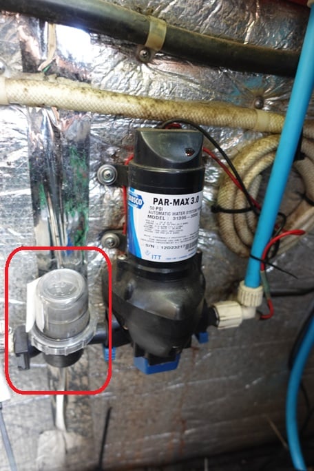

    Check the strainer between the tank and the pump. Mine has a clear cover and I can see if there is air or water in there. If mine has air, I can crack the cover open to let the air out and prime it.
  • grouch0jrgrouch0jr Member Posts: 259 ✭✭✭
    Here's what mine looks like.

    Is that filter  set up upside down? Recent replacement or service? Are any of the lines sucking air or leaking? You can undo the outlet side fitting and see if its pushing water...if water has sat in the tank you may have crud in there blocking the line. I'd see if the pump is pulling water, I'd flip that filter around as I would suspect that may be your air pocket...its a pretty simple system. If you see its not pulling water you could undo the other side and stick tge hose in a bucket of water.

    Yw..I hoped someone else would chime in on the filter set up. I know mine is pointing down but maybe you have something different going on...
  • IanIan Member Posts: 3,075 ✭✭✭✭✭
    I agree, I think it’s upside down. If I recall all of mine are glass down so you can take off and clean out. Like that any sediment drops into the bottom - the intake.

    And it probably would create an air trap. If that is tge problem, how'd it ever work?
    That picture is my filter, not from OP. It's never given me any problems.
  • PickleRickPickleRick Member Posts: 4,400 ✭✭✭✭✭
    You won't habe a pressure issue but it wont exactly be filtering at 100% efficiency.
    Any crap in the system should drop to the bottom of the cup for easy disposal.  Yours just piles up in the housing.
  • raybo3raybo3 Administrator Posts: 5,619 admin
    Mine is bowl up just like the picture and never a problem unless its dirty. Just say'n
