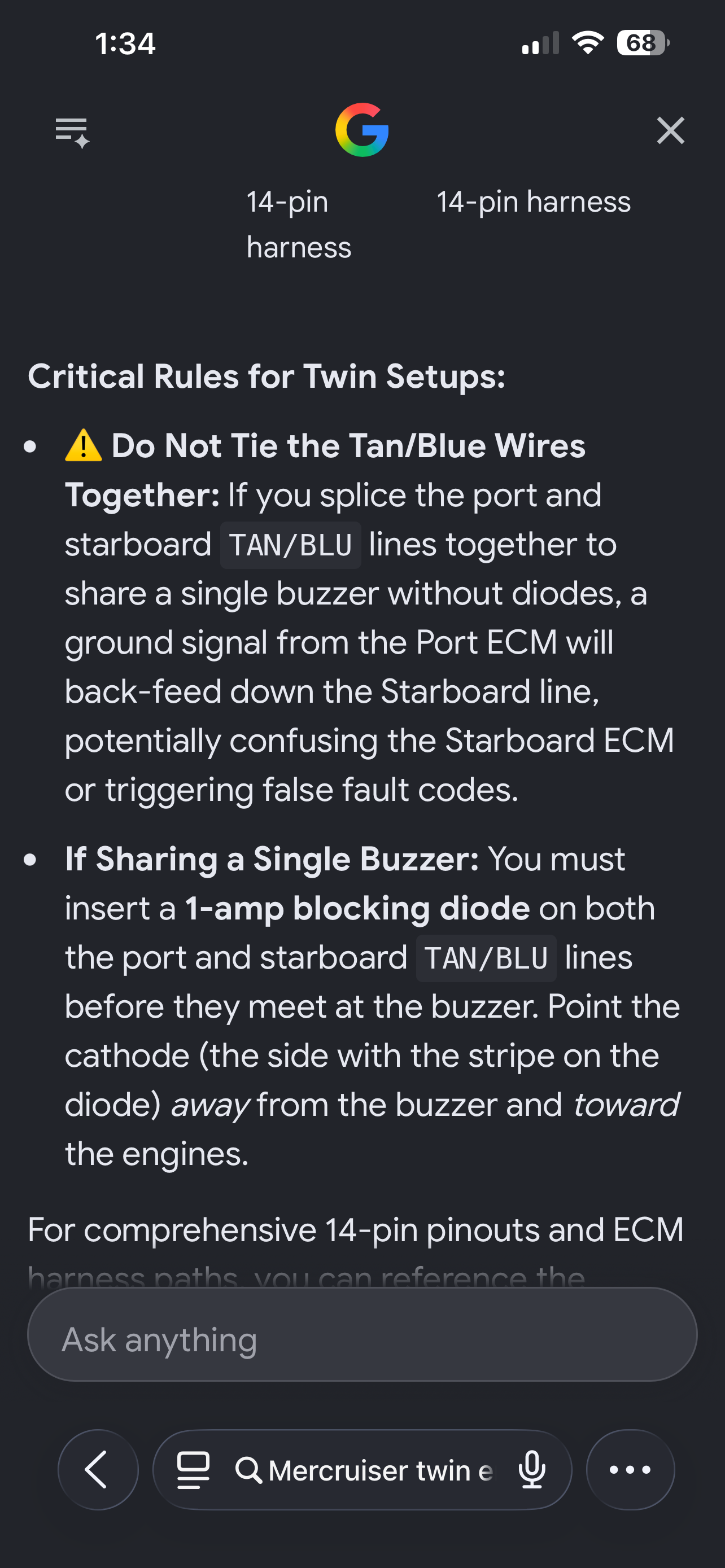

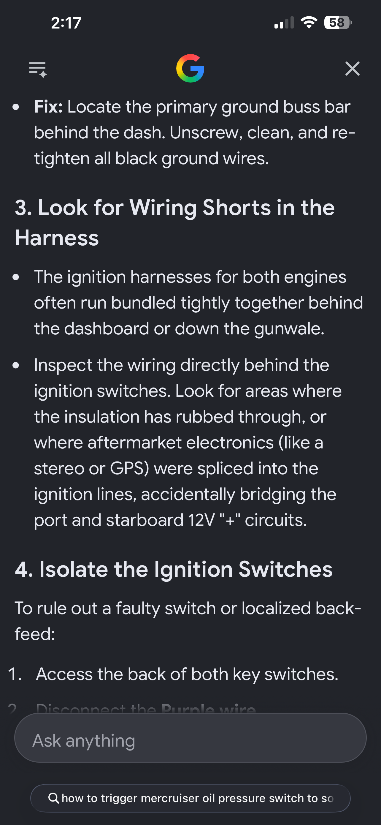

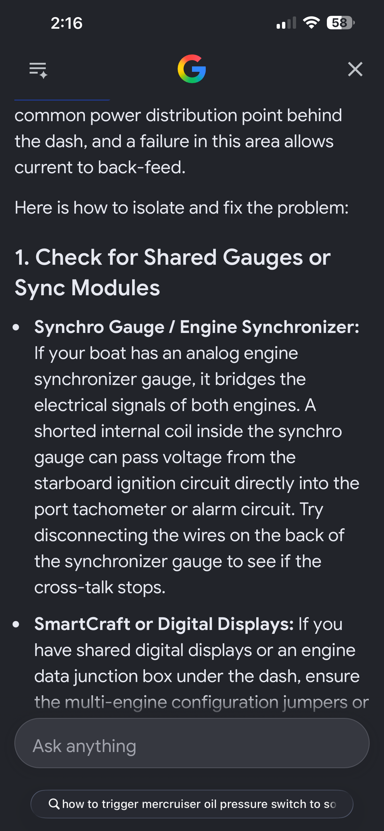

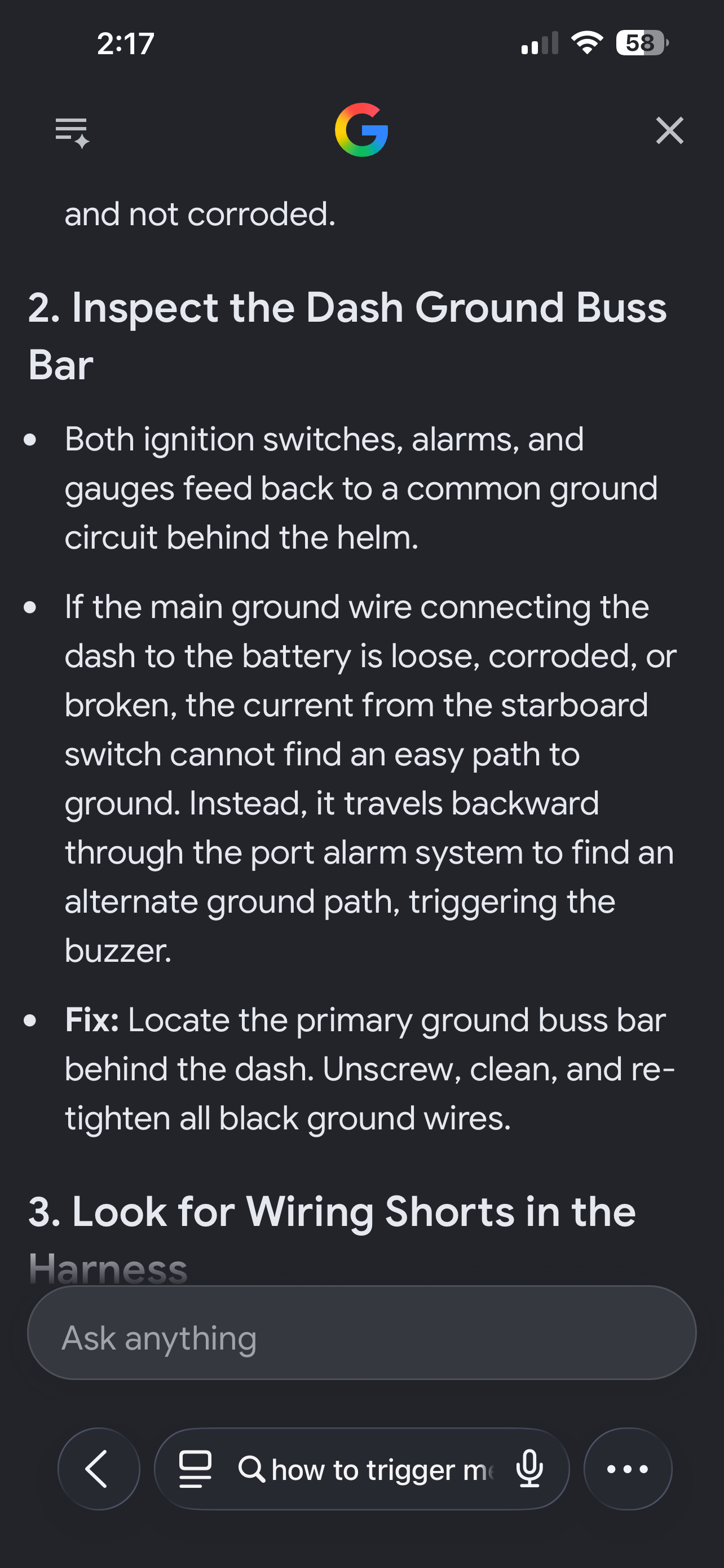

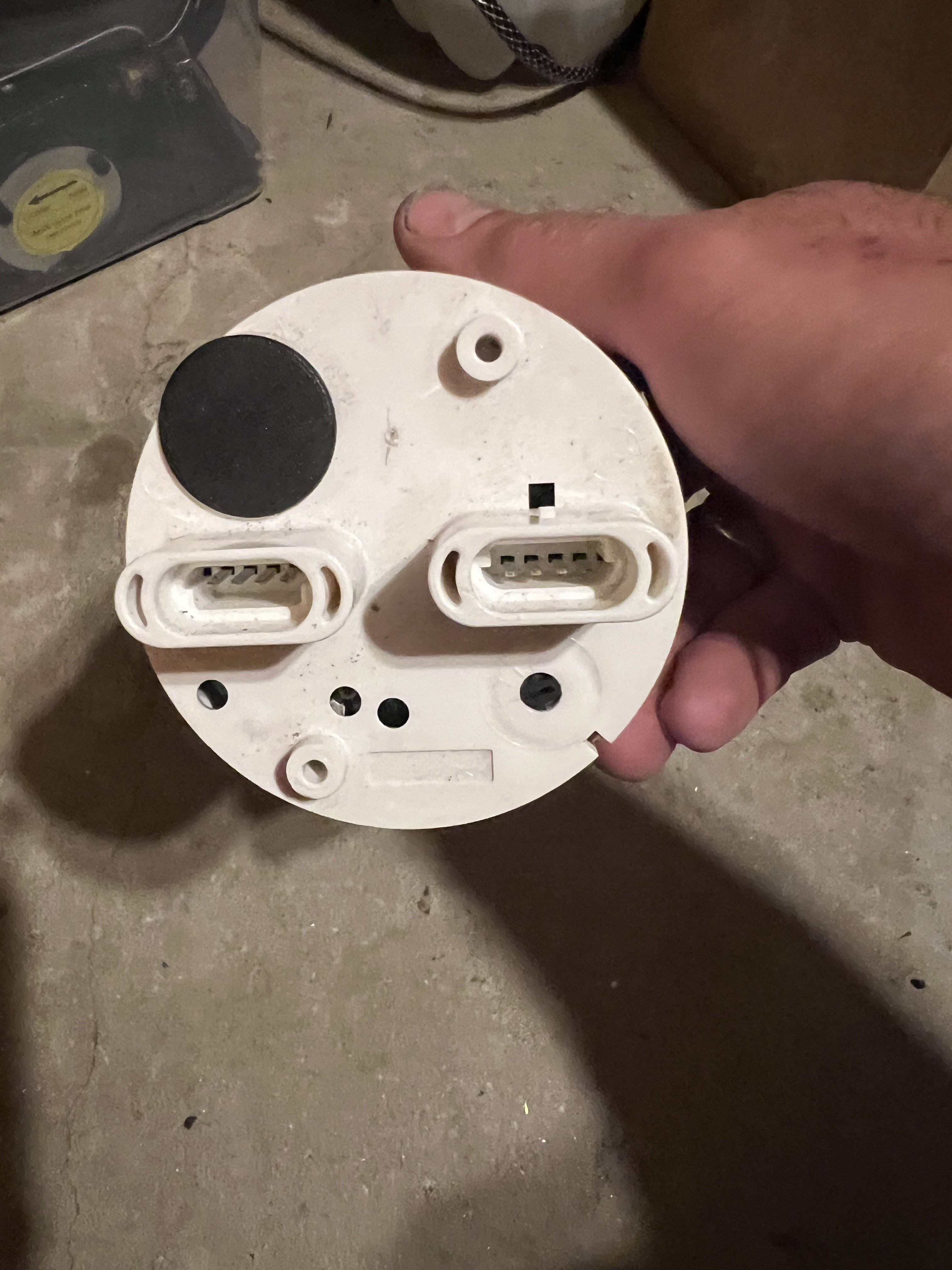

As mentioned in my other post, my port engine warning alarm will only sound when the starboard key is on. I was doing some research today and read this below. It’s possible that Rinker only installed one buzzer and it’s spliced to both engines. If they installed diodes at each wire, one can be bad.
  • aero3113aero3113 Member Posts: 10,101 ✭✭✭✭✭
    edited October 7

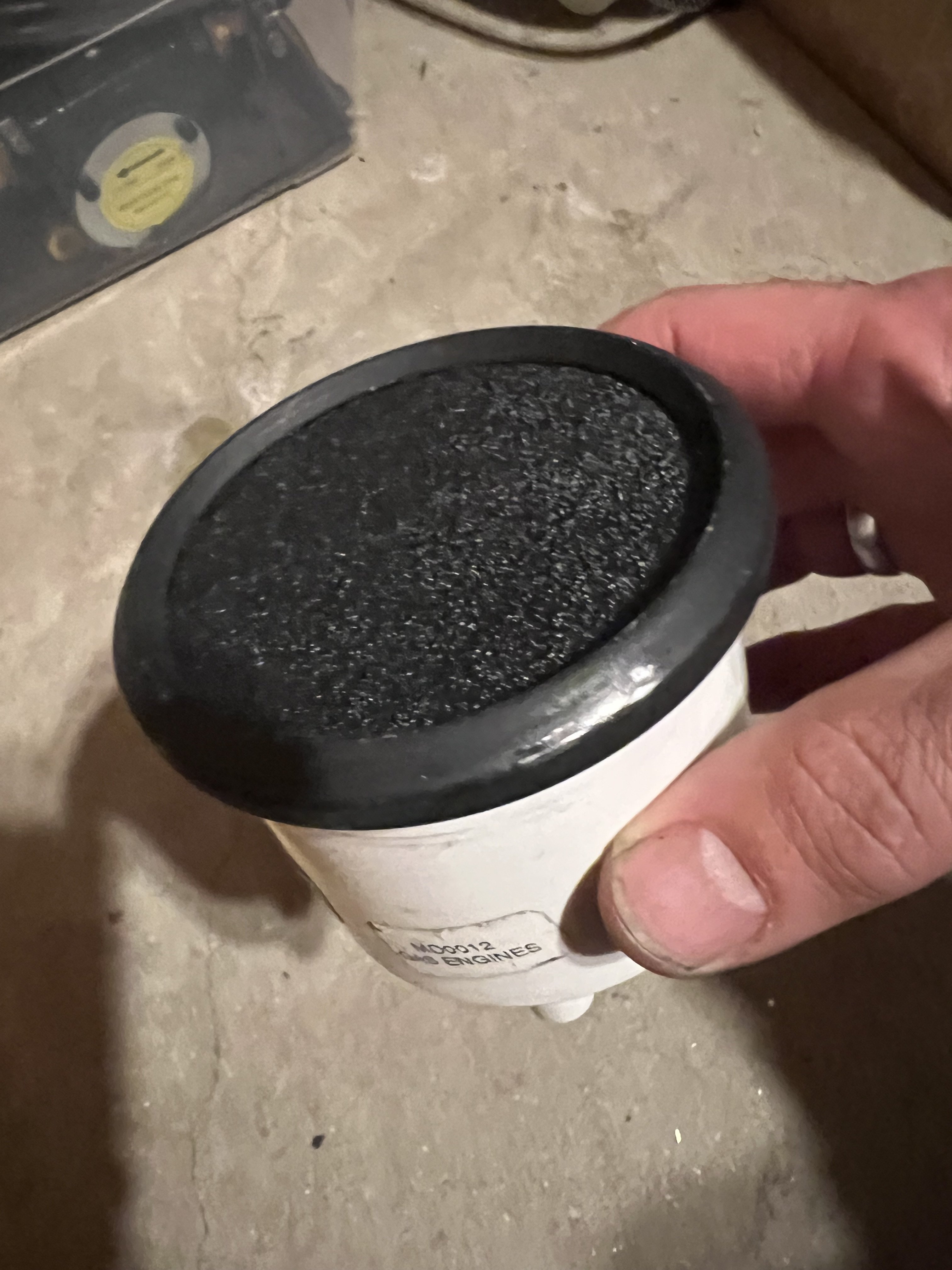

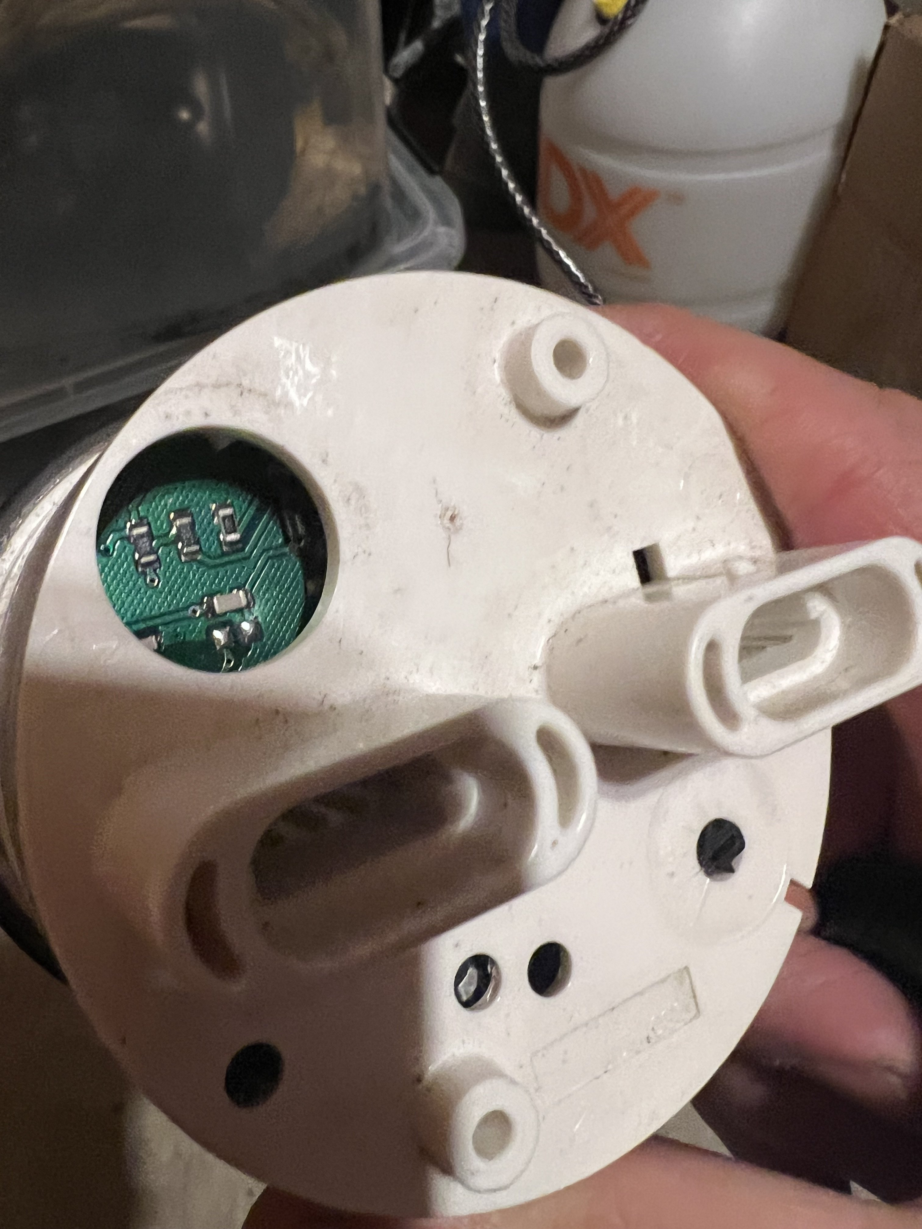

    I was organizing some of my parts this morning and saw this sync module that I saved from when I replaced my gauges. It looks like the diode and coil would be in it. Crazy how I just came across it, forgot I even had it. This just sits behind the dash connected to the sync gauge. If this is my issue, should be an easy fix. Hopefully it works.

    It must’ve been like this since I installed the new gauge cluster 5 years ago 🤷🏻‍♂️. First i tried my spare sync box and had no luck. Then I swapped the purple wires at the alarms, the port side beeped when I turned the port key on. Same with the starboard side, they were working independently as they should!. Then I started the engines and had no tach or sync gauges working. I then swapped the connectors at the sync box and everything worked as it should!! ⚓️
    I’ll add that it wasn’t my mistake when I installed the gauges. This was all pre connected when I received them. They must’ve been put together on a Friday!
