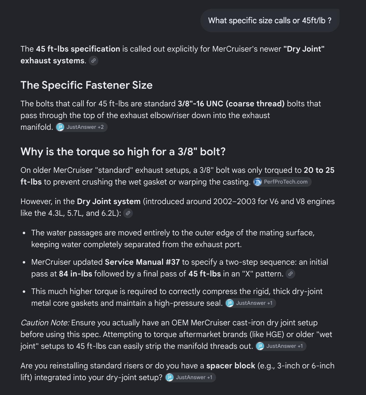

    What did you torque the bolts to? I think they’re 45 ft lbs. go up to 50 ft lbs. did you tighten in a cross pattern?
    Everywhere I looked has said 33. I did take it to 35 but didn't want to break anything. Of course now that I google 45 A.i. is saying
    "Cast Iron Risers/Manifolds: 30 to 33 ft-lbs (some larger or specific V8/dry-joint setups range up to 35–45 ft-lbs depending on the exact manual and fastener size)."
    so I took it to 35 but def not 45.

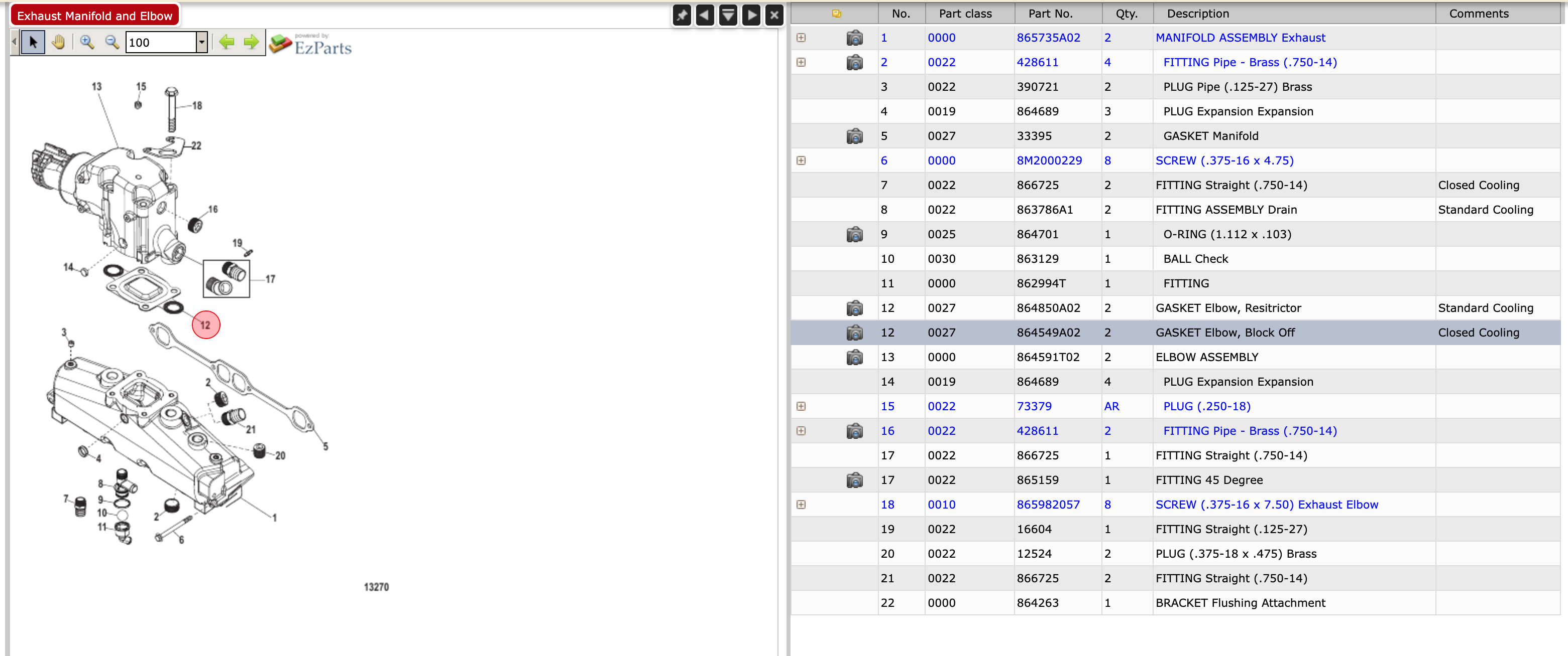

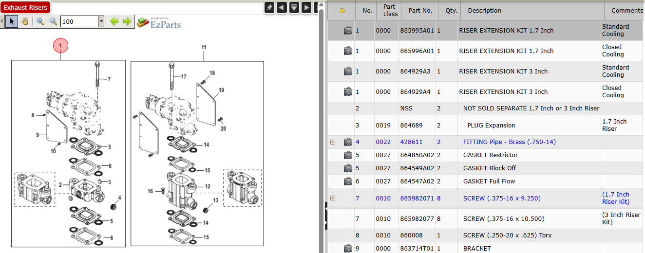

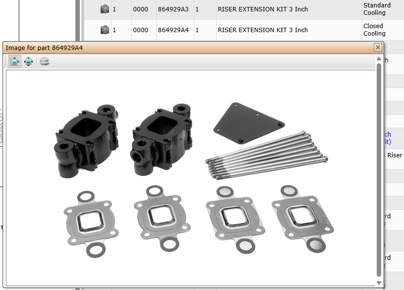

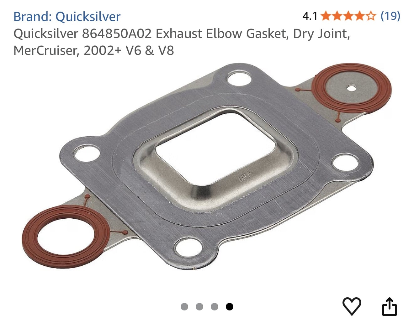

    The EPC says block off gasket with closed cooling but you installed an open gasket? Did you install open gaskets on both sides of the riser extension?
    3" riser extension for a 6.2L with closed cooling (not sure if its the same for your motor)
    Riser extension kit has 2 block off and 2 full flow gaskets:

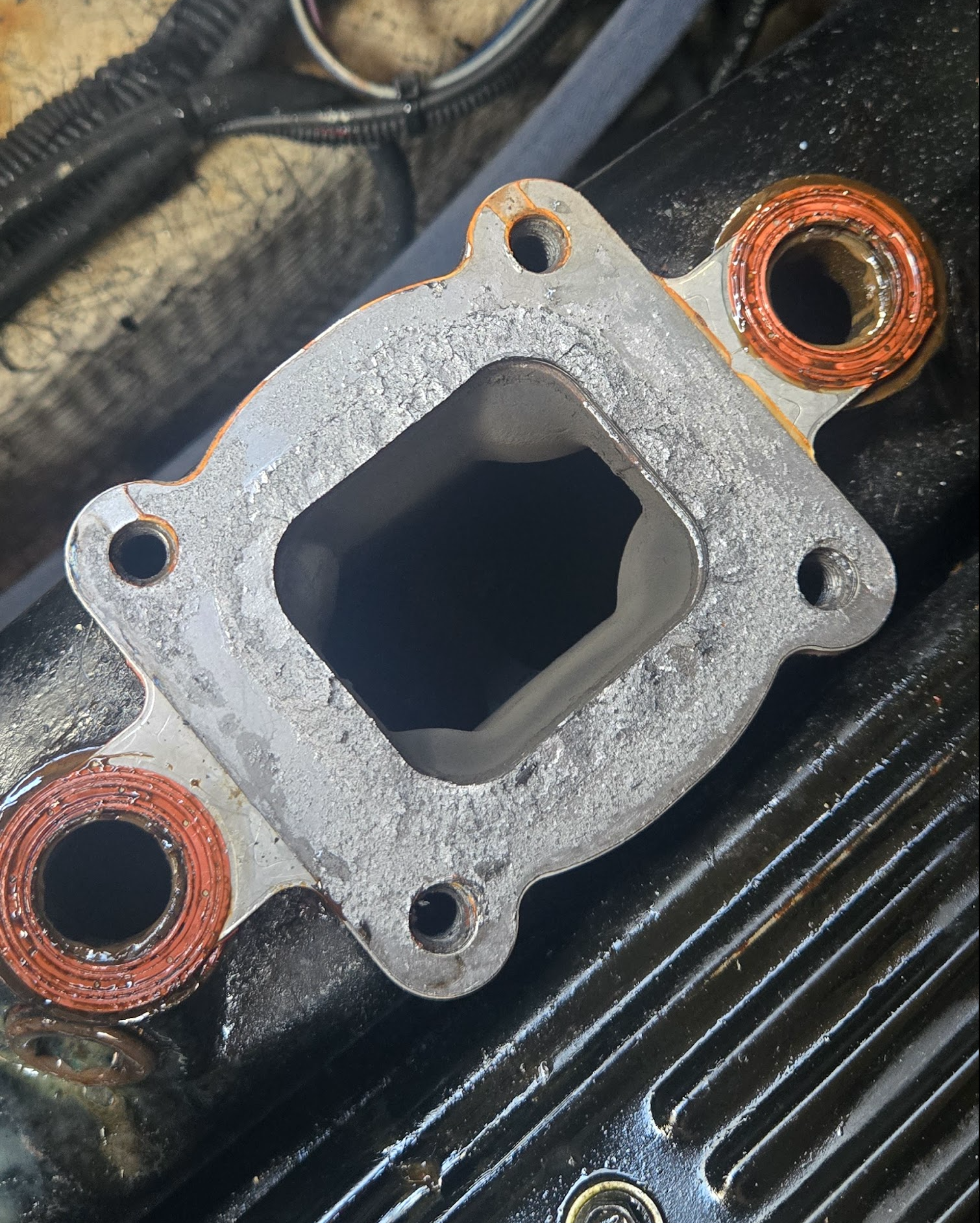

    Where was it leaking from? The most confusing thing about it is how it's leaking from a bolt hole.
    Here are some pics after I took it apart carefully - you can see where it was leaking here, doesn't really show where the water is coming from.
    Unless it does and I'm not seeing it. I suppose if it's not torqued down enough coolant could be coming out of that rear  hole (right top is stern of the boat)  and getting in between the gasket? maybe that's why there's all this rust around it..
    Yes, that's what we are running

    Okay, call off the hounds, I guess we keep her, one day I'll learn to actually get a shop manual :D

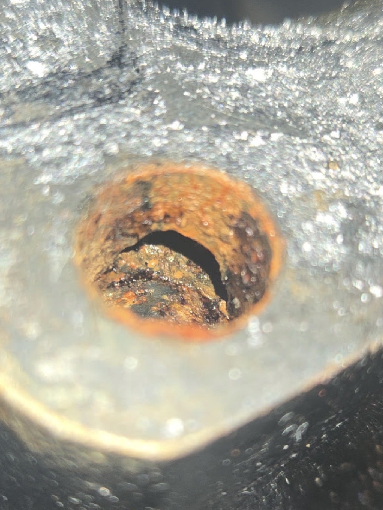

    What’s this? Looks like a casting defect or corroded through?
  • J3ffJ3ff Member Posts: 4,245 ✭✭✭✭✭
    Yeah, I emailed the company I bought it from asking if this was normal. Funny enough I have another Riser just sitting around as a spare, so I'm going to use that one.  Hopefully I can send this one back.
