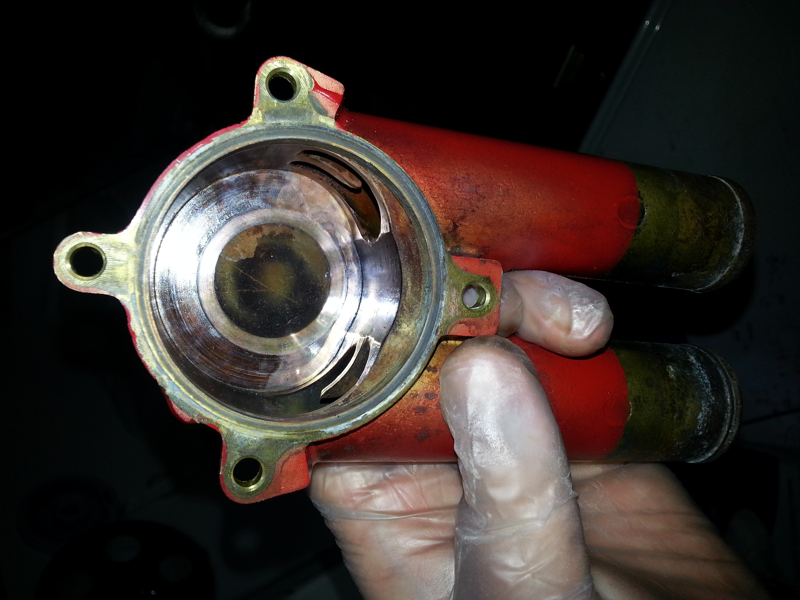

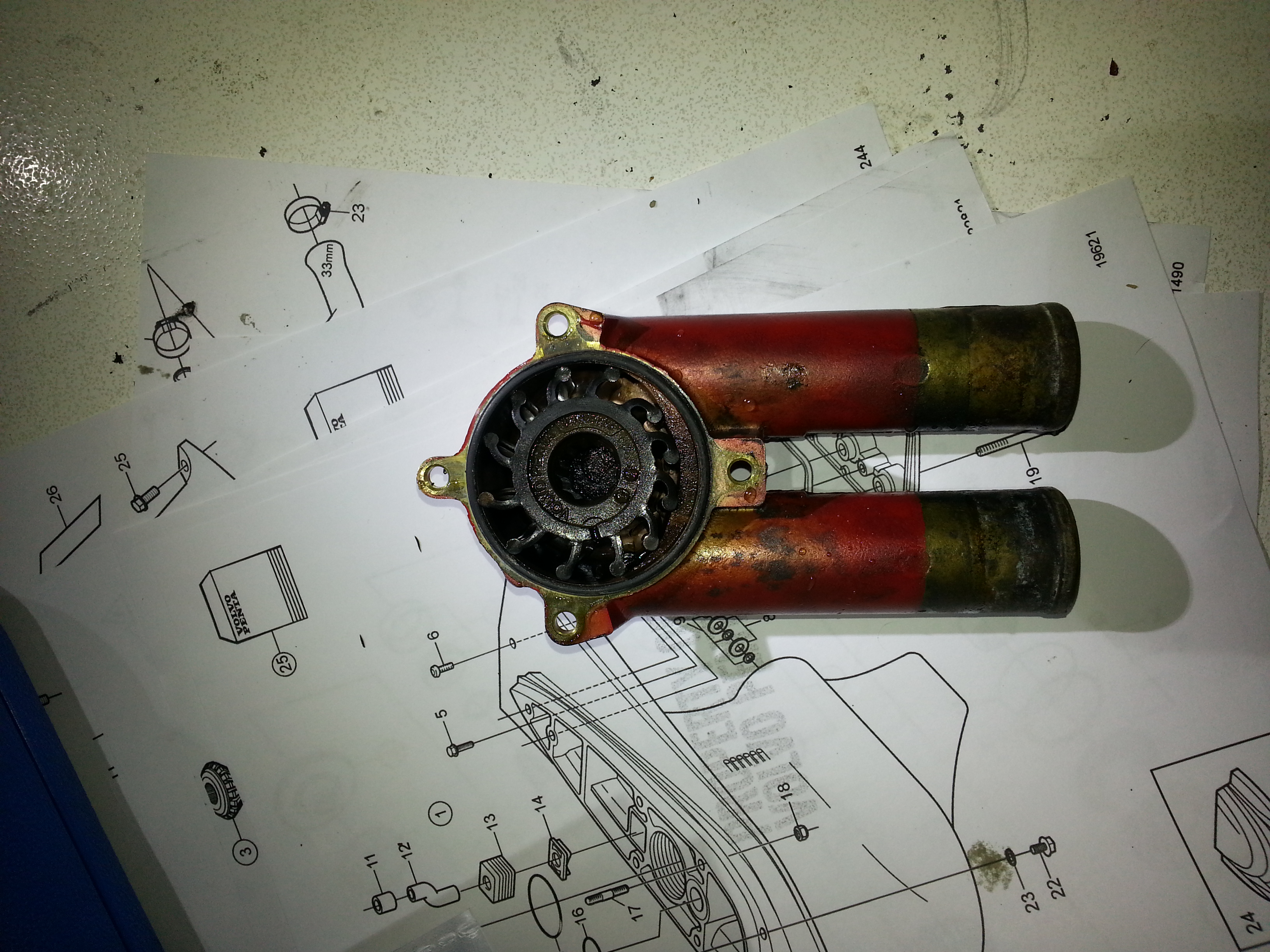

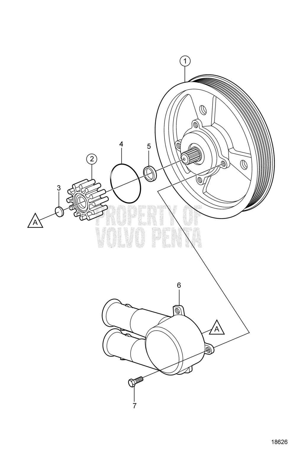

Bruce is right, it's quite easy. I hadn't done it ever, and took about 1,5 hours, but I wanted to learn how to do it in case on emergency...
The difficult part is that you can not see the impeller housing properly. Take amount of pictures with your cell, and you will figure out how that can be detached and you have documents of the work.
Note the direction of the old impeller and put the new one as the old one was. Use lube to put the new one inside housing. Clean the housing.
Here's a couple of pics.
