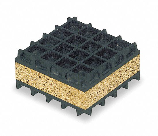

The next trick is how you attach the pump to the stringer.  One option is just re-use the existing rubber grommets, don't overtighten them, and hope for the best.  But I think a custom mount would work better.  I'd recommend this one, at $30 for a set of four:  http://www.mcmaster.com/#6772k811/=xfqmfn

Screw the mounts solidly to the stringer.  Use a short nut and bolt (1/4-20 or smaller) to attach the pump to each mount.  Once it's all installed, if you push the pump with your hand, you should be able to wiggle it a little bit.  Make sure it feels strong enough that it won't break off in heavy seas.

    PadVibrationThey make smaller pieces that you could cut up in 4s.
