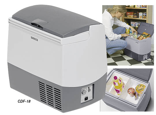

    That is so funny, that this converter is what they are running.  So, the fridge is 100% 12v.  The converter box is the switching mechanism.  I run the external Waeco coolers for an extra fridge and another one for an ice freezer.  No more melted ice.  I have two converters.  One, I use at the house or at the dock, depending on where I need it to power the second fridge.  The other, I installed on the boat to run the ice freezer on shore power from one of the 110v outlets installed in the cockpit.  I wired it to the house batteries, so it swaps over to 12v when I leave the dock.  The plug is just a dual 12v outlet block (so I can plug in both.)  Works great.
