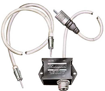

    Hmm mm. I know you can get an adapter/splitter to run both VHF marine radio and FM radio off one stick antenna. Not sure about TV OTA antenna.

    So, in theory, could I use this adapter and then add a splitter for the TV & FM signal, so in essence have 3 signals from the one antenna. Does that sound feasible without affecting VHF reception?

    That's the splitter I was thinking of. As per Stodges post though, I  don't think you'll get TV reception on a vhf radio antenna or radio on a TV antenna because of different wavelengths. That's why radio antennas are thin and long and TV is short and wide. Maybe a resident electronics wiz like Cable Guy Greg can chime in.
