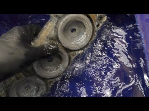

    @pault1216 The boat looks like it is brand new.  I think the engine cooling system would have the most wear and tear from saltwater with the build up of salt in the chambers causing corrosion.  Here is a good video about how to deal with it:
    https://www.youtube.com/watch?v=8w_o5xB8ZFI&list=PLJD0gZGZdCuccH5aK290F9VmjcCwZMZlh
    Although he is talking about an outboard I think an inboard engine would have the same issues.   For that kind of money I think I would have it surveyed.   Good luck finding one, there are a lot of them out there for sale.
