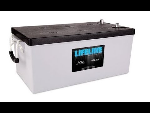

    Here's a really good video on the subject.
