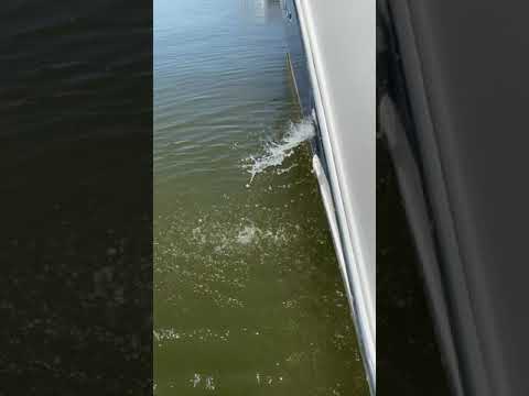

    When the generator is running how much water to exit ?  Mine seems to just spurt while running not a constant water flow is this normal ?
  • Aqua_AuraAqua_Aura Member Posts: 2,682 ✭✭✭✭✭
    Mine is not constant it is a splash of water every second. Kind like someone has a cup of water and dumps it so you have a constant splash of water.

    @Mbmike here's the water output:
    https://www.youtube.com/watch?v=P0SPF4iWwVs
    Yea that’s 5E typical, kinda like vomiting when your drunk
