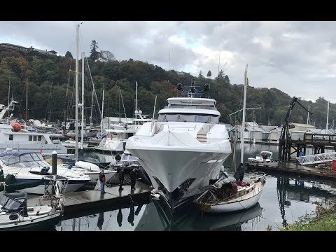

    We have a club member with axius and he was having issues with it being unpredictable, turned out to be the GPS antenna it uses for position. All I could think of was the Westport Yacht malfunction when they were fueling. This was a brand new boat fueling to be delivered.
    https://youtu.be/UPA2y-WcmX0
