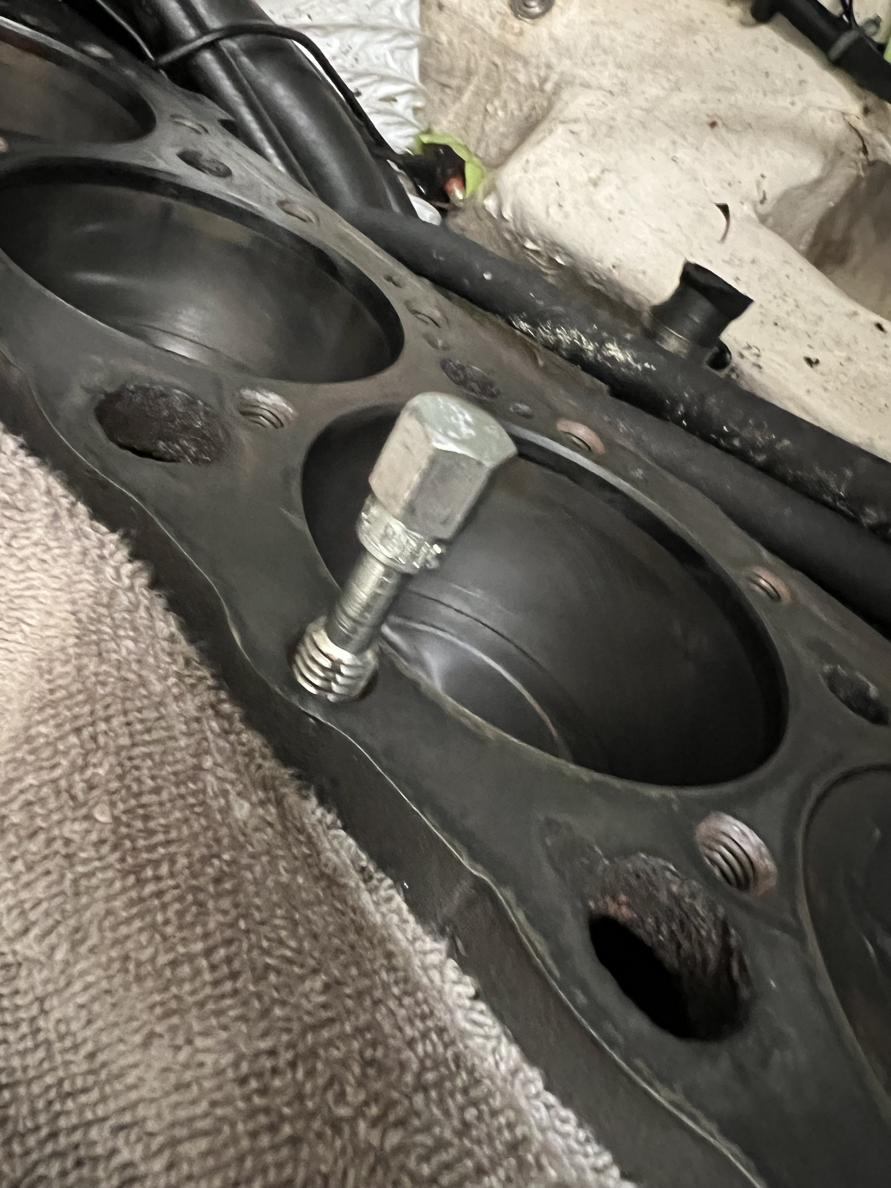

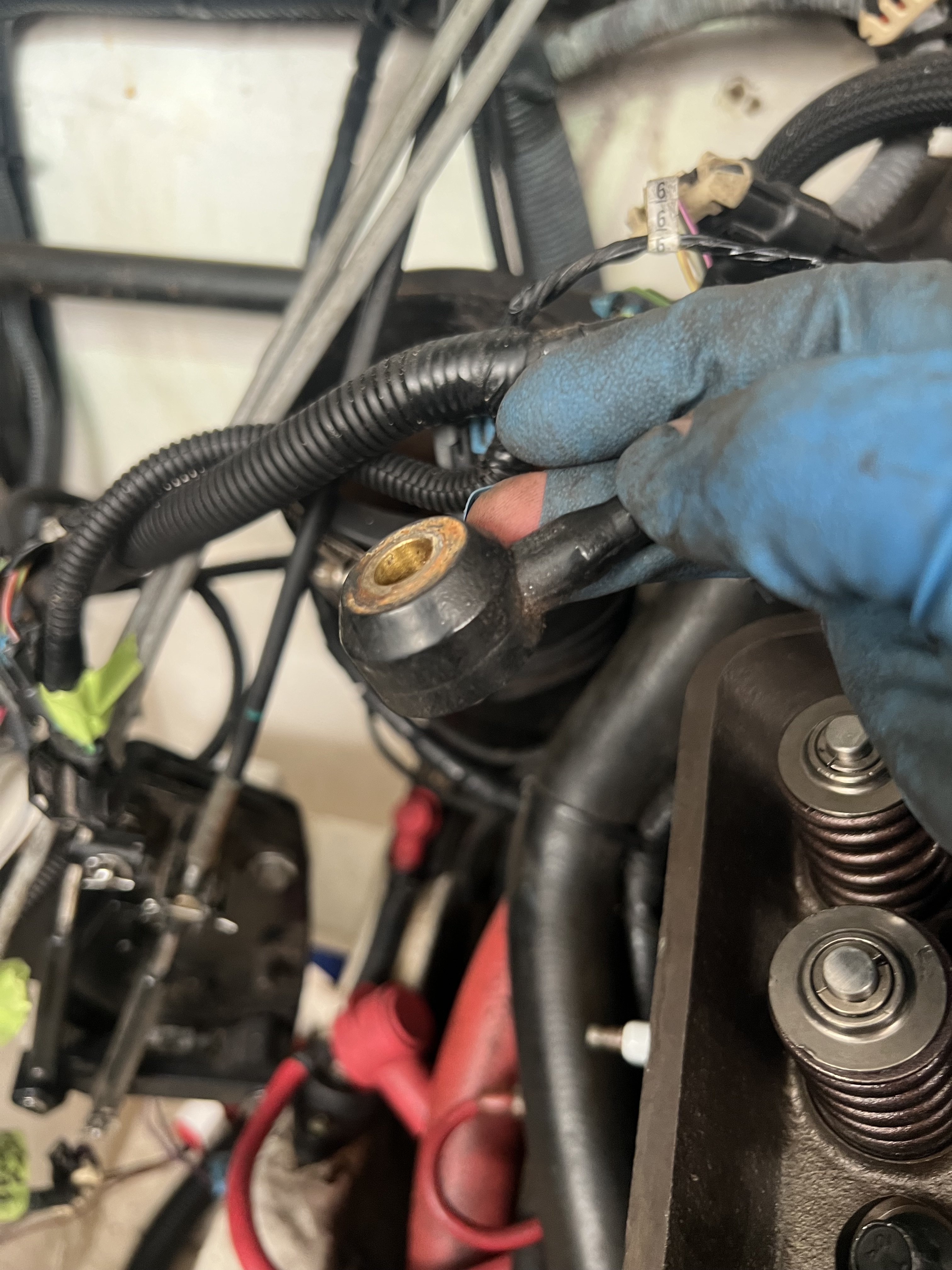

I chased all of the head bolts this morning and installed the heads. Got front and rear brackets back on as well? Anyone know what this sensor is for at the back of both heads? Is it for cylinder head temperature?

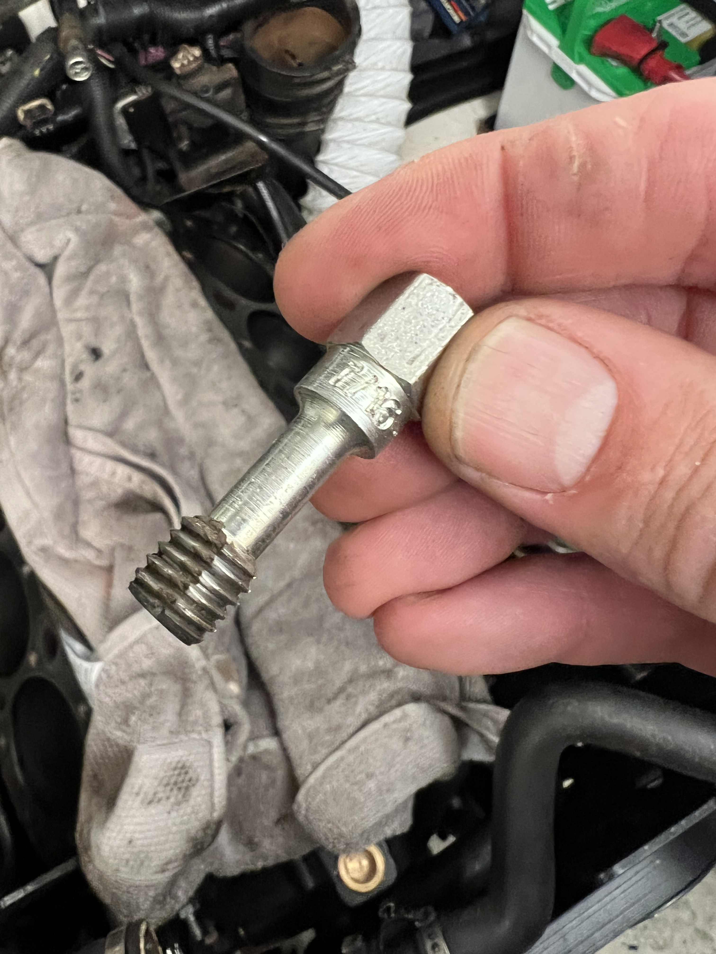

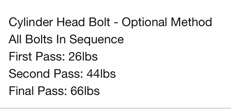

Just curious why did you clean up the threads for the head bolts? Just good practice? what do the heads get torqued to? Looks like a brand new motor. If you ever upgrade & sell your boat someone will be getting the best taken care of boat in history. the quality of your work is amazing.

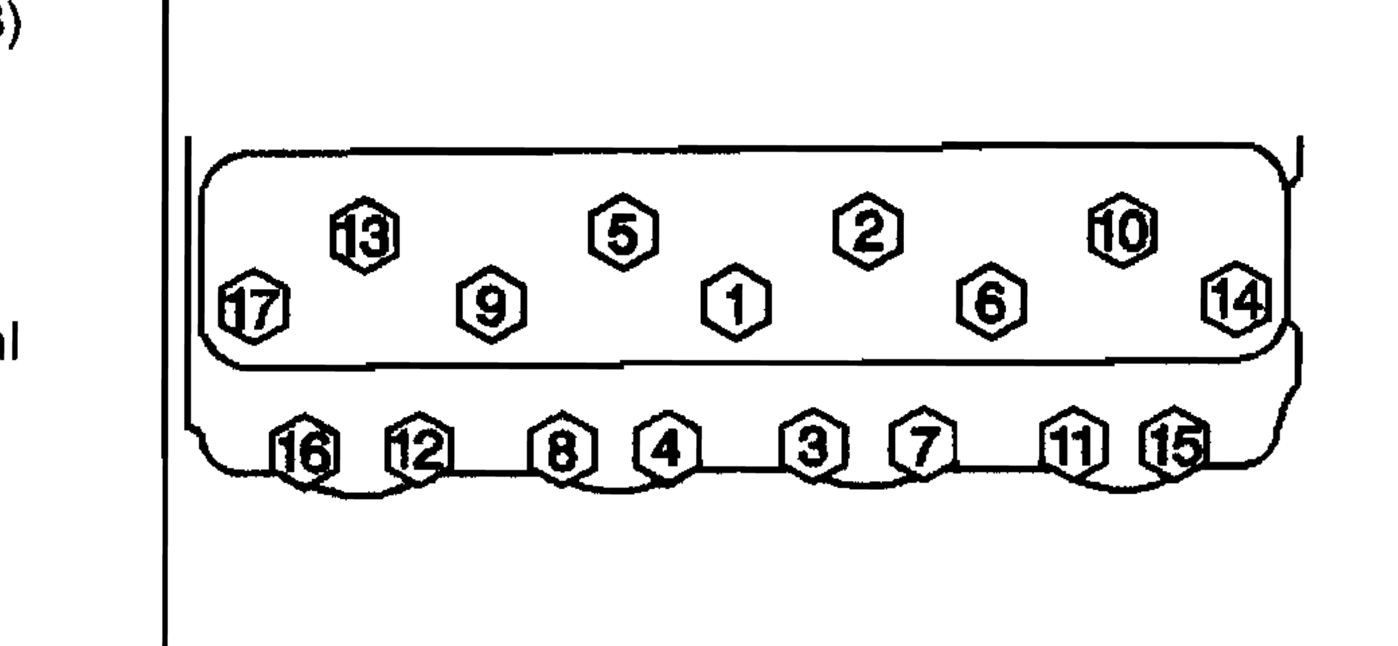

Thank you @captkevin ! The reason for cleaning the threads is to prevent any debris from dragging on the bolt and giving a false torque reading. I torqued the bolts in three stages and in a certain order. There’s another method to use a torque angle but I felt this method was fine. I even bought the tool to torque to a degree but heard stories of people breaking bolts. But I also read that method is for torque to yield bolts. The new head bolts I bought are not TTY bolts.

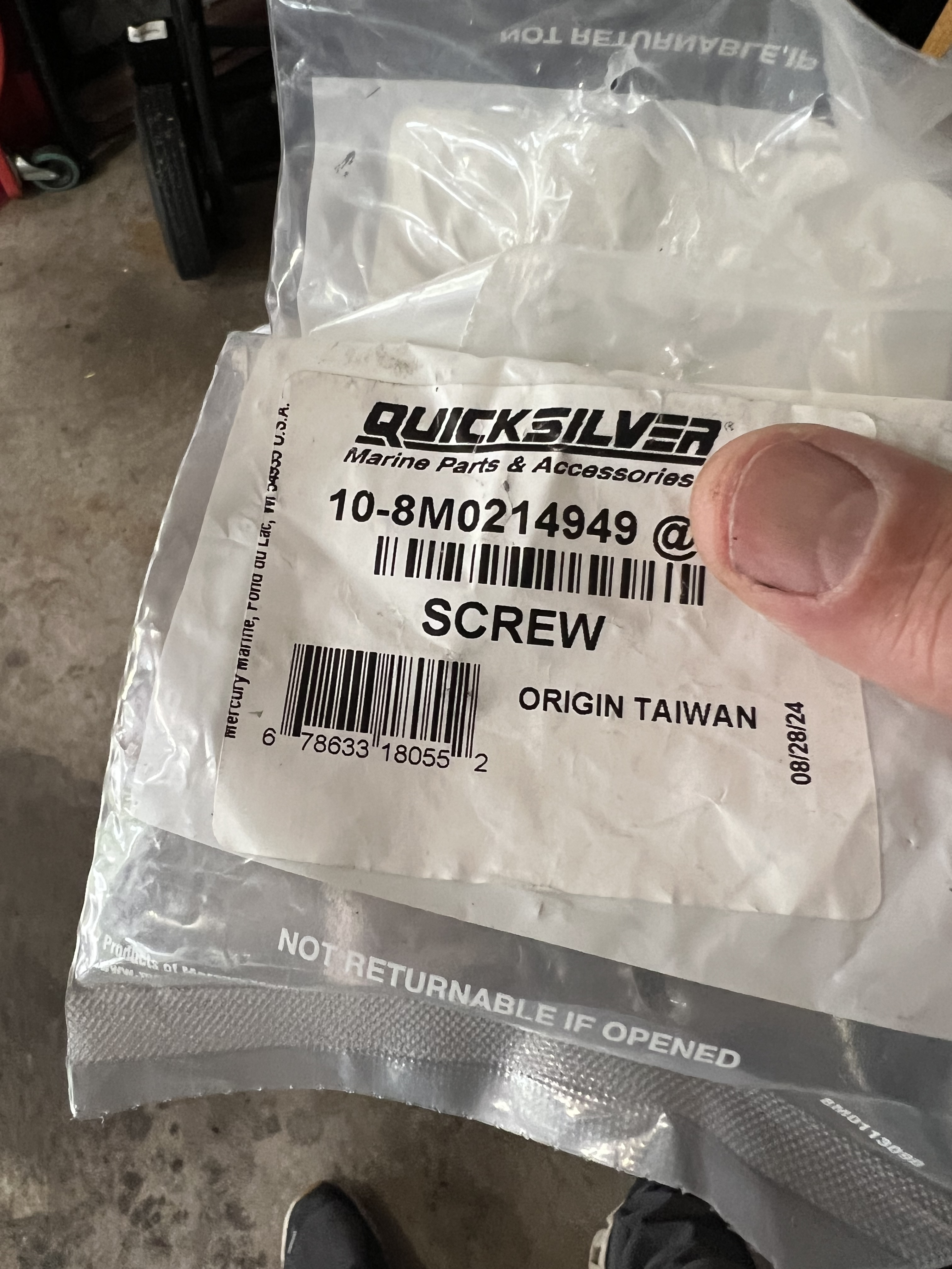

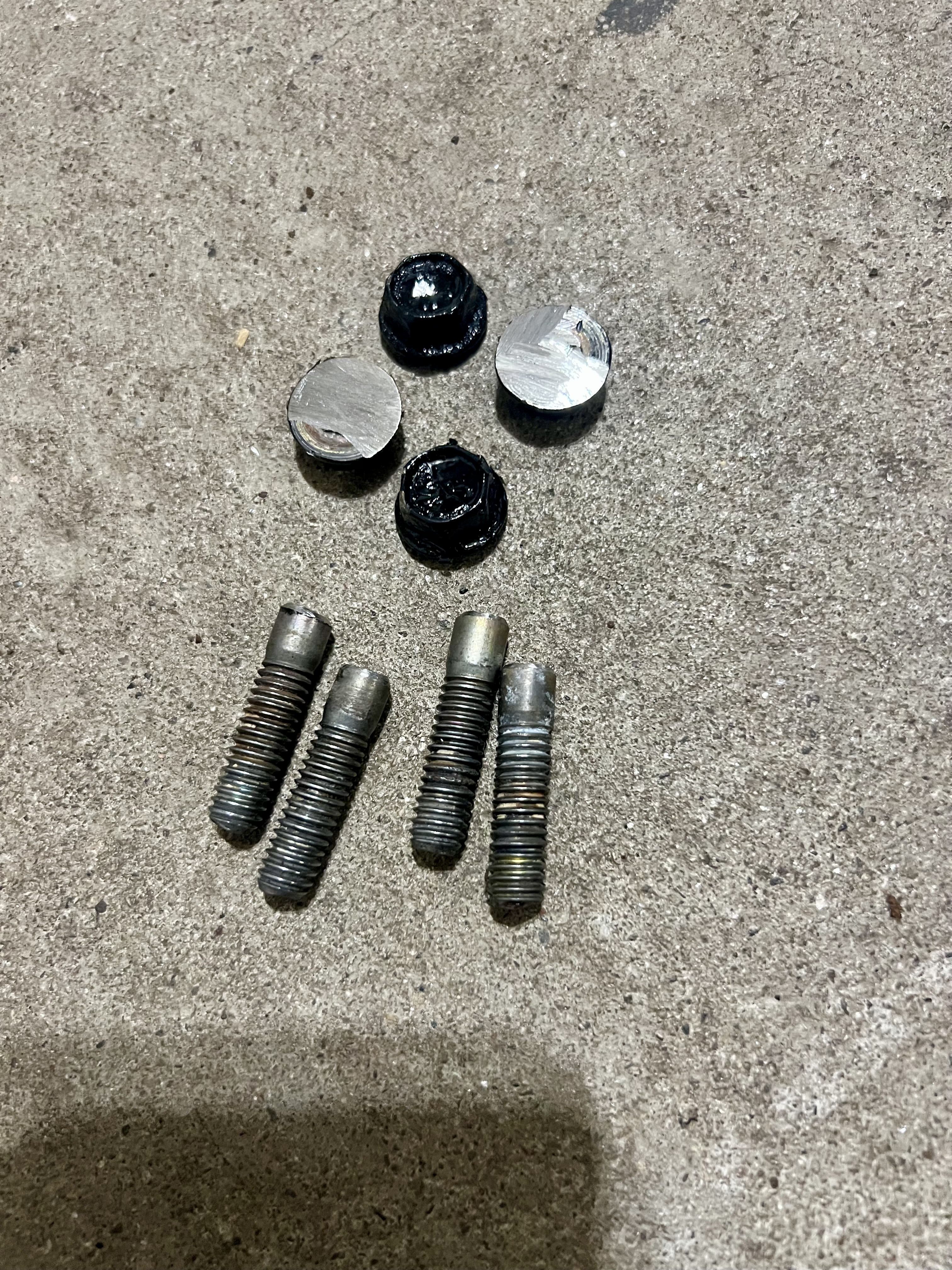

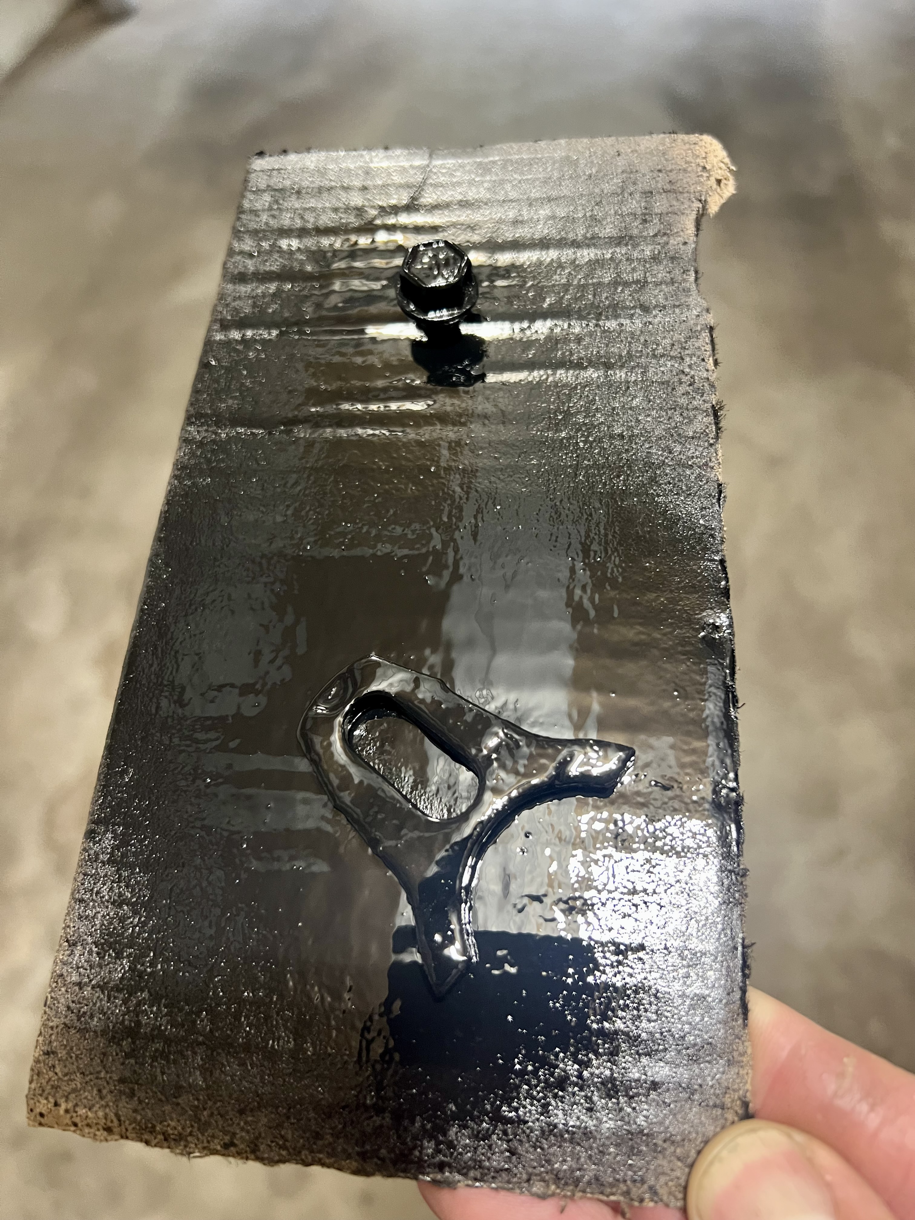

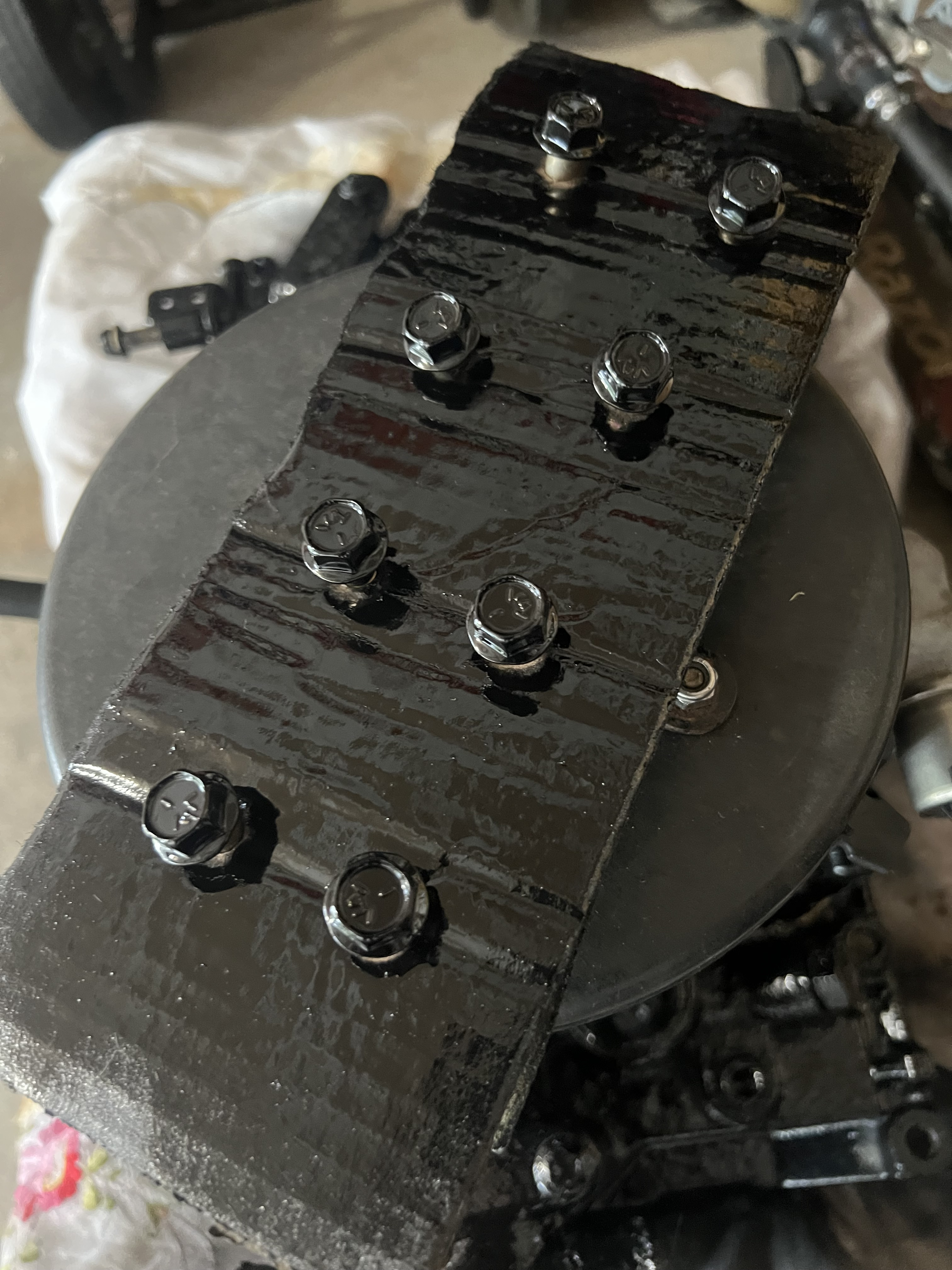

I ordered 8 new intake bolts. I cut the heads off of 4 of the old ones. I’m going to use these as guides for when the intake goes on. The intake is extremely heavy and you really only have one shot to line everything up and not ruin the sealant and gaskets. You don’t want to have to slide the intake around to get it aligned. This will line it up perfectly on the first shot. I painted the distributor hold down and bolt also.
