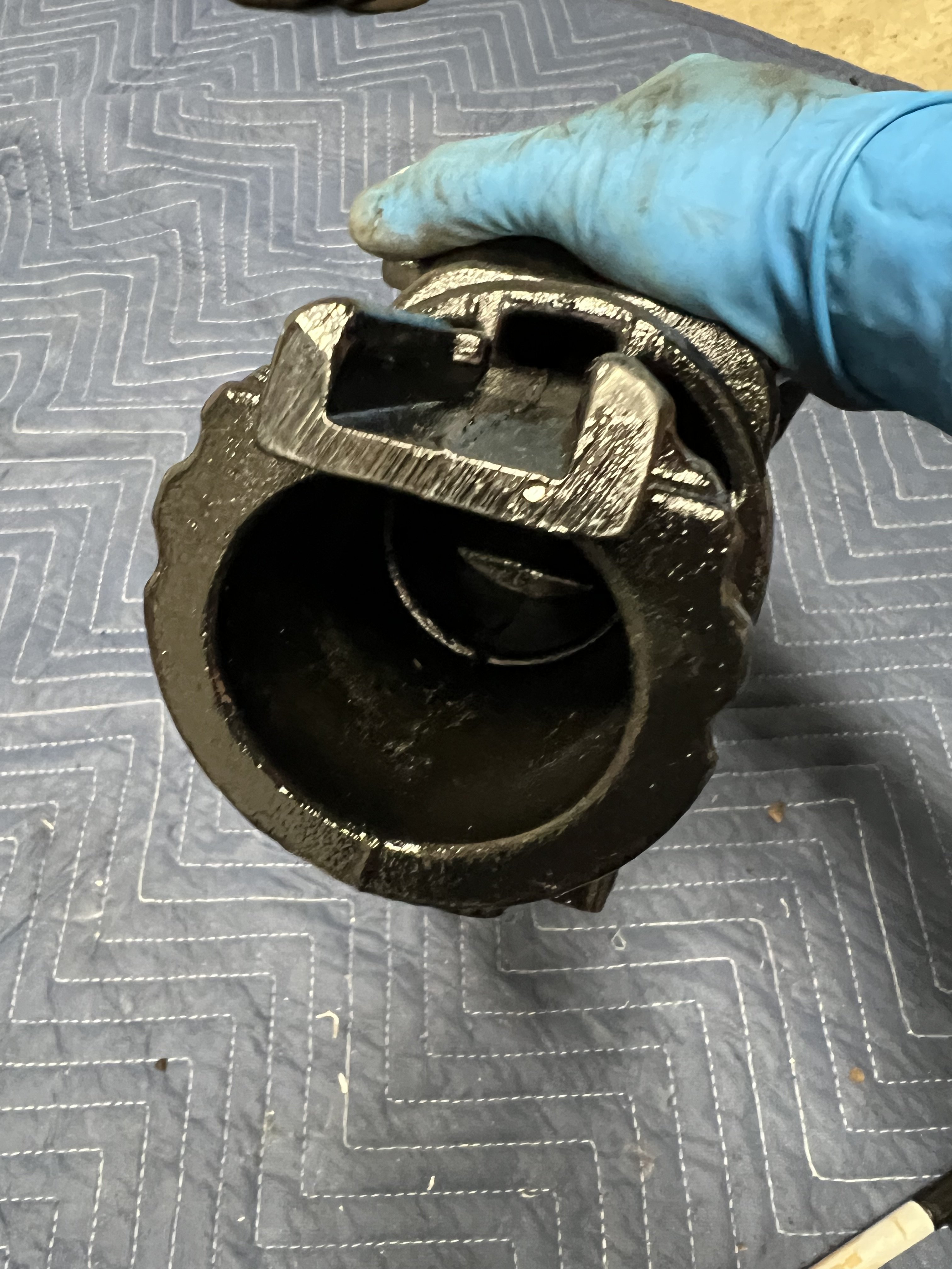

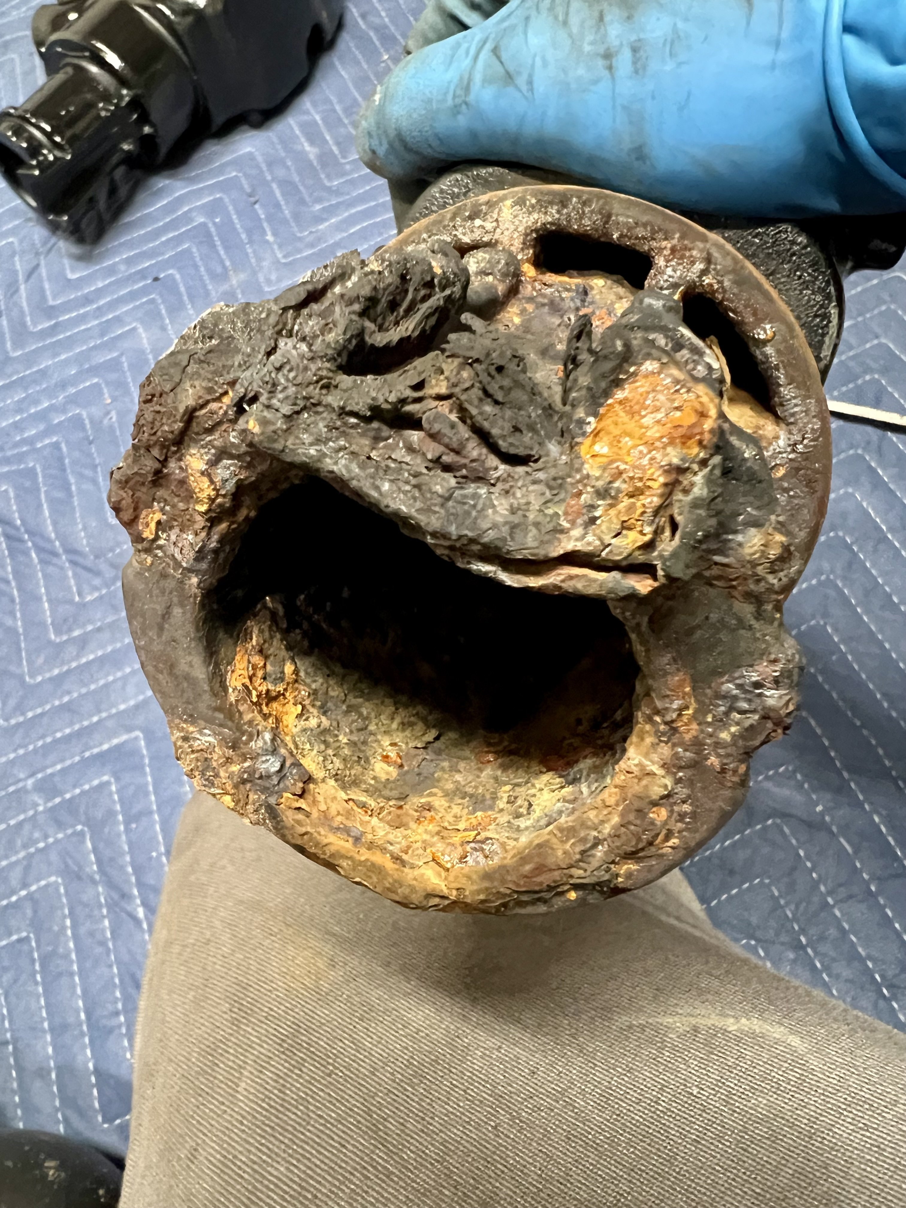

    Was planning on finishing everything up today. Went to install the exhaust manifolds and didn’t like what I saw. Looks like some water was making its way in, couldn’t tell if there was a crack but didn’t want to take any chances. I also saw some salt crystals in there. Luckily there was one set of risers/manifolds left at the shop where I get my parts from. I’ll probably install the new ones next week. These manifolds and risers were installed August of 2020.

    Agree, but better than finding out in the middle of the bay!

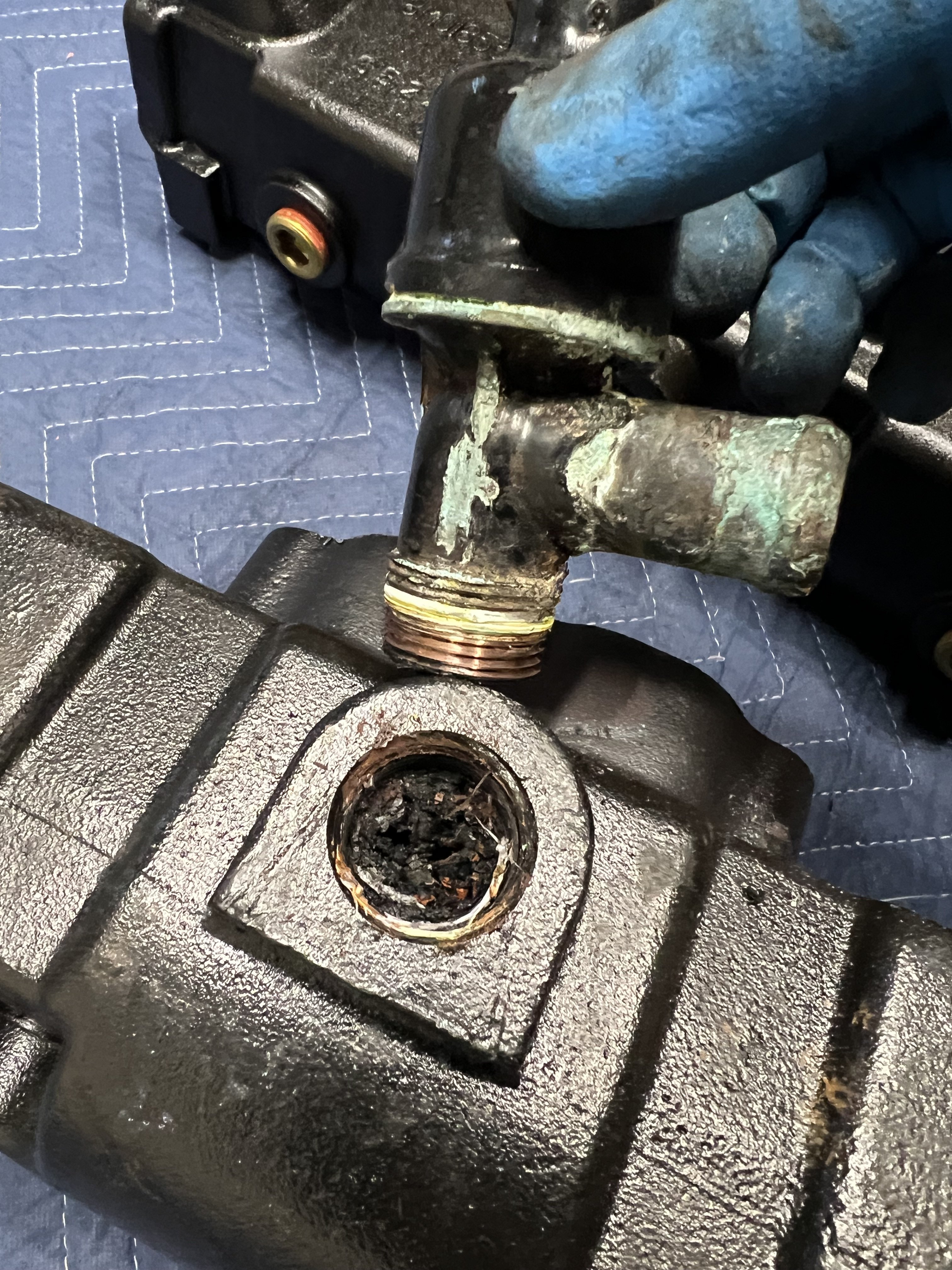

    I swapped all of the fittings and installed the plugs that came with the new kit. As you can see, one of the elbows was starting to get plugged up. It looks much worse in the picture but definitely glad it’s getting replaced.

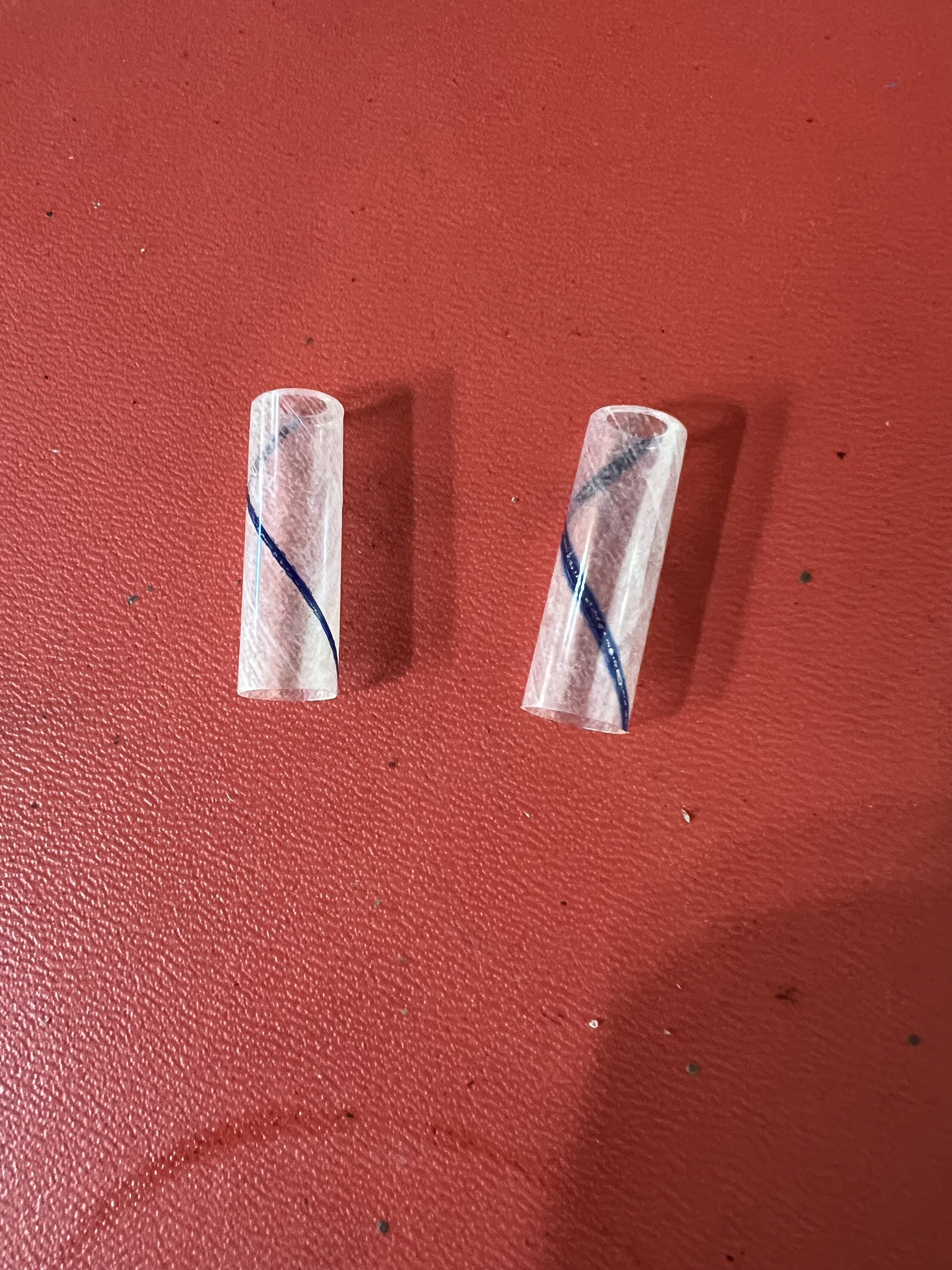

    Anyone know what these tubes are for? They were in the box for the intake manifold gasket kit.
  • rasburyrasbury Member Posts: 8,783 ✭✭✭✭✭
  • aero3113aero3113 Member Posts: 9,602 ✭✭✭✭✭
    They’re very soft plastic.

    I forgot to post this pic. One of the holes for the drain in the exhaust manifold was starting to clog also. It wasn’t packed tight, just sitting there. I wonder if this is from when I descaled the engines this past spring.

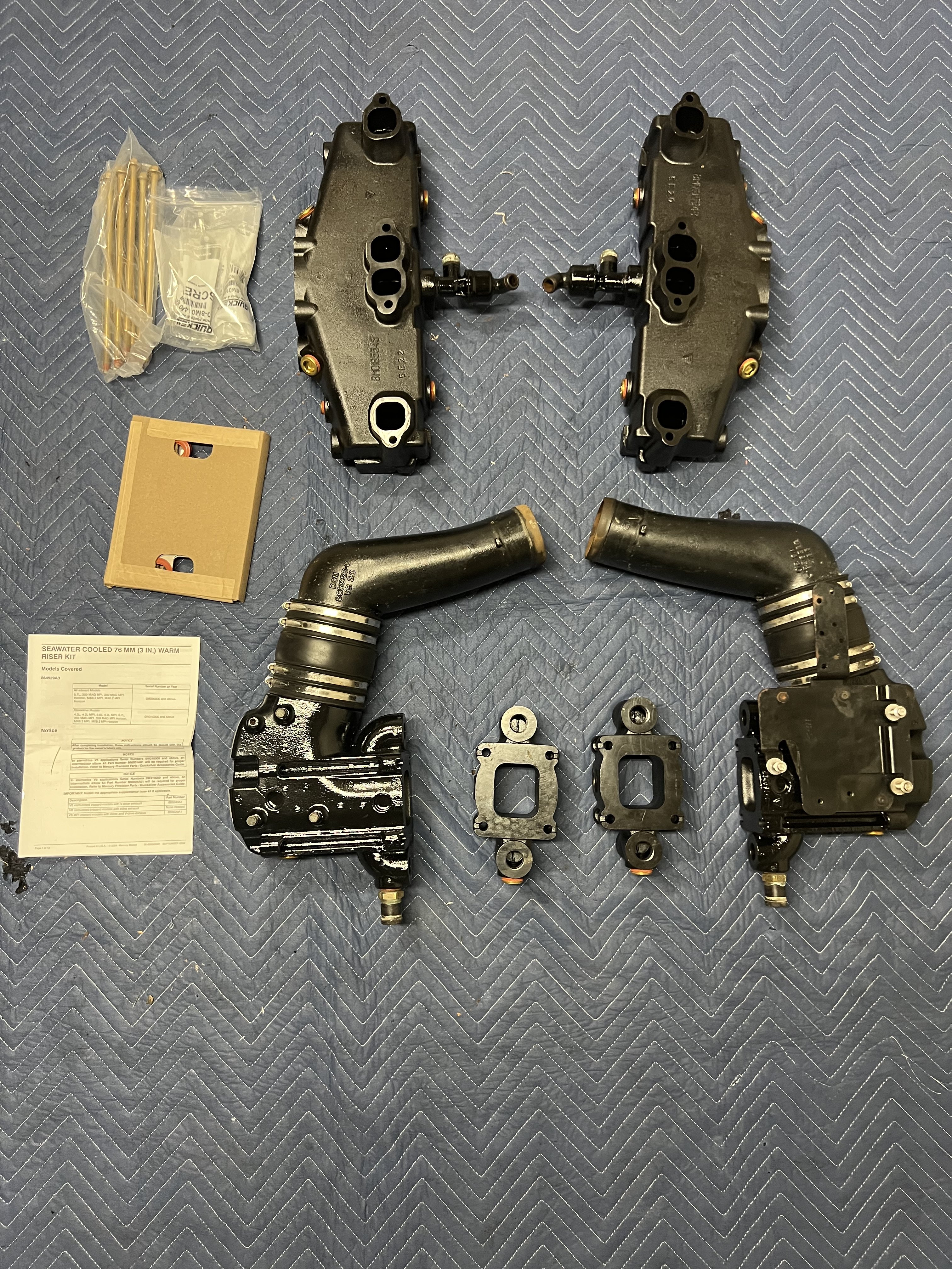

    Got her all back together!
    Have to let the sealant on the riser gaskets cure for at least 24 hours. Will try to start her within the next couple days. ⚓️
  • earl1z19earl1z19 Member Posts: 363 ✭✭✭
    looks good and now you know exactly what you have, no guessing at this point

    I rechecked the torque on the riser and exhaust manifold bolts since they went through a heat cycle. All of them were able to be tightened about 1/2-3/4 of a turn. I’ll check them again when fully cold and then again after the first run next season.
