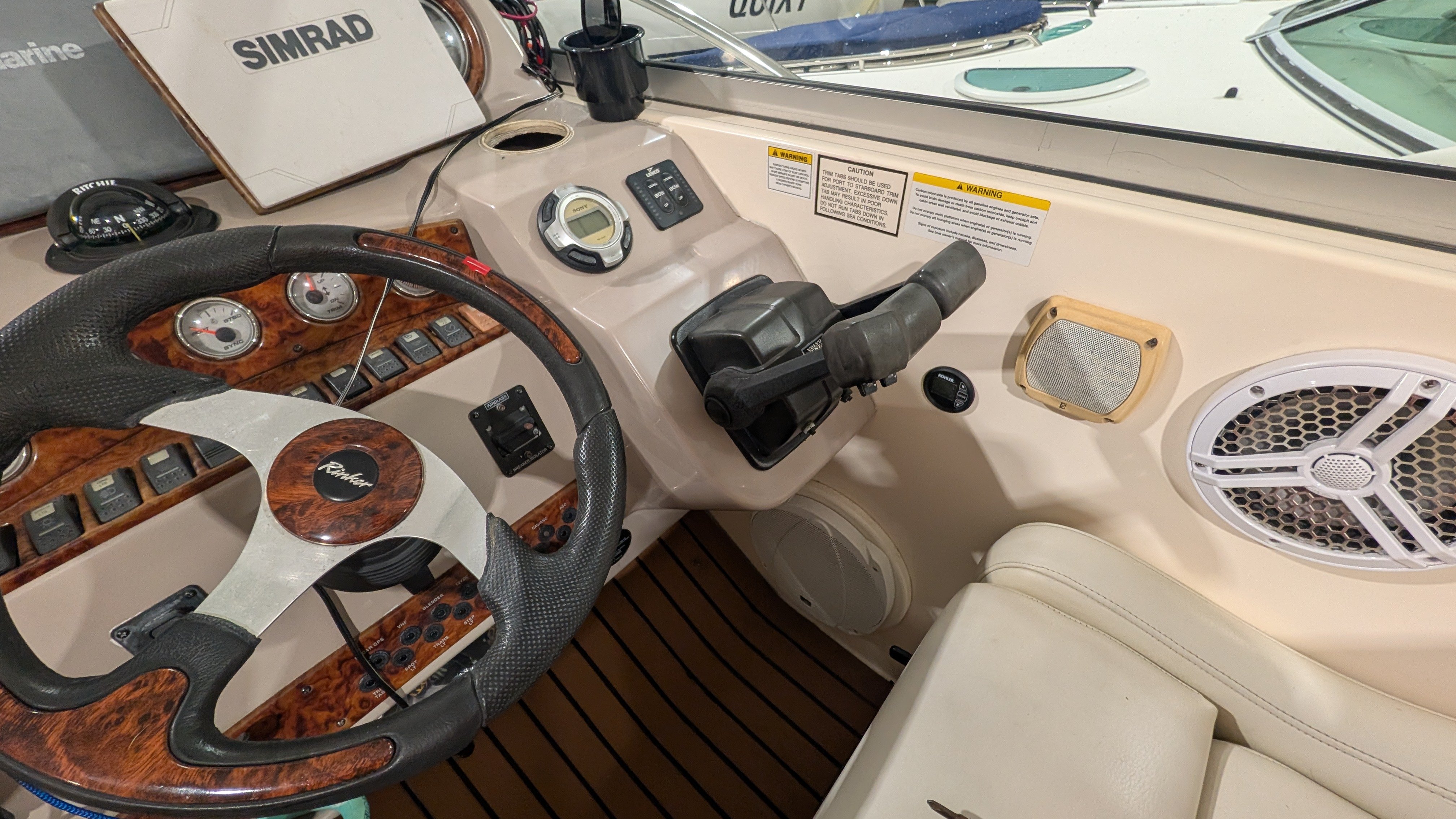

    Anyone know how the cover comes off the throttles to remove the mounting screws?
    Its a top access but there is a trick to remove the outside trim cover.
