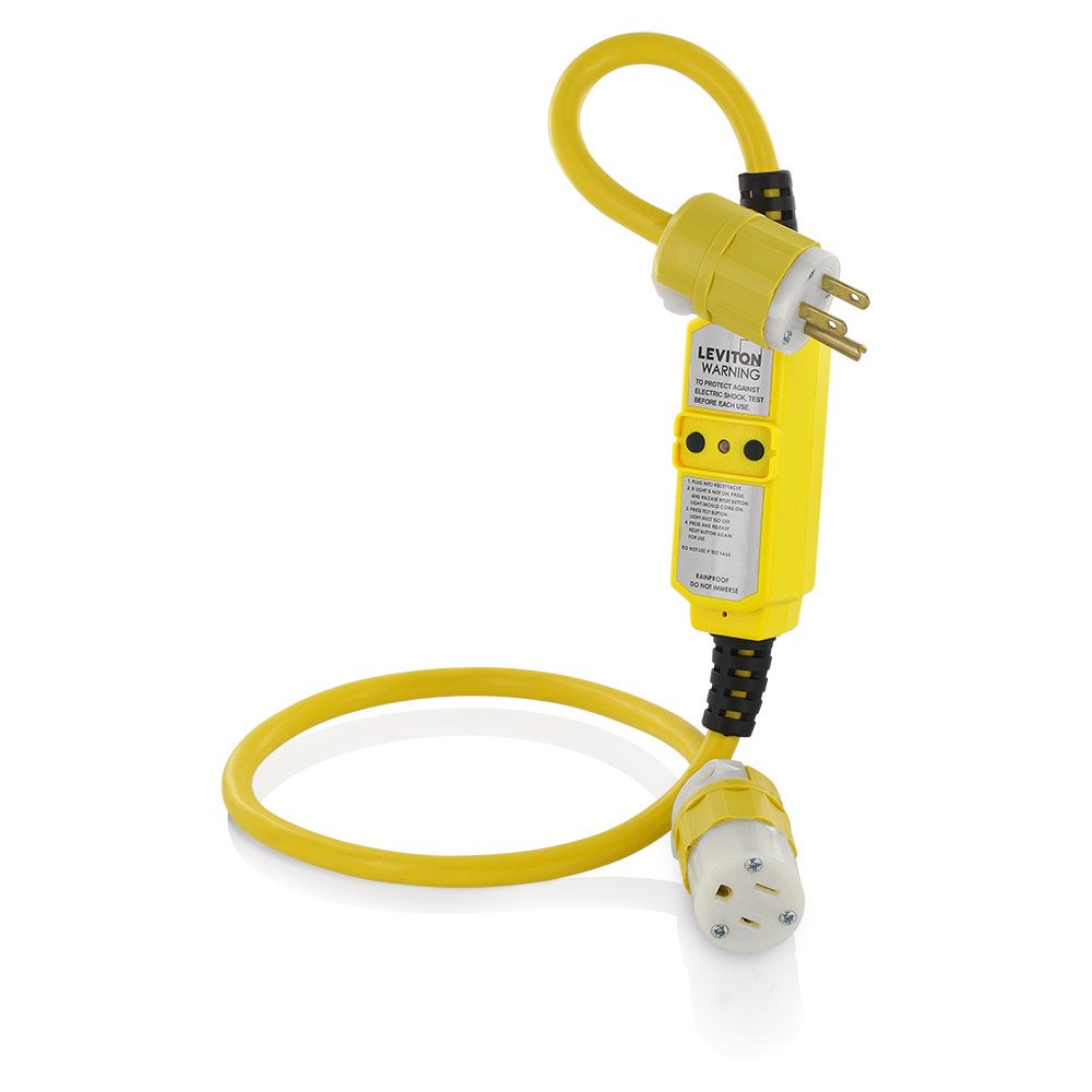

    What about something like this? Would the GFCI also protect in case of a power surge or short in shore power?

    Joe, if it were my boat, I'd put something like that in it with a proper breaker (maybe inline surge/breaker) and call it ok.  I would think the charger has something already built in as well (as willhound said).
    A GFI will not deal with a surge. IF the only power you need is to the battery charger, you could install a surge protecter at that point.

    I just cant find a simple, marine safe surge protector. I dont think a GFCI will prevent damage to my charger and electronics if there is a surge in power, or will it?

    So it appears as the vast majority of GFCI outlets/adapters DO NOT have any sort of surge protection. They simply protect from a short or ground fault. They wont protect from a power surge. My biggest concern is during thunderstorms a nearby lightning strike and/or a power surge during peak summer usage.
