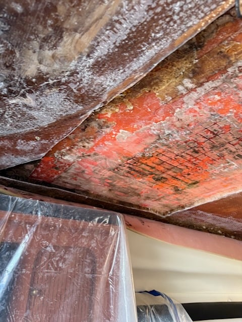

I have begun replacement of the rotted coring of my bow deck on my 2003 270.  I have gained some knowledge from this forum and YouTube and think I am on the right track.  I cut out all of the underlayers of fiberglass and removed all the rotted coring.  I have a couple fans in the boat making sure everything is dried out.  I plan to finish sanding the area this weekend and to start epoxying the new balsa core in place.
Here are some pictures of the progress.  The white circles that look like mold are a product I used couple of years ago called "Inject a Deck."  It didn't work that well.
For those who have tackled this project, I welcome your tips, tricks, and advise.

    @captkevin It is for sure.  I just keep telling myself I am saving thousands.  The hard part is mostly done (I think.)  Cutting fiberglass with a Tyvek suit and a respirator on is not a good time.  The old coring scrapped off in mostly little pieces that I had to vacuum up while not sucking up the plastic or drop cloth.

    @captkevin I am installing 3/4" balsa coring by epoxying it to the top deck, then a few layers of new fiberglass on the bottom.  Hope to have more pictures this weekend of progress.

    I installed most of the wood coring.  Now I am almost ready to start laying glass over everything.
    Mixing the epoxy with silica filler helped to make the panels stick better when installing them overhead.  The harbor freight poles/jacks also helped to support the panels.

  • JonnyMJonnyM Member Posts: 332 ✭✭✭
    @captkevin As you can see in the pics, I had to get creative.  The wood X is from some kids game I found at our marina and the round thing supporting the other piece of wood is a electrical box support for a fan.
    @Cableguy Greg The hardest part was templating the pieces because I didn't cut straight.  Those support poles make it much easier too.

    Personally, I would have cut from the outside then sprayed the top side area with properly tinted/thinned raptor liner from a gravity fed gun.  Not as rough of a finish as the bed liner spray gun they sell with the kit but still rough enough to cover imperfections where you would scab the patch back in place.   (I'm lazy)
    @PickleRick It has been a big project for sure.  The nice thing is I don't have to make it look that nice because it will be covered up.  The original headliner is in good condition and will be put back up when I am finished glassing.
    Here are some more pictures of the progress.  All the balsa coring is now installed.  I plan on starting to lay the fiberglass over it tomorrow.  It may be overboard but I am filling all the seams with Total Boat Total Fair fairing compound (green stuff.)

    After getting more epoxy in my hair and running out of resin twice, I am finally finished with the project.  I am very happy with the results.  The deck is now completely solid.
    It was a pretty big undertaking but doable.
