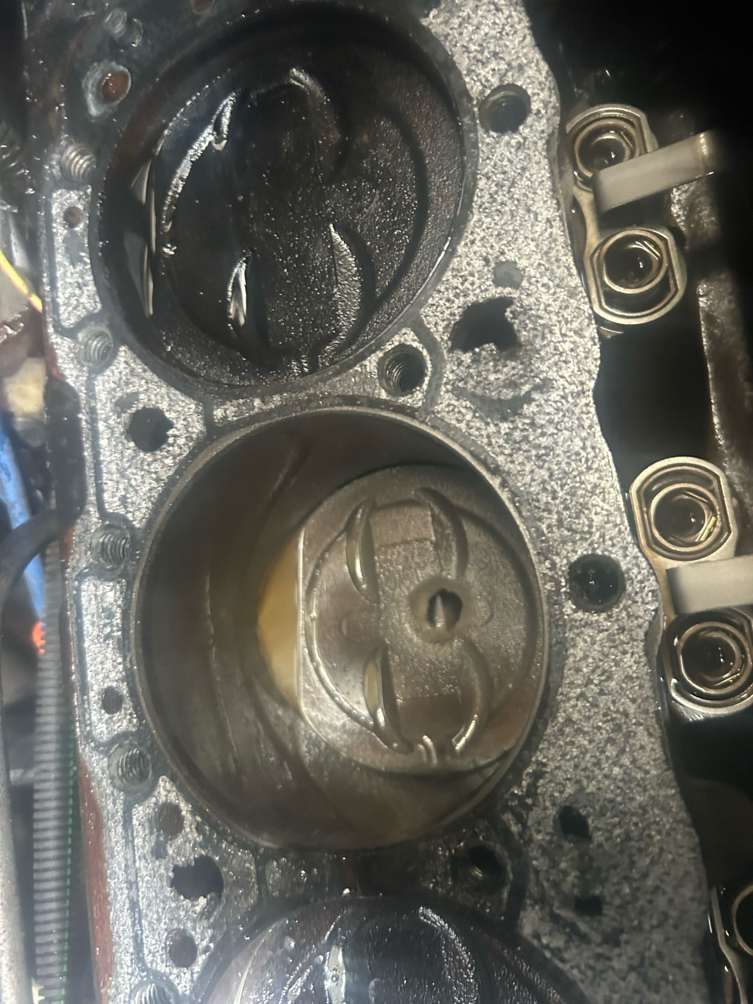

    Thanks everyone. Unfortunately, the shower ended up being the least of my worries since shortly after creating this thread I blew my starboard motor up lol

  • McGarnicleMcGarnicle Member Posts: 260 ✭✭✭
    We think the head gasket blew which then caused it to melt the piston. Crazy thing is the temp gauge never went above 180F.
    Have a long block getting here next week and shouldn't be down too long.
