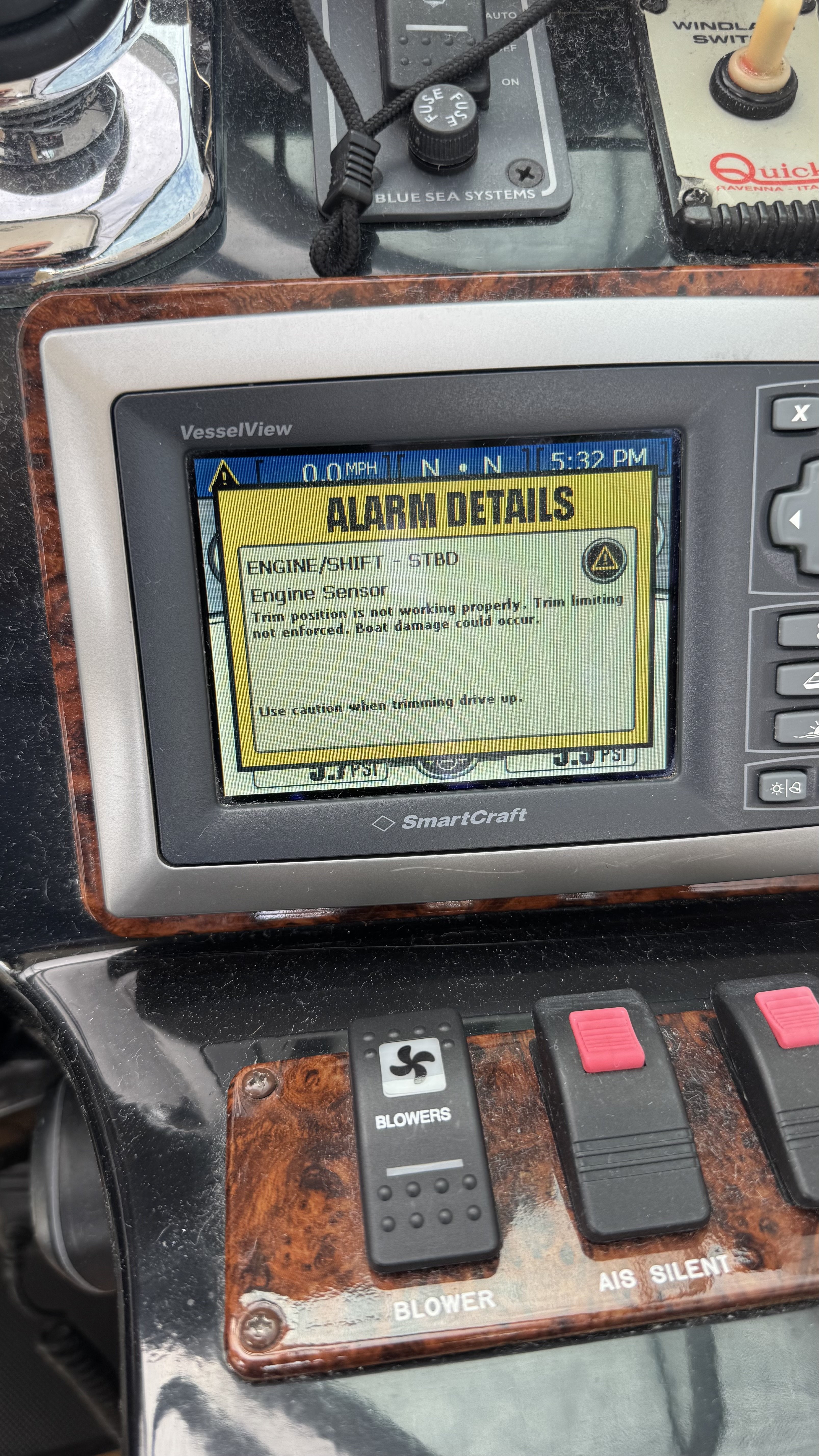

I have the following problem which it become frustrate at this point. as the following photo i have an alarm about the trim limit. i replace both trim limit in both engine, clean every ground connector for the engine, as following in a forum I replace the engine mecathor system. after everything done i still getting the following alarm intermittent now. it mean it happened sometime when i start the engines and sometime when i am running the boat and something it doesn't happen during my trip..IT is real frustrated because i don't have any clue what can be causing this issue. I was told to replace the harness which connect the engine trim sender and maybe the herm control too. any advice or if anyone have this issue before will be appreciate. One more note my mechanic can not figure the issue too. Thanks

    I get the same alarm on mine every season or at least I used to. It came down to the pivot pin on the transom assembly. The sender on mine would loose contact with the pin and then stop sending a signal and then throw the code. The G3 software would show a signal coming from the sender so we would recalibrate the drives. That recalibration would last a few weeks maybe a month and then go bad again. My solution was to hang a  new sender on the inside of the transom and plug it into the harness while disconnecting the old sender that is on the drive. its not the perfect solution but it works for me. Not sure if this is the same situation for you but its worth trying before you go any further.

    Hey @oscar1 what condition is the area where the hinge pin (bolt) connects the gimbal ring to the bellhousing? Since that's where the sender mounts, I could see how corrosion in that area might cause issues?
    Mercruiser's trim-sender is a potentiometric one with a down-resistance of 10 Ohms and an up-resistance of 167 Ohms.
    (Values for ohm meter testing -- 10-167 ohms across the 2 wires. )
    With a Multi meter on ohm setting with leads in plugged into correct positions ( verify meter work by touching leads together and getting something close to 0 ohms on meter indicator )
    Connect the meter leads to the 2 trim sensor wires ( These should be disconnected from boat )
    Spin the sensor housing to center section & look for readings that are variable as it turns and in this range.

    Oscar, I just plugged it in and zip tied it to the harness on the transom. You could easily attach it to a piece of starboard or something similar  to make it look more professional and then hang the star board to the transom.  i did go through the calibration process on the smartcraft so that it thinks everything is as it should be. At some point I want to fix it properly by addressing the pivot pin issue but for now this is a good solution.
    edited January 20
    It's a 10 ohm resistance at the full down position.   For about 10 bucks you can purchase a hand full of 10 ohm resistors from eBay/Amazon
    Crimp some bullet connectors on each end and plug it into your trim wire.  Heat shrink for a little added safety
    Assuming your wiring from the connector up is good, this would leave the vessel always seeing the drive at the down position.
    I've never used resistors for this purpose but they work amazingly well for fooling vehicles into making LED signal bulbs achieve proper resistance so the blinker relay doesn't click a million miles an hour.
