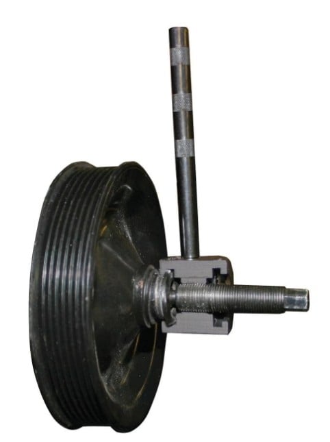

After dropping in this past weekend, I noticed one of my seawater pumps is leaking a bit. I'm getting ready to do the replacement job for the first time. I've already bought the pump I need (this one), but I need to buy a 'power steering pulley removal/install tool set' in order to swap the pulley onto the new pump. I've seen conflicting information on what kind of set I need. Some sources say I need a metric set, and others saying I need one compatible with GM (and these appear to be SAE). Does anyone have any guidance or recommendations on which tool to buy?
    From the diagram, I think it's the same Lisle 39000 "no slip" pulley puller that I bought back in the day.  I still have it ... if you want it, I can ship it this week.
    I can tell you from experience -- regular 3-jaw pullers won't work.
    This looks perfect. Thanks but I'm going to order one from Amazon so I can have it tomorrow. Thanks!
    Yes, I’ve tried it as well.

    If you're in a need it now pinch most automotive stores rent a power steering pulley puller kit
    edited May 7
    Pressing it back on will be the next challenge.
    That tool does removal and installation.  Easy peasy.  But it only works with that specific style of pulley.
    So I got the pulley off using Lisle tool no problem (with a little help from an impact gun). I was missing some other tools on the boat so I didn't get to wrap up the project yet, but I also am worried a bit about water ingress while swapping the pumps. I have thru-hulls for the water pump, but when I close the sea cocks I think water still comes in through the bravo drives. I tested this by opening my sea strainer, and even with the sea **** closed water just continued to flow into the bilge.
