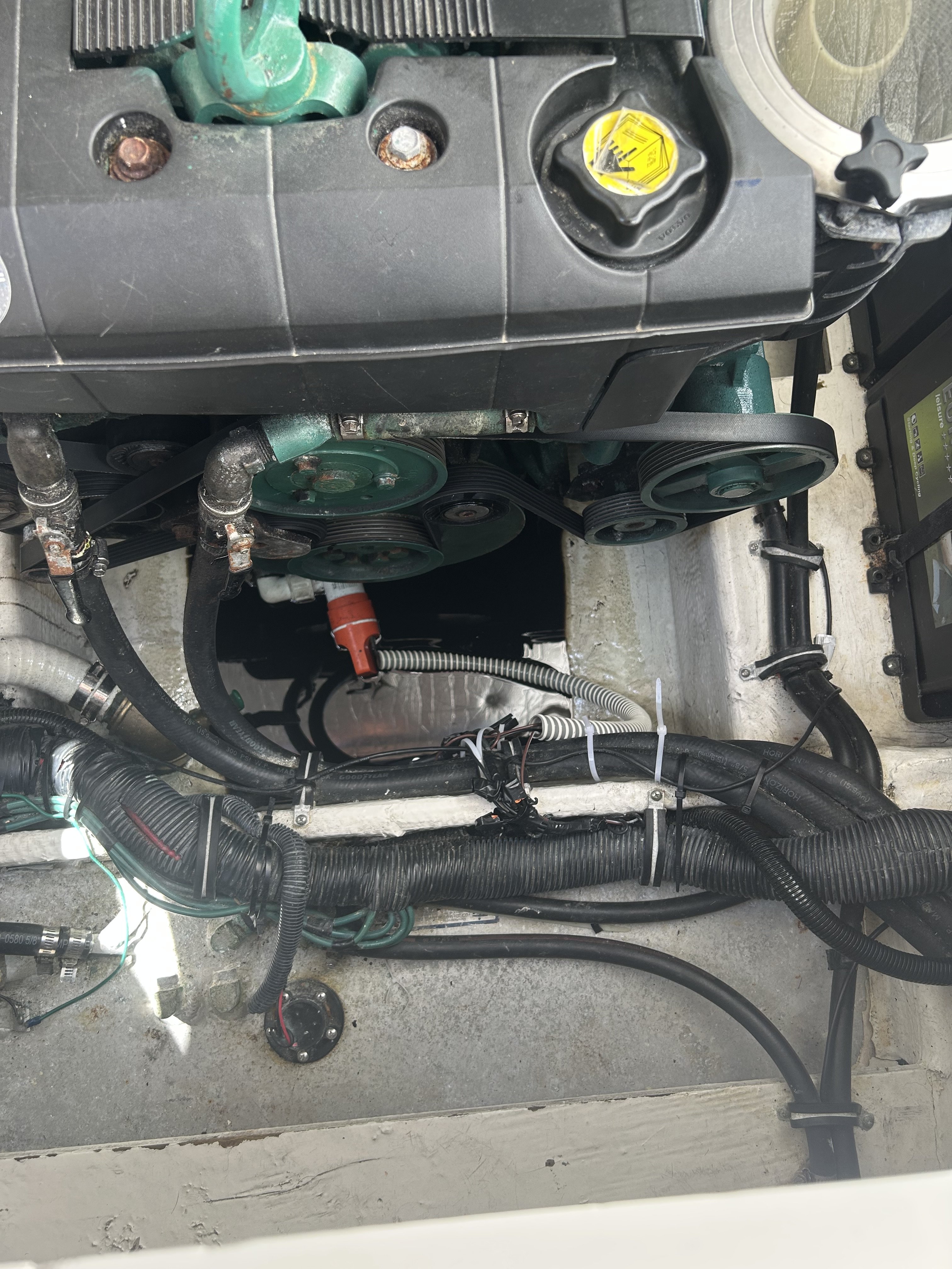

Hi all, I have had a low oil alarm on my Rinker 280EC 2007. Engine is a Volvo D4 260 with 510 hours. Engine had been running approximately 30mins and at an average speed of 12knots. Stopped to drop a fishing line and then went back into gear, as I did the warning alarm came on. On initial inspection under the hatch, I saw a large volume of oil in the bilge then got a tow home.
pumped out 6ltrs of oil in bilge and restarted the engine to see any obvious leaks but there were none. No marking of oil on the dipstick, but was fine on previous days pre flight check. Oil pressure is showing at 10kpa which I believe is  52ps.

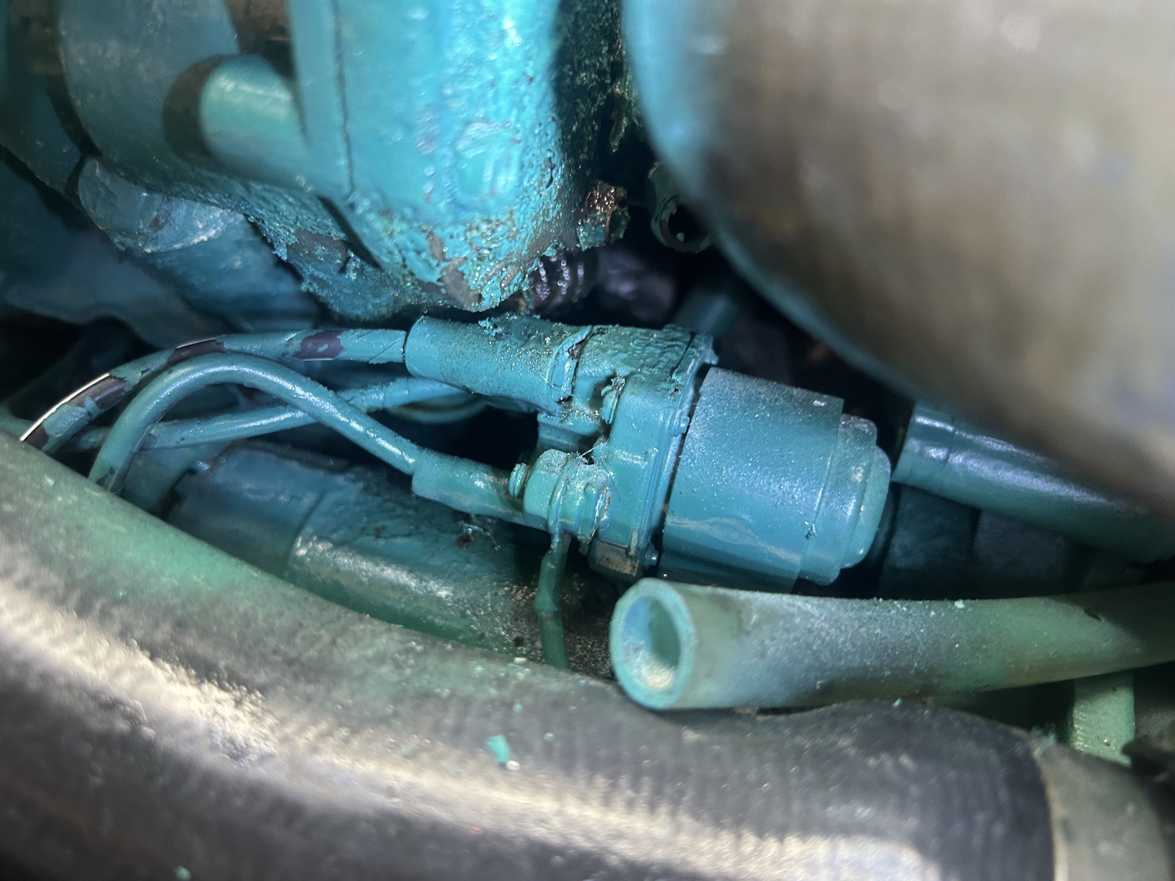

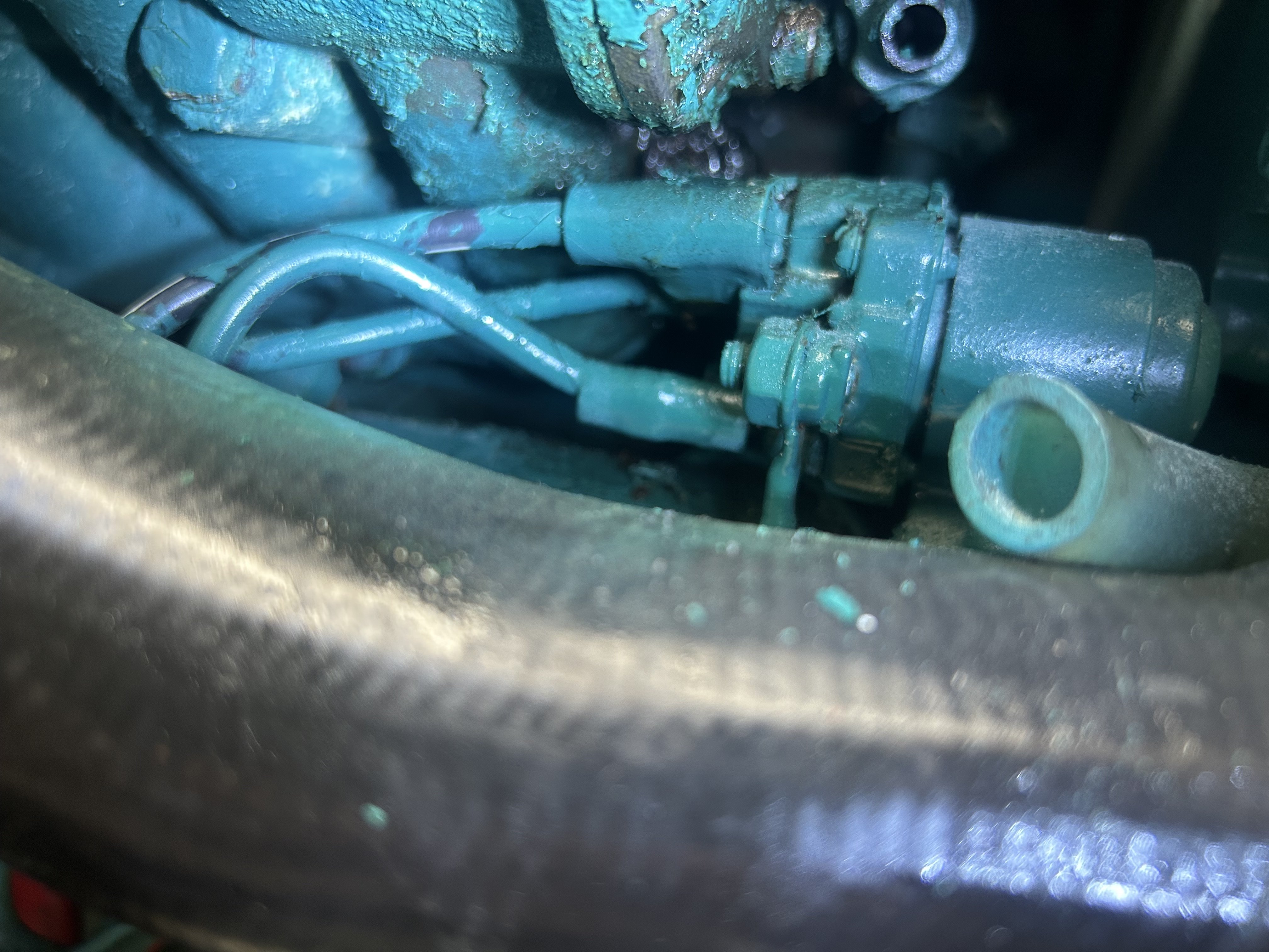

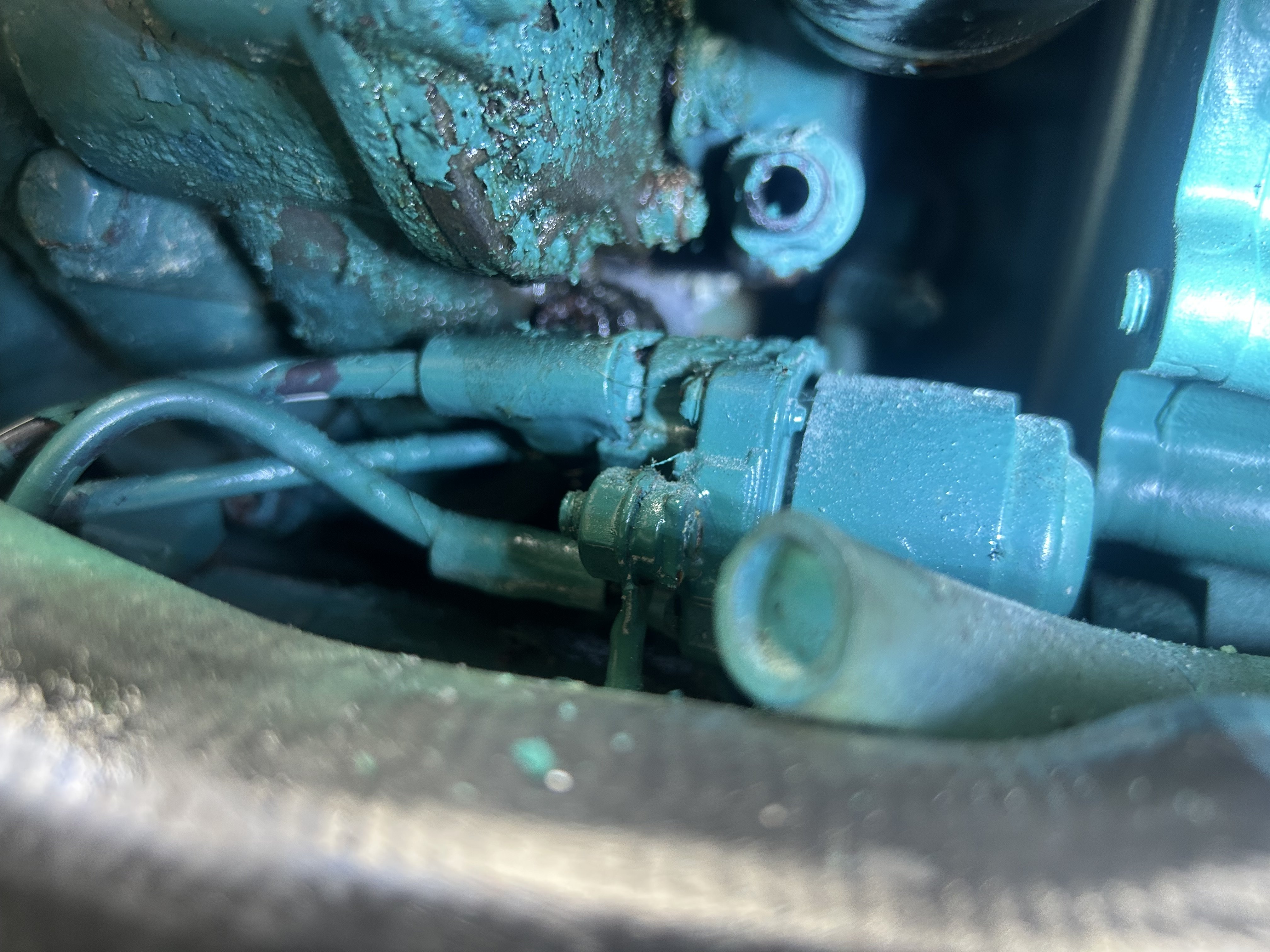

    Update from today was we started the fine up and witnessed oil coming from beneath the oil filters as you ave suggested @YYZRC . it’s difficult to s the exactly where from but I will try and attach a picture.

    Leak found, end plate of the LO housing below the oil filters . Many thanks for all replies

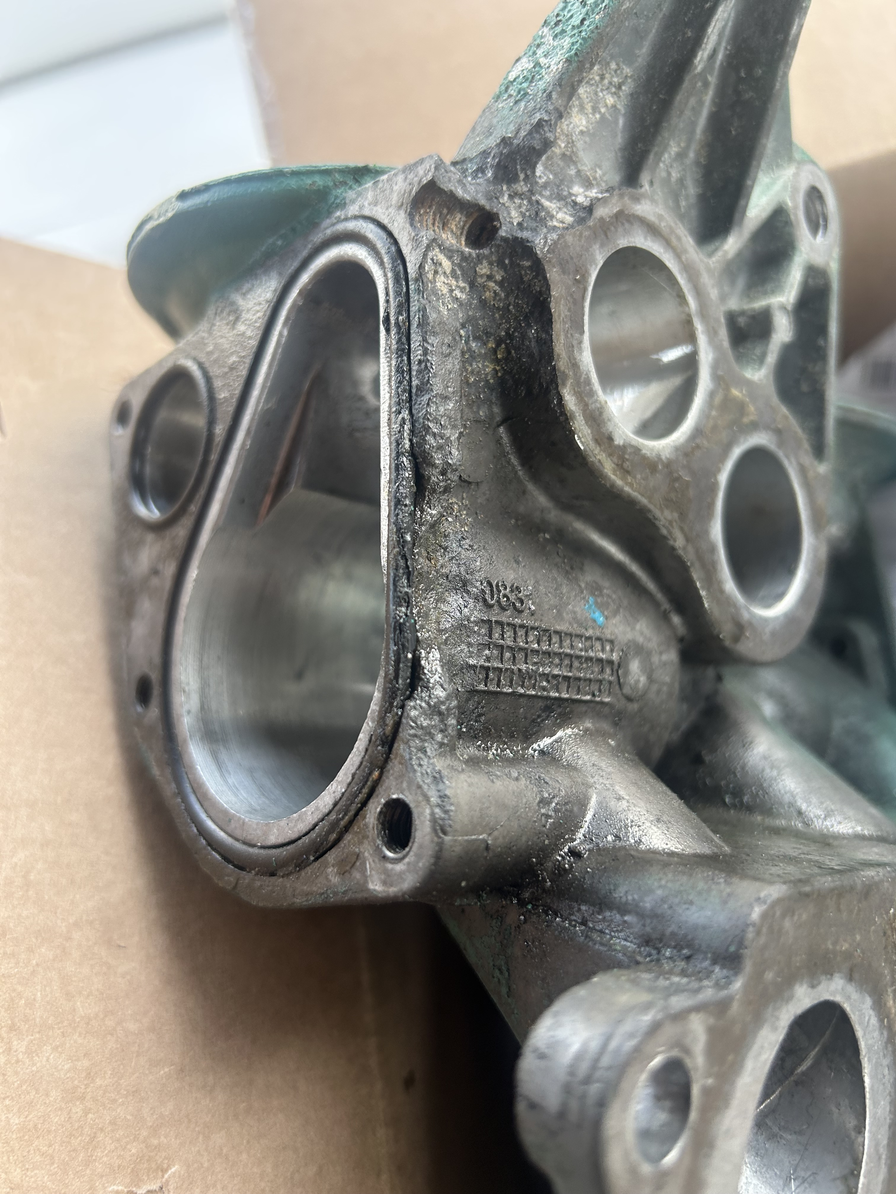

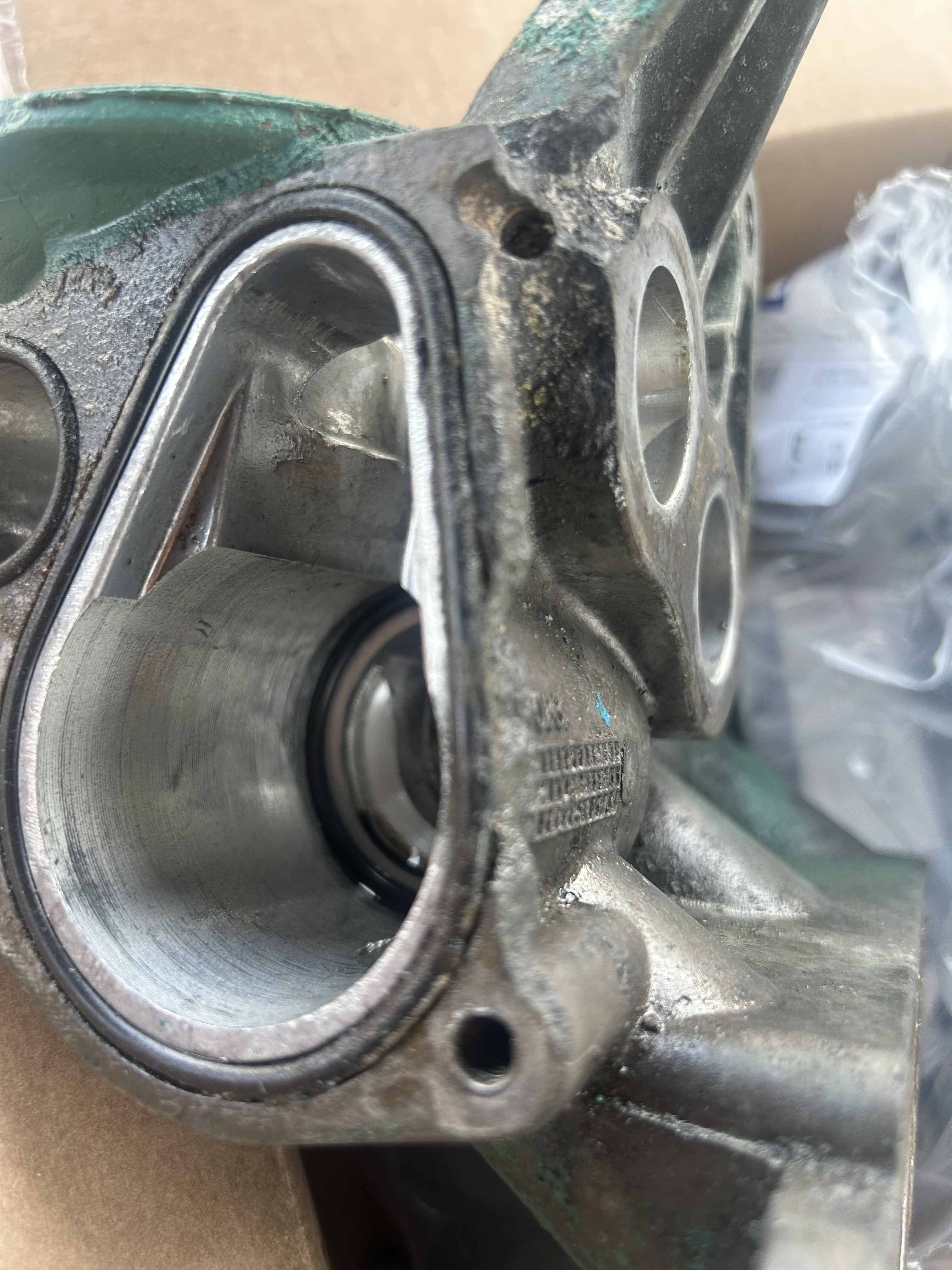

    Finalmpictures of dismantled faulty housing of the filters….. £2k 🙈 for parts only
  • YYZRCYYZRC Member Posts: 5,605 ✭✭✭✭✭
    Do you know what caused the damage?
  • aero3113aero3113 Member Posts: 10,106 ✭✭✭✭✭
    Looks like it corroded away in that area.
  • walkermarwalkermar Member Posts: 57 ✭✭
    Really not sure why it has corroded if I was honest so will try and investigate
  • PickleRickPickleRick Member Posts: 4,408 ✭✭✭✭✭
    Are there any raw water hoses or connection above it where salt water could be leaking down on it?
    edited June 5
    Hi @PickleRick , the intercooler sits above it but nothing too visible so may have been before and just carried on eroding over time
