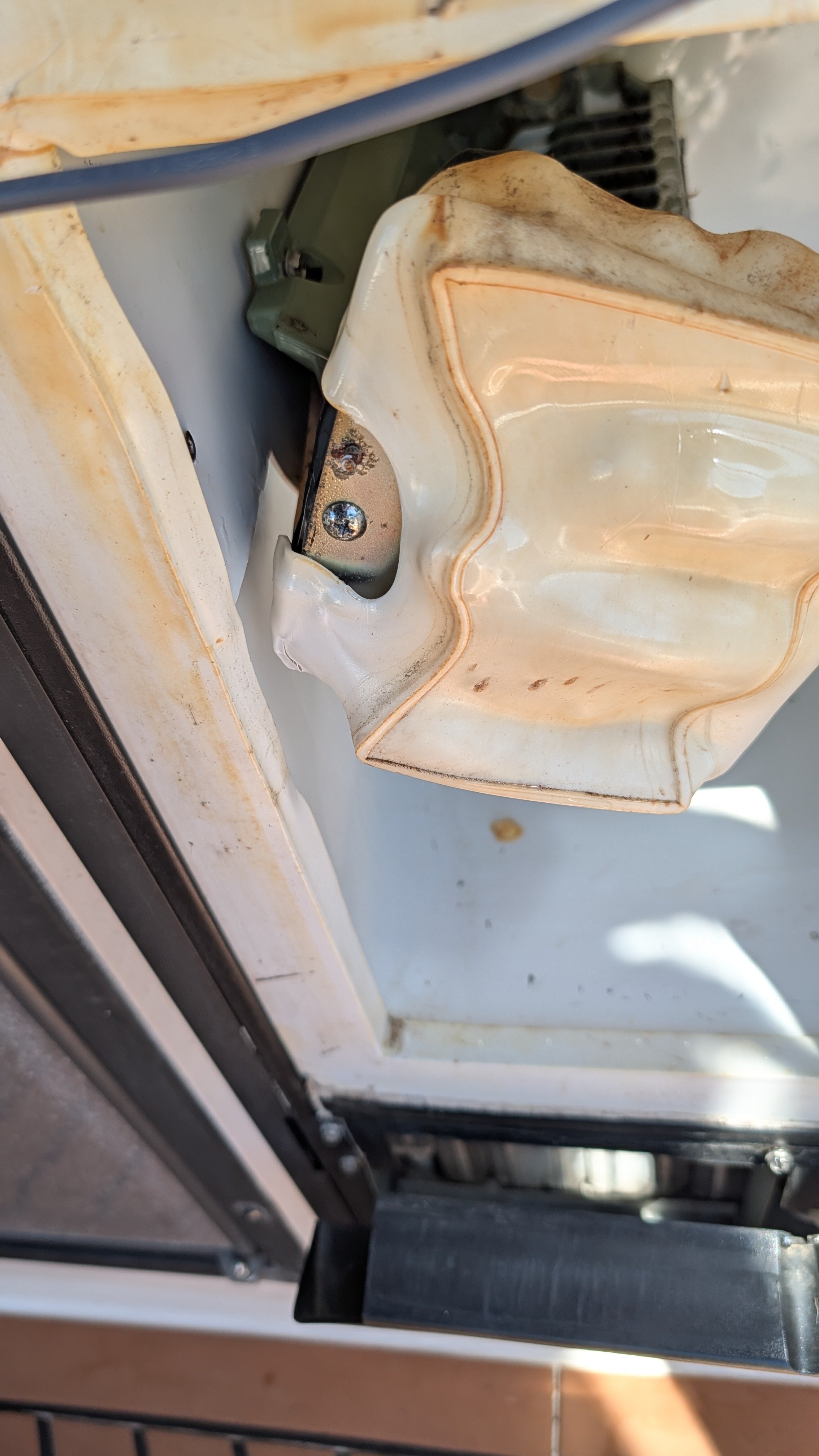

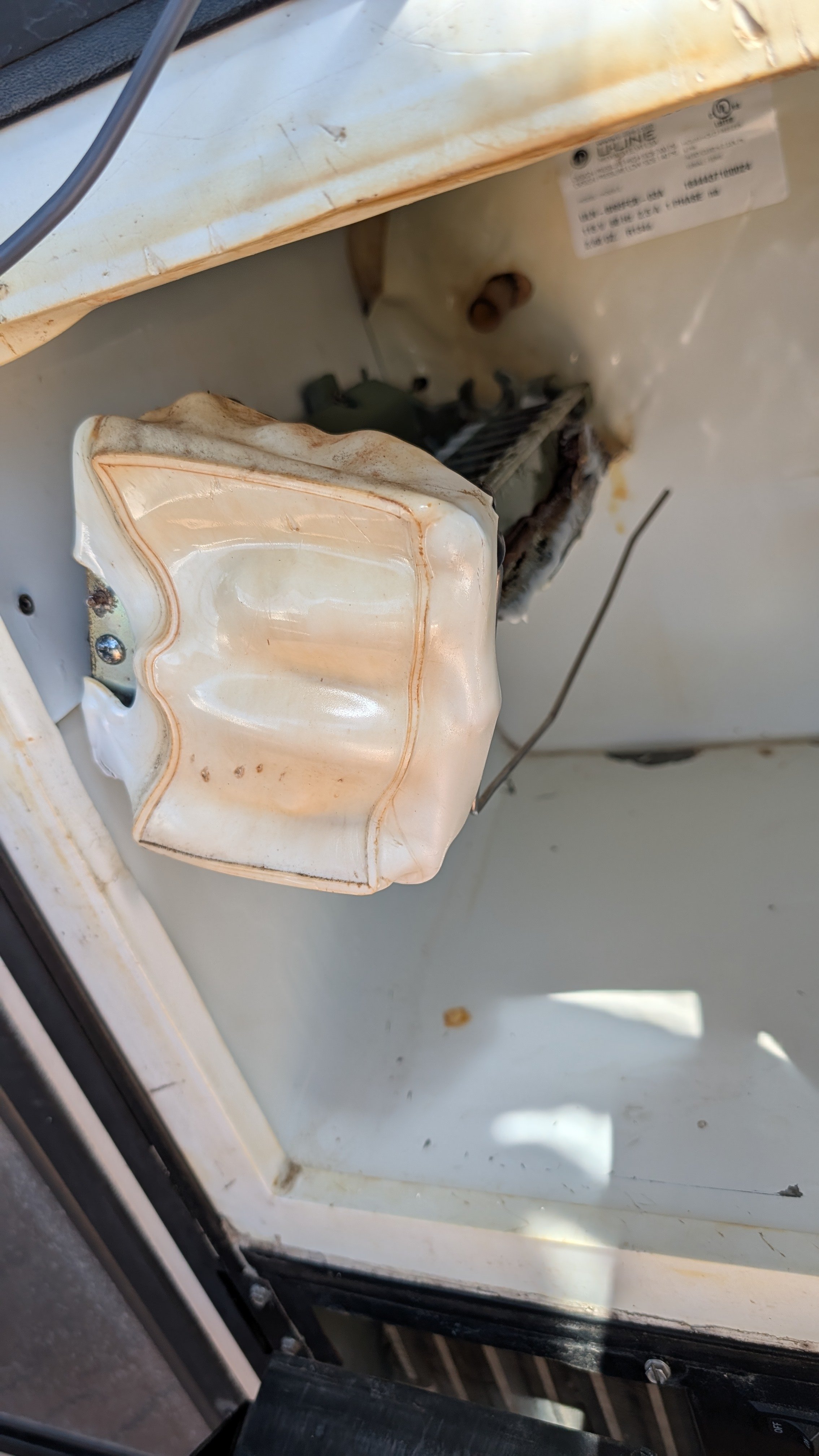

Can I just remove this uline icemaker from the freezer or is it part of the cooling loop?
  • Dream_InnDream_Inn Member, Moderator Posts: 7,919 mod
    You can remove the icemaker portion from the freezer.  Sure looks like that one melted.
  • SeaHareSeaHare Member Posts: 194 ✭✭✭
    Whoa, that one is toast.  Yes you can remove it but the cooling coil under it will remain. You can also replace the ice module with a generic one on amazon. They fit perfectly but will require a small wiring mod to the harness. I just did mine this weekend.
