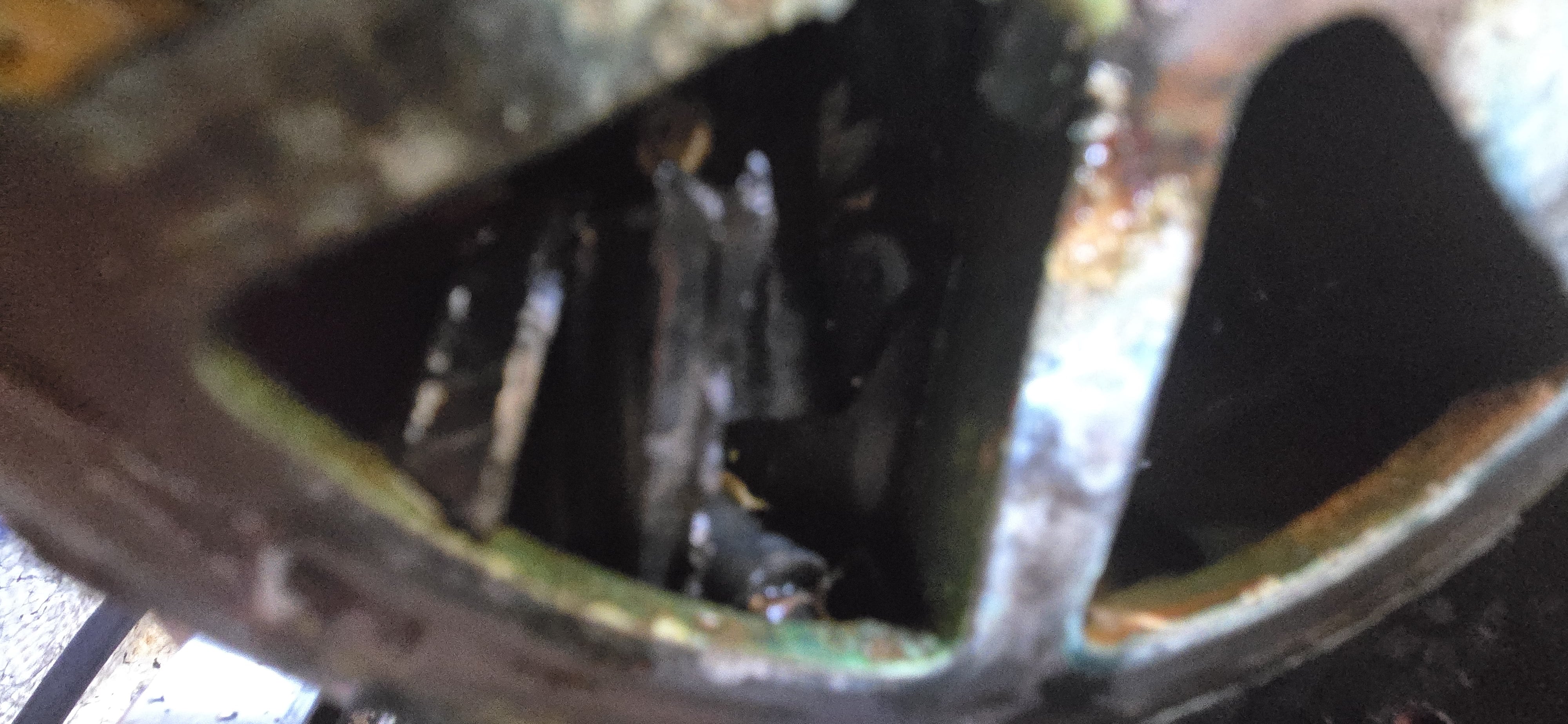

    Found a torn up impeller today, now to go on the hunt for the pieces.. Pulled the end caps on the heat exchanger and didn't see anything that looked bad.

    How long has it been since they were last changed?
  • rasburyrasbury Member Posts: 8,996 ✭✭✭✭✭
    Didn't you recently do a repower? They could not have looked great then?;l need to do my impeller also...

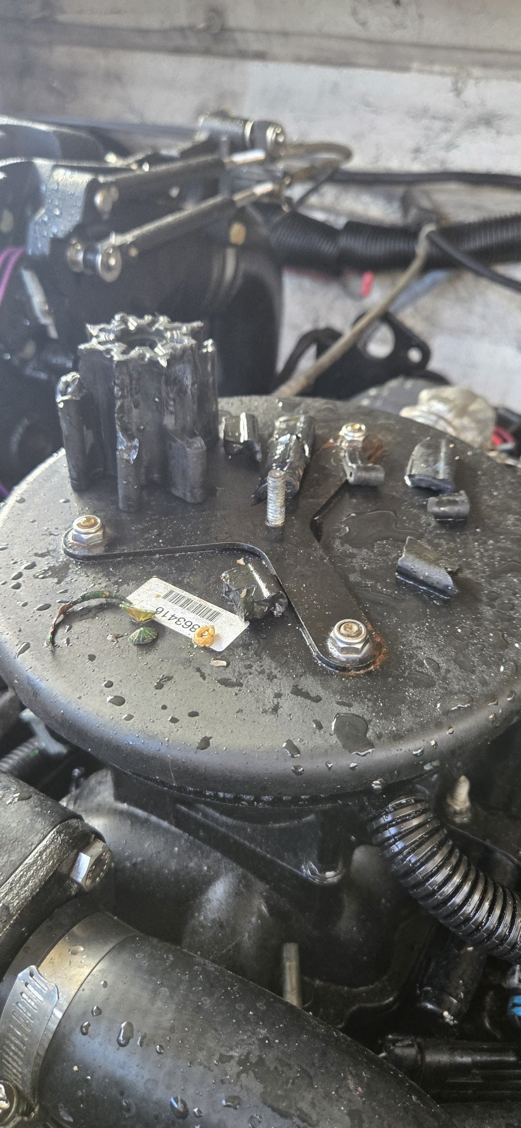

    Found where it all went... plus some shells...

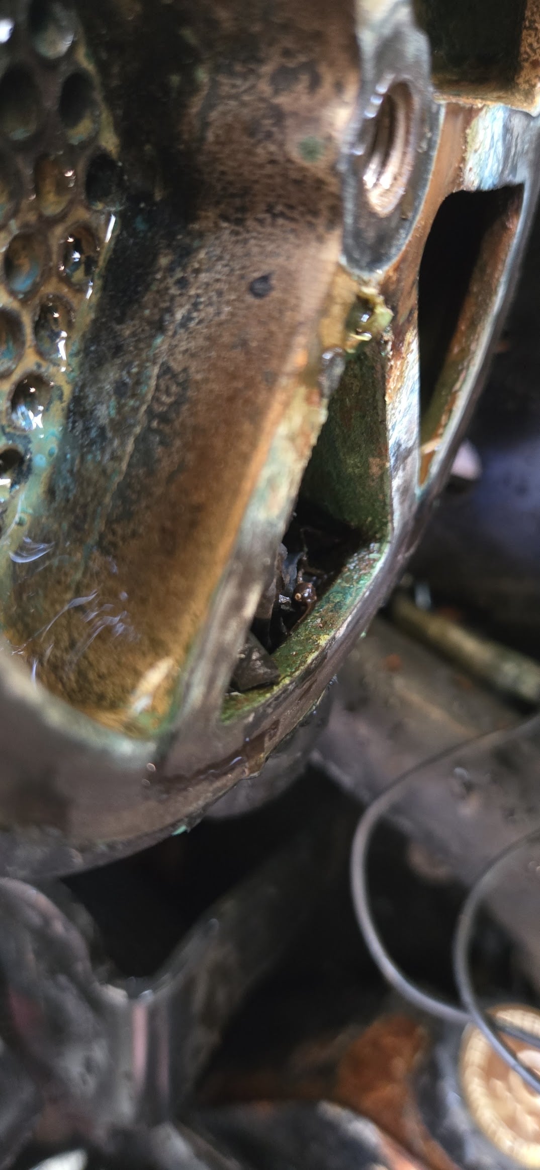

    and broke something else.. sure hope it can be swapped without removing the motor.

    Port lower, about to a.i. if this can be fixed without pulling the motor. If the answer is no, will be closing the computer for the day.

    Repower must be about 10 years ago at this point. Bellows have been changed every 3 years, sea water impeller must be 4 years old, that ones on me.

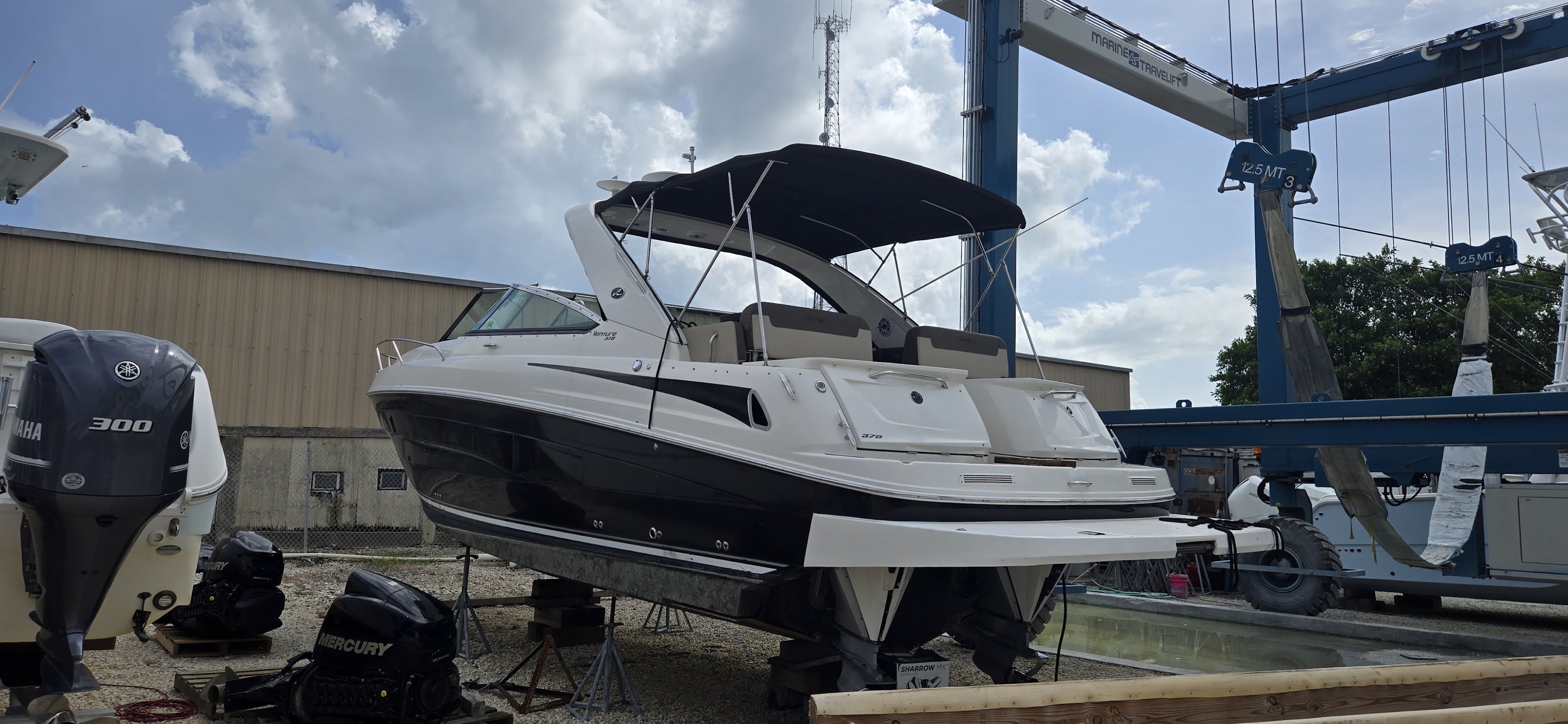

    As a tease my 'dream boat' (super rare as they only made it for 2 years) just happened to be at the yard a few over from where mine is.. couldn't help but go stare at it for a few seconds.

  • aero3113aero3113 Member Posts: 9,998 ✭✭✭✭✭
    Zoom in on the box between the outdrives. I wonder if he’s putting on the Sharrow props??

  • J3ffJ3ff Member Posts: 4,234 ✭✭✭✭✭
    they are on as of last weekend. Noticed that.
