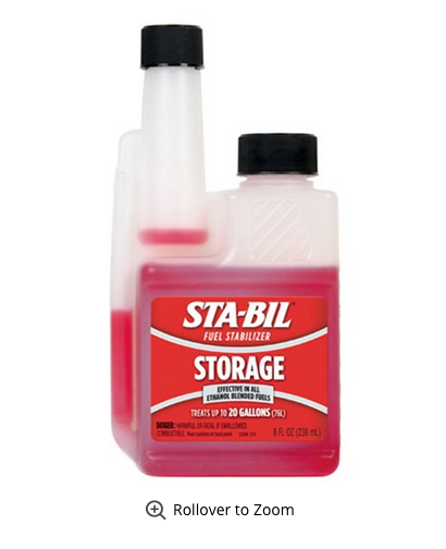

Yes I add Startron to the marina's "House" stabilizer. The marina, who winterizes adds a lubricant, I think it's made by Stabil. Three years ago I called Starbrite, makers of Startron and they said to go ahead and add their product too as there would be no chemical conflict. Like DI I add a lot of extra Startron in the winter and add the recommended amounts during the boating season. I think filling your tanks to 1/4 is great (I did too) and I'll fill them up with fresh non-ethanol in the Spring. Around here we get 91 non-ethanol but 89 is still great its the 10% ethanol that the marine parts hate.

Is this the lubricant? Or is this the same at Startron.
